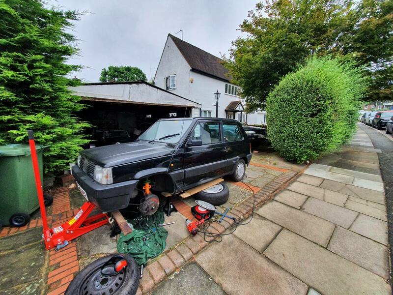

Decided to give up on the XM for now and try and address the driveshaft gaiter leak on the Panda (it holds in the gearbox oil so really needed doing before FoTU).  Despite being told it was a fairly easy task its still been a bit of a challenge thanks to it being the first major work I have done on the Panda, and my mechanical confidence being pretty low thanks to the XM debacle.  But once again @Grumblespeed went above and beyond to answer all the dumb questions I had . Thanks mate I really would have been stuck without you

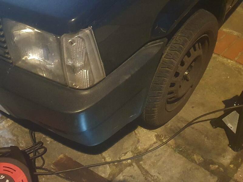

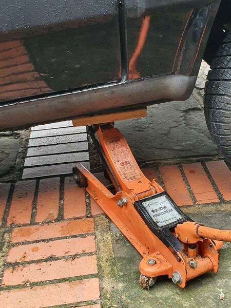

First problem was how to jack it up. I hate using sill jacking points especially on old Italian cars, and there are no subframes or nice suspension mounts that look like it would take an axle stands. ended up going belt and braces 20210724_110506.thumb.jpg.d222f0bf4136554ec65a237b946fae39.jpg20210724_110510.thumb.jpg.25338ee0ee761ec2d26684b1e22f238a.jpg20210724_110521.thumb.jpg.3915428aaa241541a0bbda05fd72188d.jpg

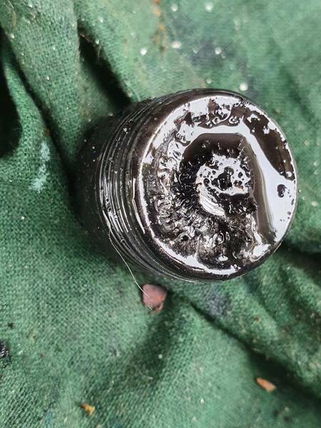

Gearbox oil drained. Is there a worse smell in automotive tinkering? I found a receipt with the car for gearbox from 2019 so I think @spartacus must have changed it so it wasn't as grim as it could have been.  A fair bit of  swarf on the metallic plug 😳

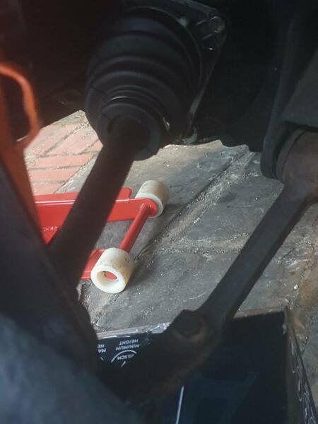

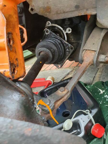

despite thinking I could get the shaft out with only the hubnut and carrier to strut bolts I just couldn't find an angle to get the shaft out, and weary of damaging something grumblespeed suggested a few more links to undo

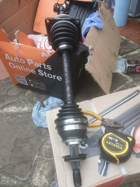

Shaft out and gaiter off.  Checked the nice new gaiter grumblespeed did for the MOT and all looks good

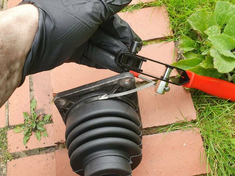

the large metal tie that came with the boot isnt long enough to go into my tightening tool so had to use a plastic zip tie so will have to keep an eye on it
the bearing which holds the oil in the small end seems ok which is a relief that it doesn't have to be changed

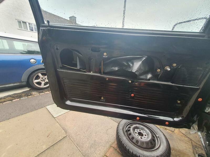

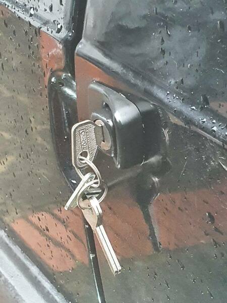

Next up was trying to sort out the locks. There was only one key for the doors which didn't fit the boot or passenger door, so decided to replace all three with a brand new set. Door cards came off in matter of minutes.20210725_175609.thumb.jpg.8153acc5f6c8110b6d4c44ab82d231ad.jpg
the lock and push button is held in with this spring clip which you have to reach into the dark far corner of the door to reach (after disconnecting various plastic cup and ball joints without breaking the 30 year old plastic)
The clip is supposed to pull off by hand but drivers door was stiff, so tried to prise off with a screwdriver and it pinged off into the inside of the door.  After 40 minutes scrabbling around trying to find it (you can't see into bottom of door and it was full of glass from a previous broken window) all I had successfully done was also drop my phone a screwdriver and my magnet on a stick inside the door too.   To make matters worse the door was not able to close as all the mechanism was disconnected and this happened
after the rain I remembered I had bought a video endoscope in Maplin closing down sale so with that and a work light to illuminate inside the door I managed to confirm that there was in fact only broken glass in the bottom of the door.   Hmmm.  By process of elimination I realised the only place it could be was the one 10cm area of the door cross brace which had too small a gap for it to fall down.  Managed to confirm and flick it up enough to grab it by using the metal tie wrap I couldn't use for the gaitor (see previous post😃).  Got it, then dropped it again but this time inside the door so could fish it out with my now retrieved magnet
Done!!! Passenger door and boot were done in 15 minutes ! Easy when you know how.

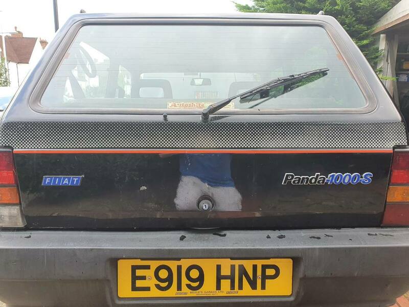

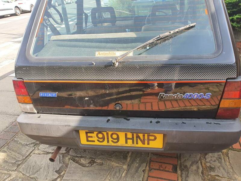

Final job before the test drive.... Car was missing a few badges on the back
They are missing no more

finishing touches
2 minutes ago, wesacosa said:
haha cheers mate!  Very unfortunate angle 😂😂
You're most welcome👍

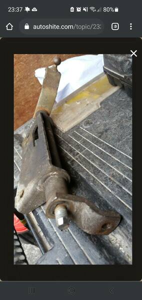

Sloppy linkage will likely be deteriorated linkage bushes. You need to change them before they go or you`ll have a sudden loss of gear selection, which can be temporarily solved with a luggage elastic hooked onto the OS jacking point (always keep a couple in the boot), but will inevitably happen in rain, at night on a muddy country lane, or on a motorway..
13 minutes ago, uk_senator said:
There is huge debate, for the record I have used cheap 20/50 engine oil in the past, & last time I rebuilt my gearbox (on grey 1990 Uno Mk2, same C501 box as yours)  I used non-EP Comma 75/90 . That was about 10 years ago & its been fine (although I noticed yesterday it seems to be leaking more gearbox oil than usual from the OS driveshaft gaiter, so that needs doing again).
cheers. The gearshift isn't sloppy as such (see page 2 of this thread on what Giles did to improve it).  It just seemed a bit stiff to get into first a few times.  perhaps it was just because its cold. I only drove maybe 1 mile
A replacement one of these came with the car (although its ever so slightly different looking)
Yep, just looked back at page 2, the selector bar can seize with lack of use as well, eventually leading to the rounding off problem Giles sorted with the drill bit bit.... They can be stripped & re-greased, and if your feeling adventurous, you can drill & tap a hole in the middle & stick a grease nipple in to prevent the seizing issue. They changed them a bit over time, but they all fit on the same studs & do the same thing, so not to worry.
Have a look at those change rod bushes though if you haven't already, as new ones also help selection, & will prevent the gear selector loss I mentioned. They were like a rubbery nylon material it was new, & deteriorate with age, crack & eventually fall out, theres every chance yours are original & on their last legs.
New ones are stiffer nylon & are a bit of an arse to fit, as you have to push the rigid bushes into the hole in the rods, the bush is a very tight fit, & the nylon is rigid enough to make it difficult to get in, but not quite rigid enough to prevent diagonal distortion when you`re trying to push it through. much easier to do completely off the car in a vice, squarely if you can. KY jelly helps (matron), both getting the bush in & popping it onto the ball when remounting it under the car, with extendable/plumbers pliers or mole grips.

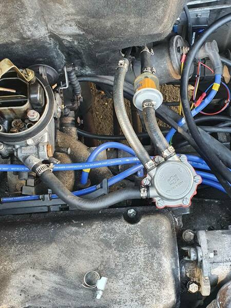

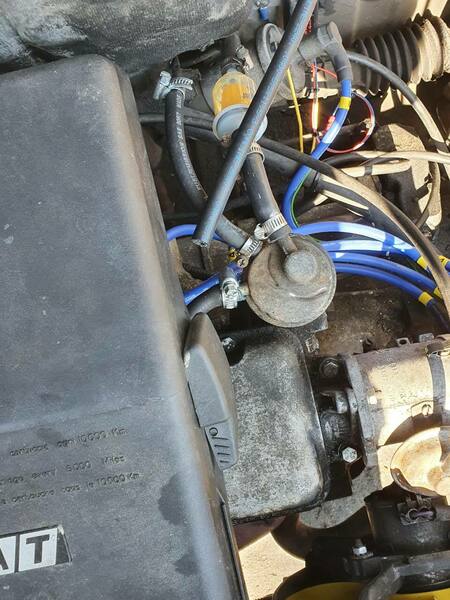

@spartacus had complained about a bit of a flat spot in the acceleration.  I had noted that under very light acceleration it would cough and sputter and not pull very cleanly. Was ok when cold and running with choke but when warm it was pretty bad.   Given that it had new plugs, leads and electronic ignition before I got it, plus a carb clean and rebuild, new fuel filter and the dizzy vac advance checked ,  @Grumblespeedhad suggested the only thing left to try was the fuel pump.  I had also noted a fuel smell last time I drove it20210924_114631.thumb.jpg.a00e2b529bf8221402c44b690ab69da0.jpg
looks pretty old.   Mechanism was pretty oil when I took it off and the follower seemed worn
New one on, along with all new ethanol resistant pipes and new hose clips.  First impressions after a shot drive around the block is the hesitation seems to be gone. However I will need to give it a good spin once I can get through the panic buyers blocking all the petrol stations.

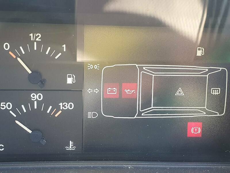

whilst I was there I swapped out the oil pressure sender so now my oil light works :)

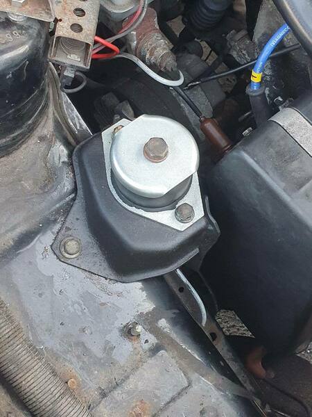

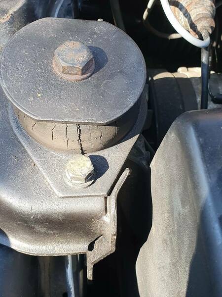

next job on the list is engine and gearbox mounts. There is a lot of movement in the powertrian on power take up/lift off and the rubbers have definitely seen better days

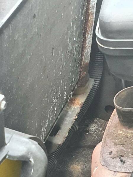

I also found a bit of crispyness in one of the rear sills/suspension mount points. It got through MOT in May so hoping its just a few flakey bits but needs investigation before it becomes an issue.  Also have to get the underseal out as the old stuff has lifted around the jacking point and is letting surface rust in.....

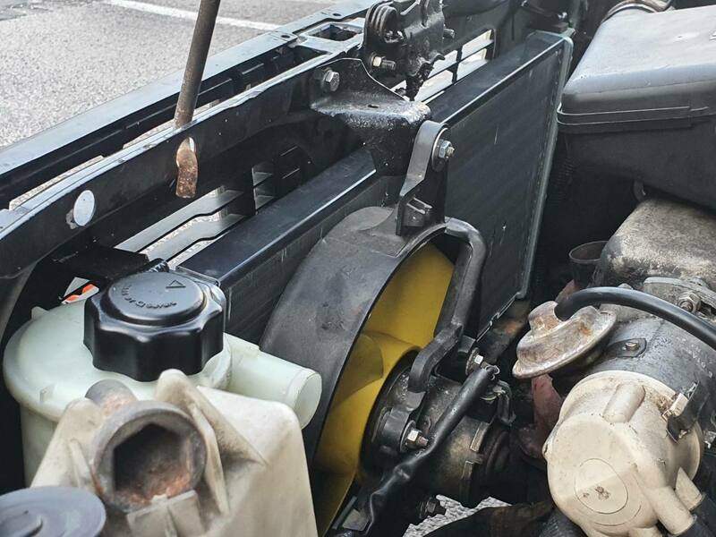

A little bit more today.. I thought the radiator showing signs of weeping so I got another.
Supposedly a Behr one from eBay but the fins crease just by looking at it.  Hopefully it will be ok. My hope was I might get away with reusing the coolant as I thought I remembered something from earlier in the thread about new coolant.   Aaaahhhhhhhhhhhhhhhh
the black is from the bucket. The brown is from the car 😂
Putting back together on hold until I can wheel it outside the house and get the hose pipe on it
managed to swap one of the engine mounts whilst I was at it20210926_173950.thumb.jpg.657be3ecf7e6125662bfa0181f77efac.jpg

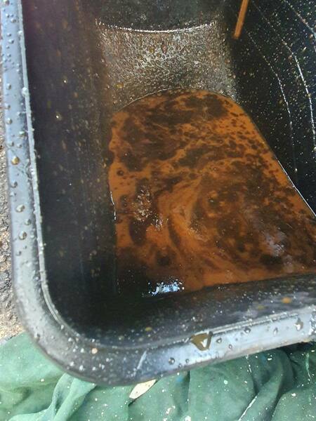

some more progress on the Panda today.  given how grim the coolant was I decided it needed a good flush before putting the new stuff in. Sadly this meant disturbing the thermostat which was reasonably new according to the receipts from the work @spartacushad done. Being a cheapskate  responsible citizen I bought some gasket paper and cut a new gasket so I could keep the original stat once I had hosed out the block. dab of Hylomar blue each side for good measure so fingers crossed it holds.  Its a 5.2L capacity but after I have finished bleeding it through I reckon I will have got about 4 liters back in, perhaps a tad more.
Seems to run up to temperature ok and heater works well so hoping a few more runs will have it properly bled

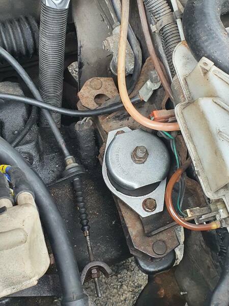

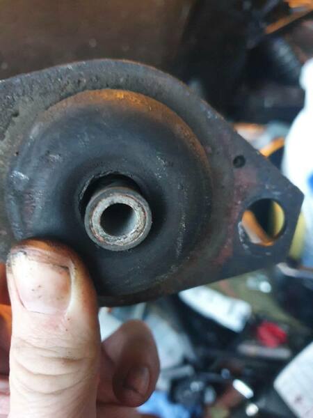

After the last update changing the RHS mount I have now done the LHS
and the gearbox end
this probably explains the huge powertrian movement !
Its noticeably different with all 3 mounts done. Before the engine could be rocked with just light finger pressure. now its faily solid and the shunt on power take up/lift off is gone.
