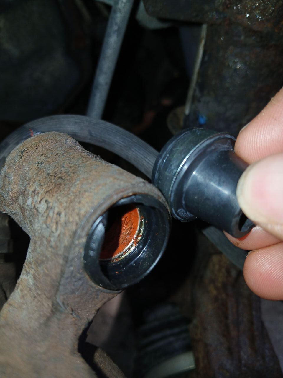

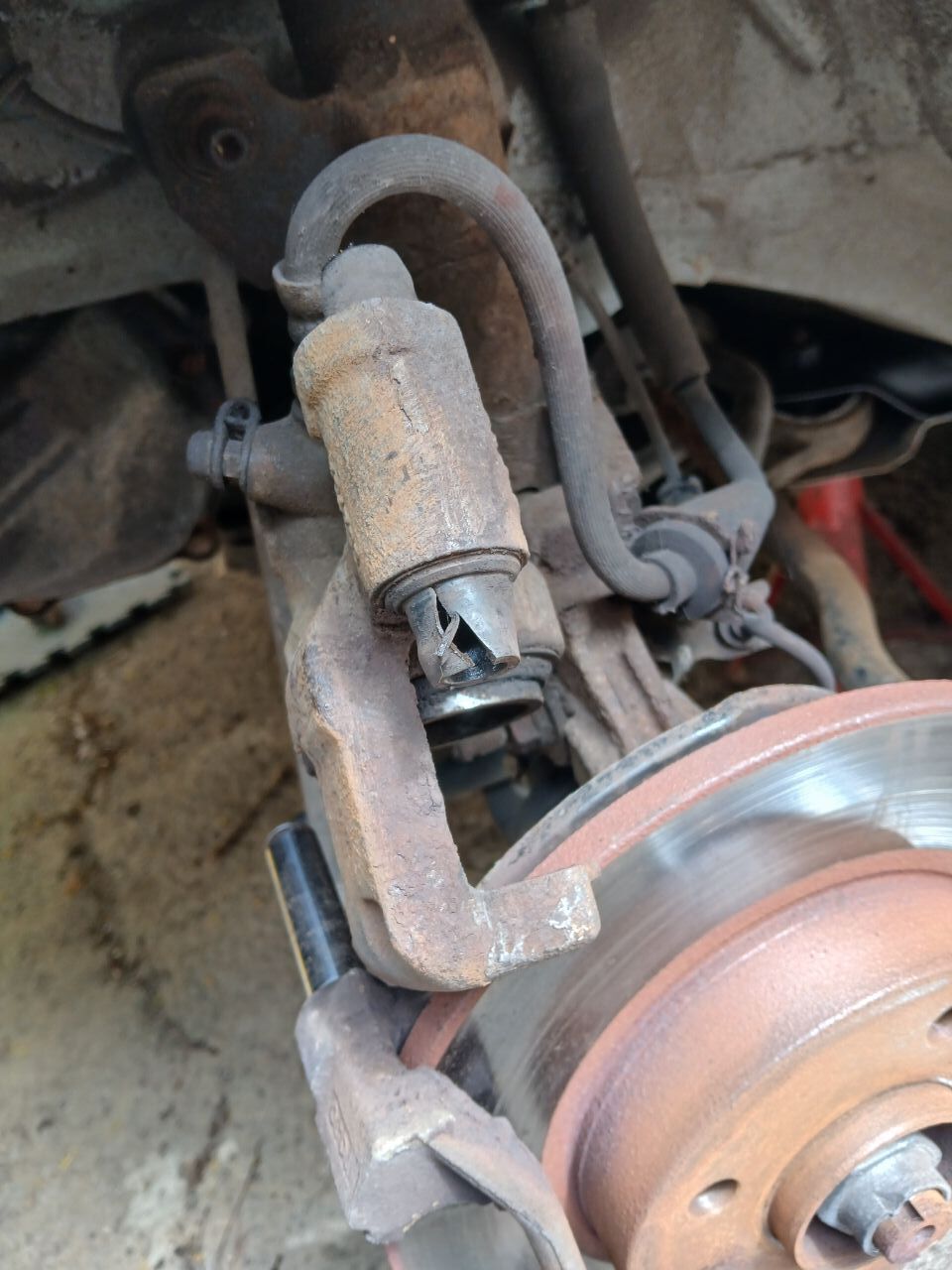

Front brakes. Can I buy new rubber covers for the caliper sliders ?
Just need new rubber covers, metal sliders are in great shape.

Go on to Autodoc and look for ABS 63604
£4.29 per side for a complete rebuild kit of rubber parts.
Don't buy from eBay, the prices are a multiple of that.

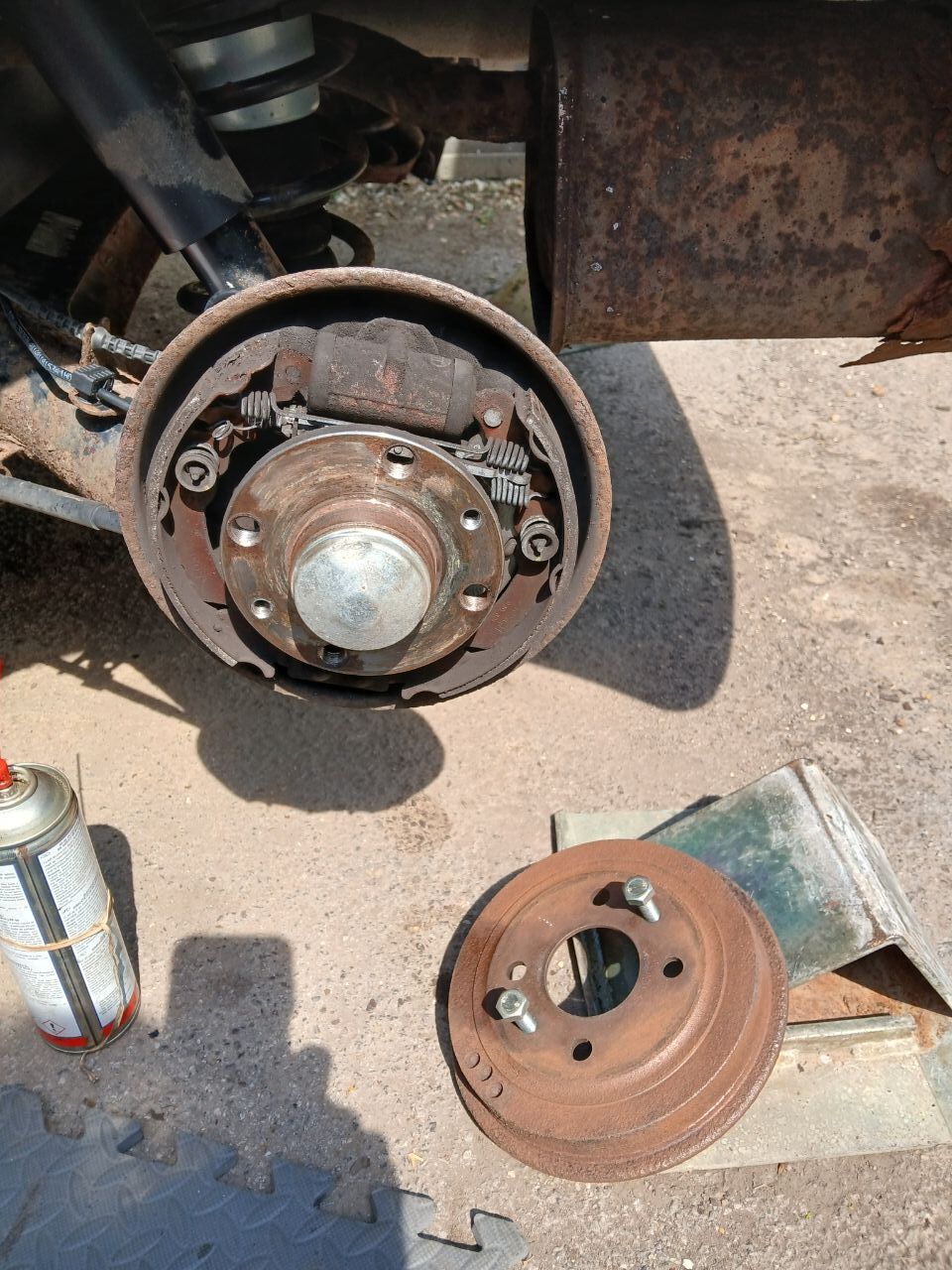

Rear drum brakes, was impossible to remove rear drums until i read about 2 m8 bolts used to force them off. Worked a treat. I am pretty sure this is 1st time they have ever been off ( low mileage 40k panda).
All looks fine inside, just a good clean up and whilst there take off hub and grease the bearings.
Yes yes I have seen the exhaust !  Not blowing so stays for now but bought car knowing to budget for it.
Even the tyres are good, kind of how i knew i would buy it after 5 min walk around. Front 2 are 2 year old continental. Rears are perfectly OK 4 year old budgets..

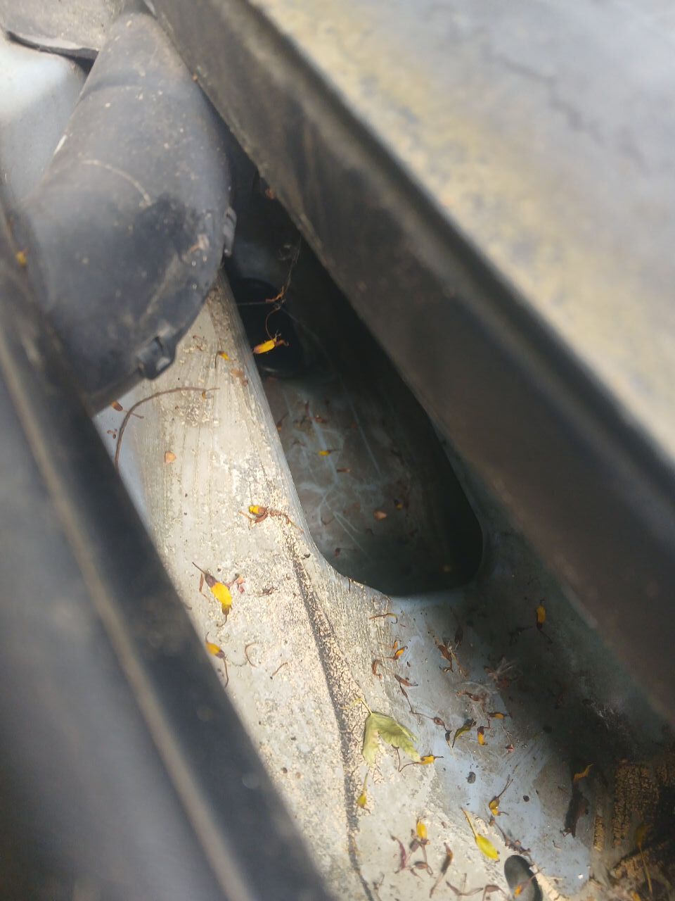

If you have the front wheels off, behind the shock you can see the chassis leg. Put your hand in scoop out the crap, it's usually full of muck and stones, worth flushing this out with a bit of water if you can after.
Can confirm this hidden area full of muck, easy to clean out regularly.
Also engine bay/ windscreen scuttle area fills with leaves etc and blocks  2 drain plugs, easy to clean and pull off plastic gromit / drain holes from engine side  to clear.

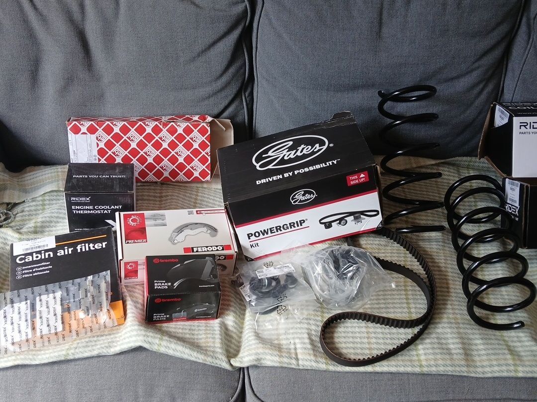

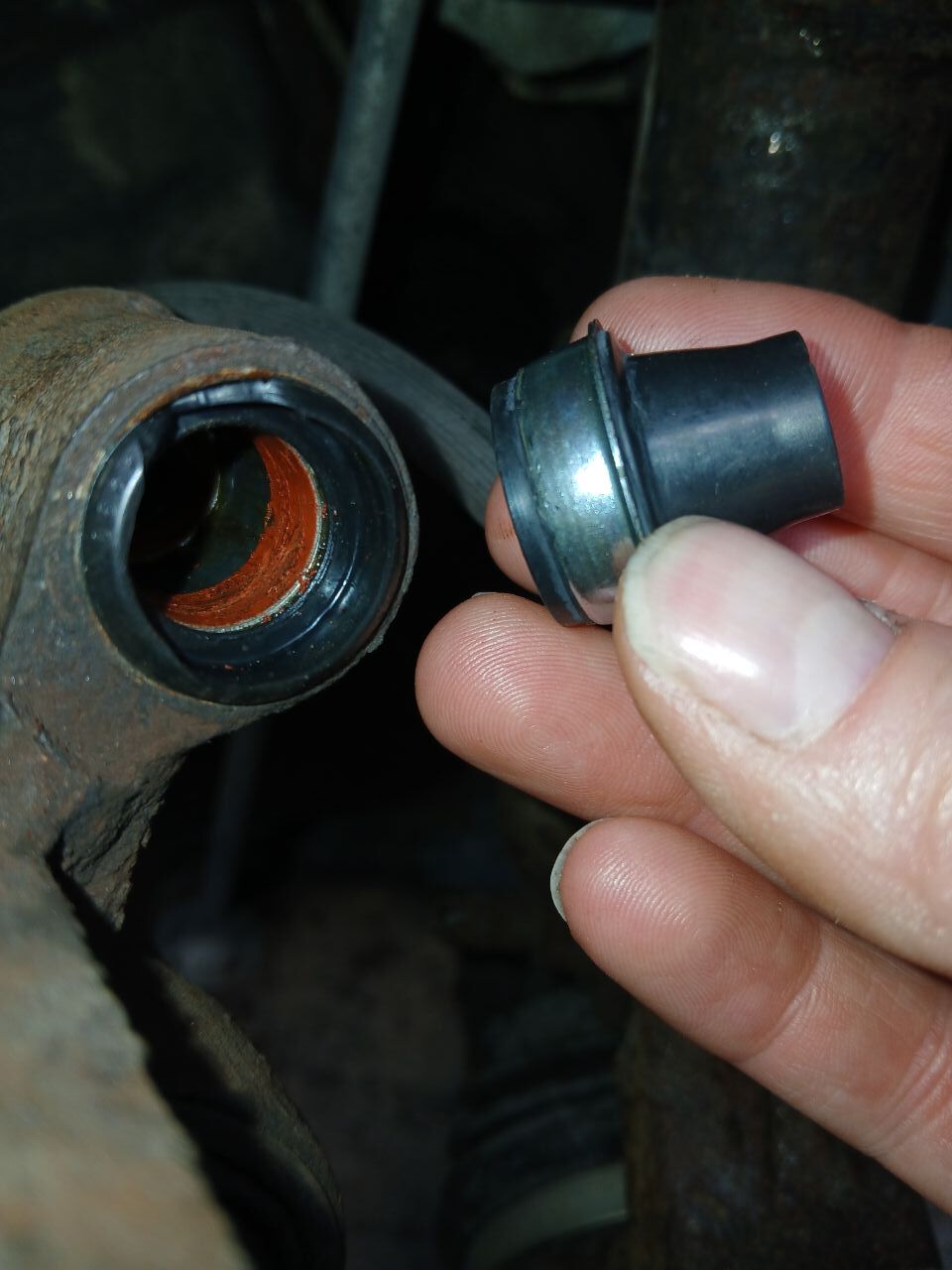

Autodoc order arrived. 8 days from order to delivery. Not bad.
Ohhh
1 st problem

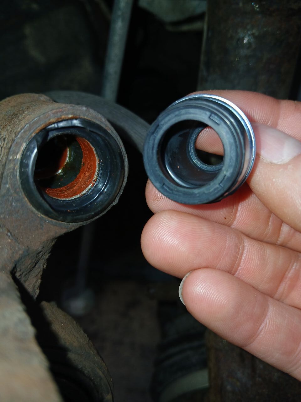

Caliper rubber slider rebuild ??
This is not simple rubber insert. There seems to be an interference fit metal sleeve inside trapping rubber seal in.
I guess these need drifting out and then how do I put it all back together with new rubber in the way ?
Beginning to think new pair of calipers at £60 would be easier !
