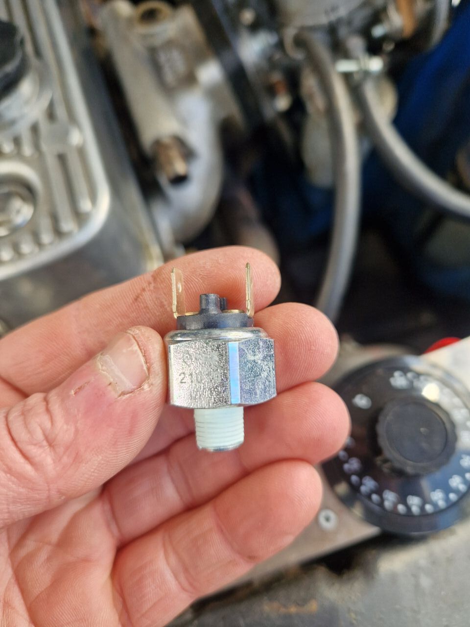

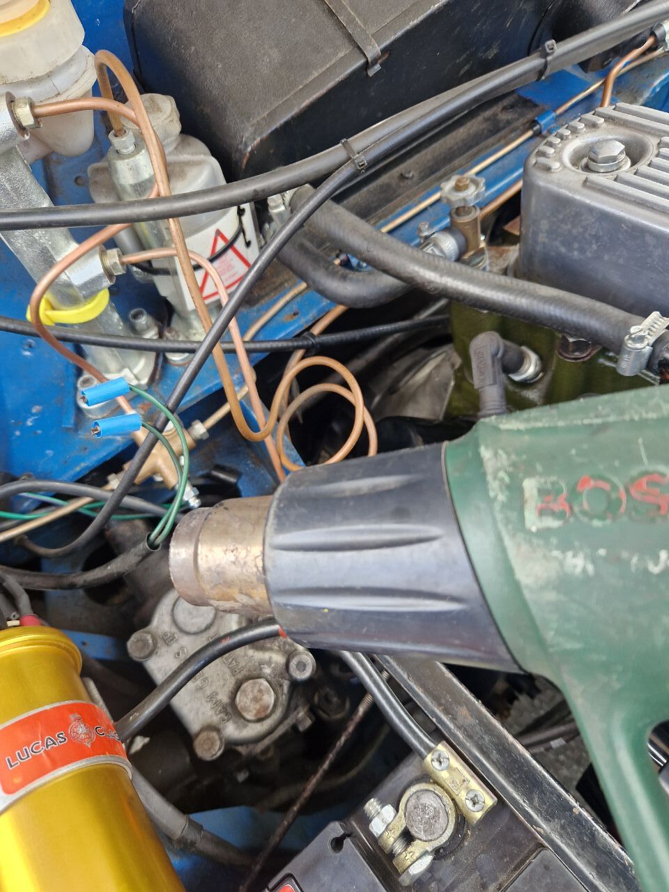

I had an MOT booked for weds. Got one of the lads to run me down home to pick it up, got it out, no brake lights. Shorted accross the switch, lights came on. Cancelled MOT 🙄.
Now thats the second pressure switch in 3 years. But what can you do, parts are shit now. Derek at Farina Club spares sent 2 to my house for 20 quid delivered. One for the car one for the glove box. Cant whack that really. Superb owners club all in all.
Changed it this morning.
20260419_124158.jpg.76a933b148d4614b2a6183a7f36489b2.jpgBonnet up
20260419_124221.jpg.467530bead5528445d747edef48e7882.jpgBit of heat shrink to tidy up
20260419_124953.jpg.1029663846995493c01052d8f8ddc723.jpgNew switch (little bit of tape to help the taper)
20260419_131247.jpg.9d70aff110b64e9d8bd5e933ec2d769b.jpgAll done
20260419_131257.jpg.b63d29cca7dd3f7be04d43df9bfca0fd.jpgLights come on 👍
Then a quick run out with my assistant (our youngest). She helped me bleed up after then came with me and made a bit of a video. I really am crap at this. Certainly no Tiff Needel. I dont think my accent and talking shite helps either. Anyhow, see what you think. Dont think @Twin-Cam needs to worry too much 🤣

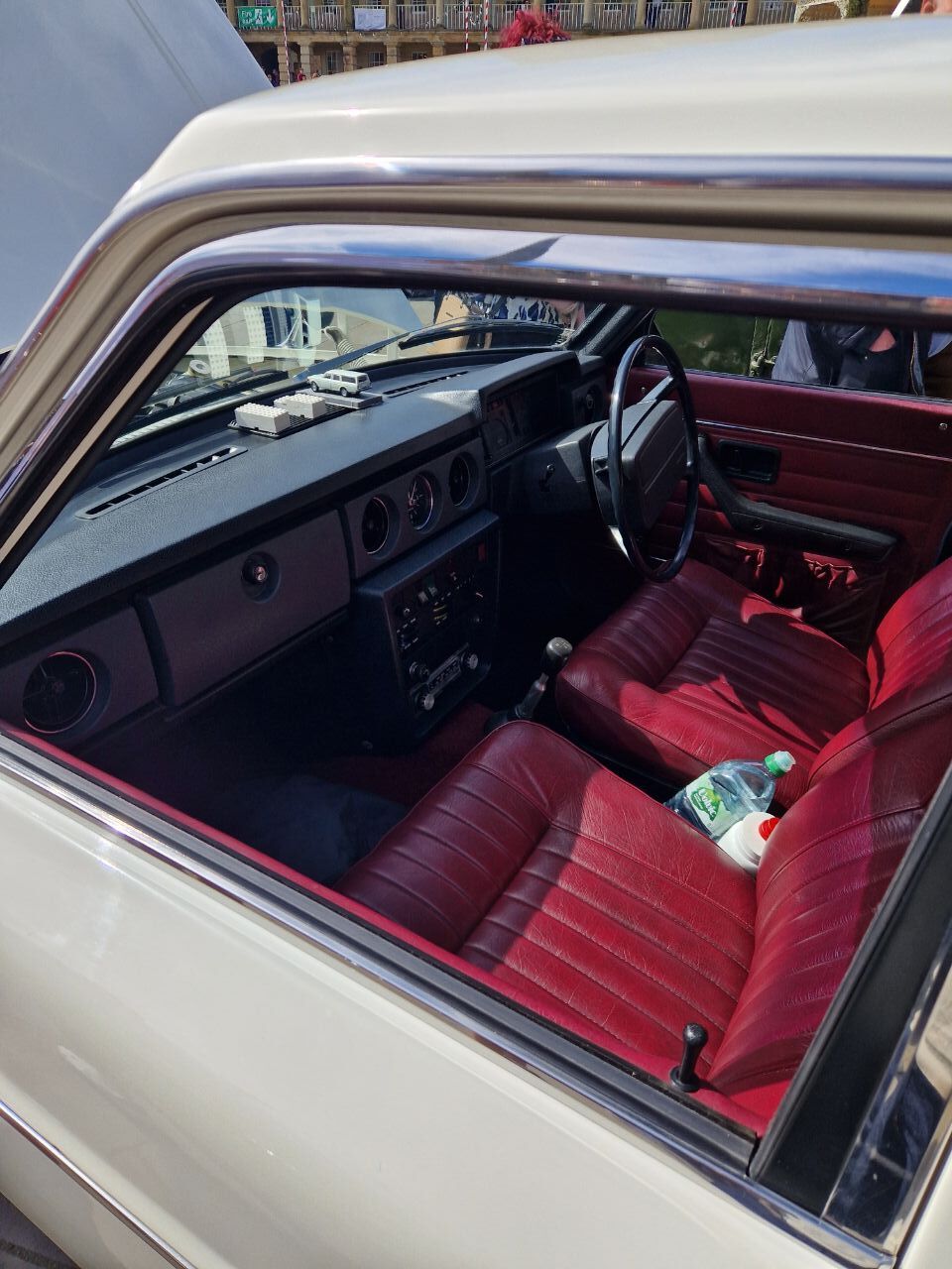

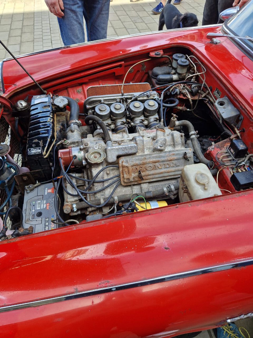

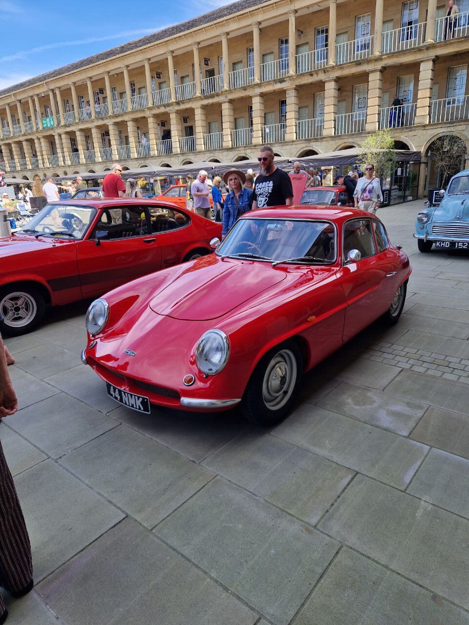

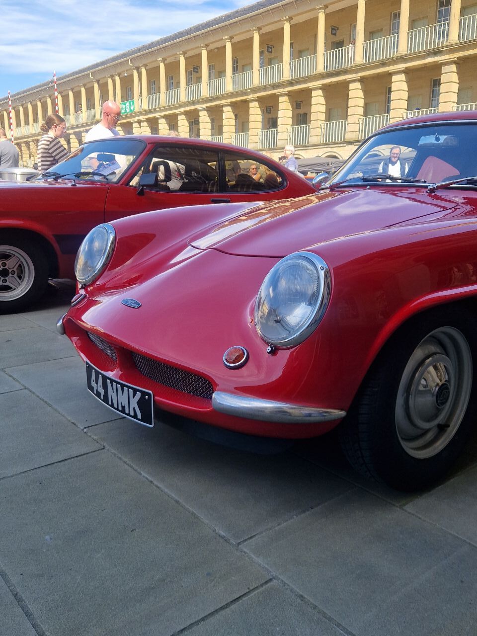

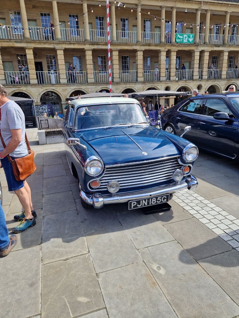

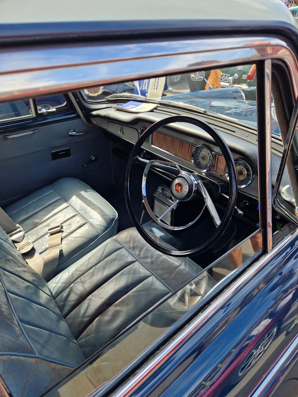

20260425_120603.jpg.8d064ebac021c17798745883cbce6ffc.jpgFirst car i met @captain_70s. Stunning.
20260425_120844.jpg.c9b66e84dec543bc343648aadd9e3508.jpg20260425_120852.jpg.90af6d75ff6285c795e7b60621ab20ad.jpg20260425_121000.jpg.fb6f767757d6644397ed52596e8ff1c7.jpg20260425_120955.jpg.f4838afc9558b8ec1a691f4aff98f522.jpgLove these and still want one. 1800 twin carb and od box in mine please.
20260425_121057.jpg.8618c12727c5aad836b5fbd914981c02.jpg20260425_121112.jpg.b344cc658f97ac19e16f562d20e9a01d.jpg

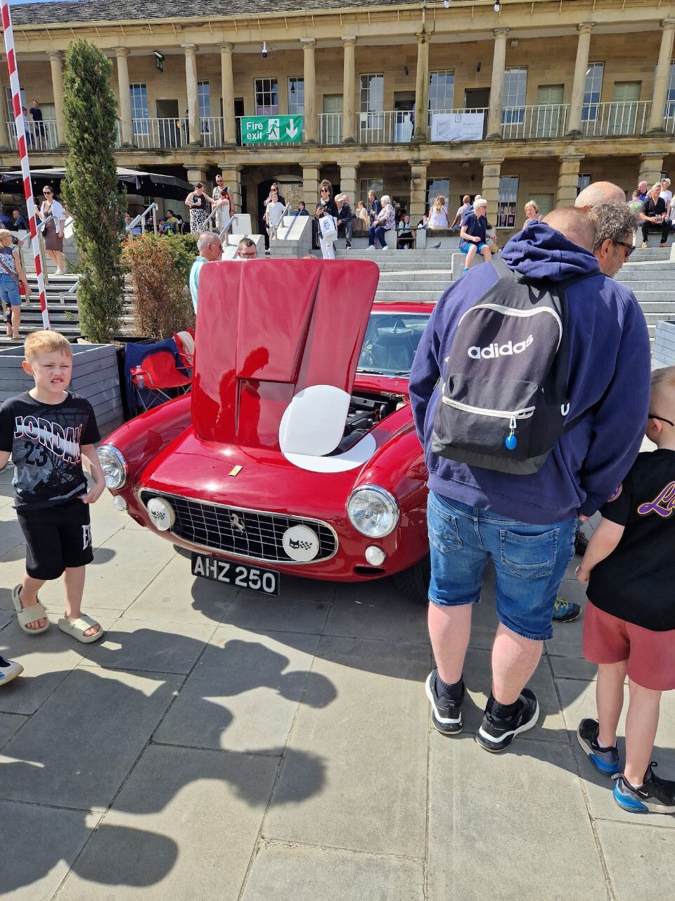

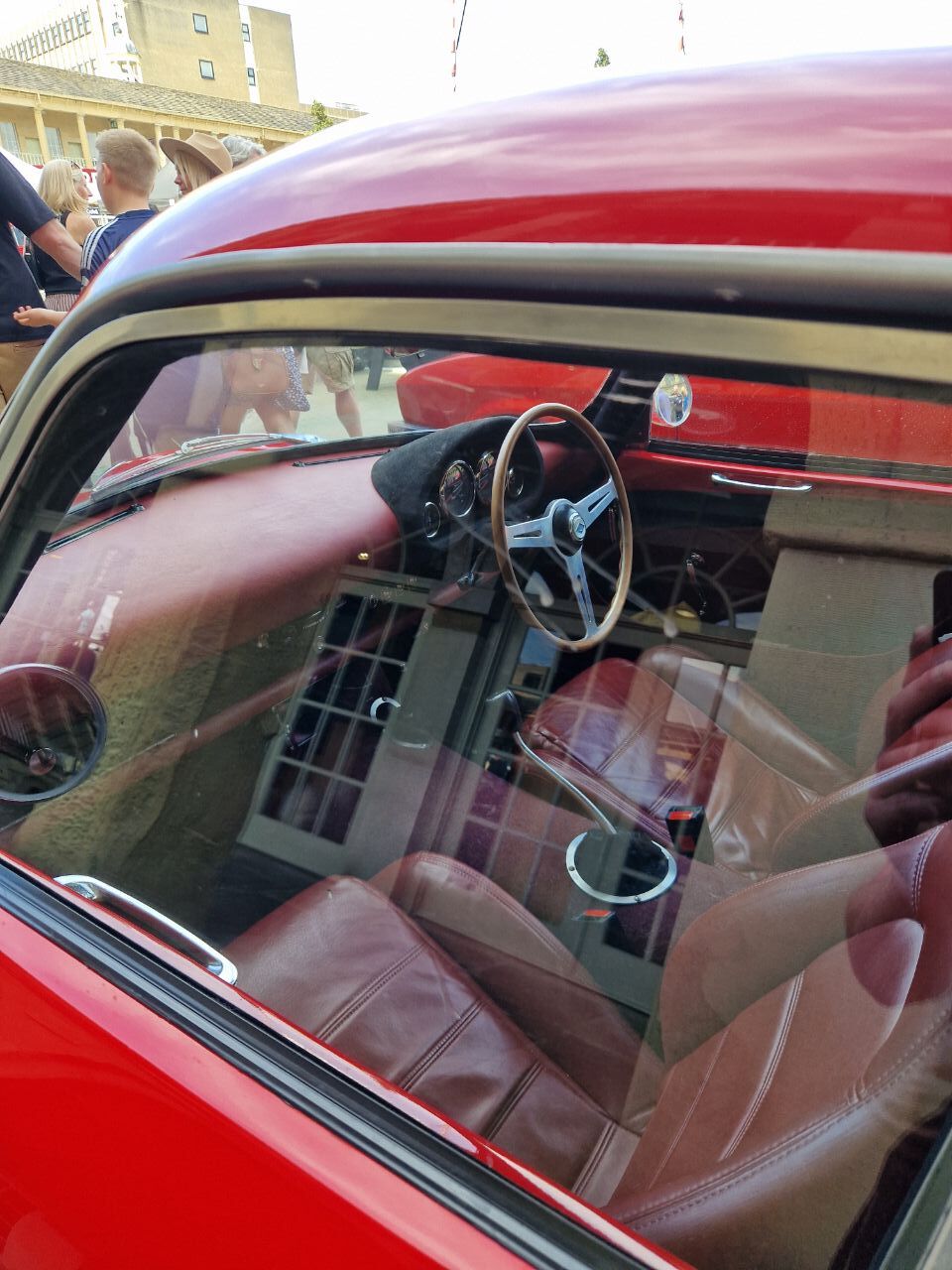

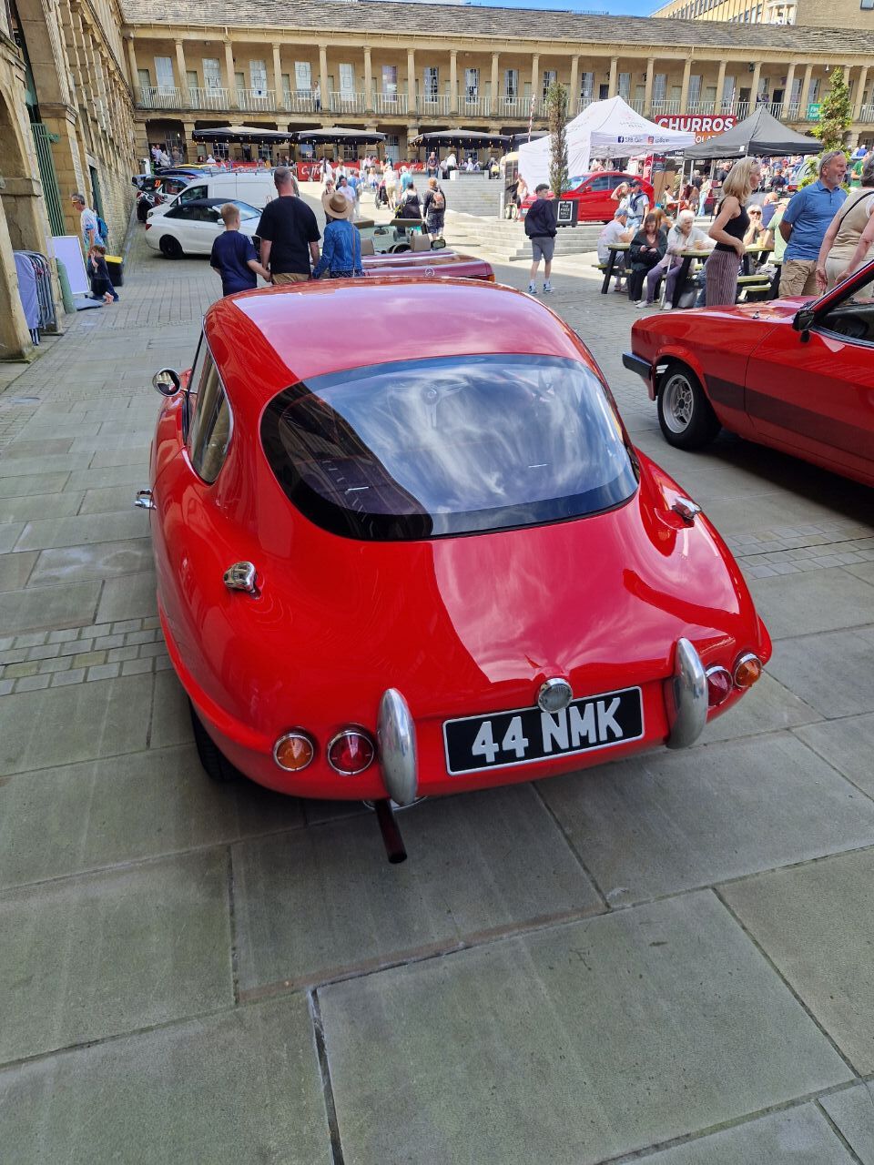

@Mally. Star of the show this. In the flesh they are such a beautifully realised piece of design for such a small concern. Not a bad line on it.

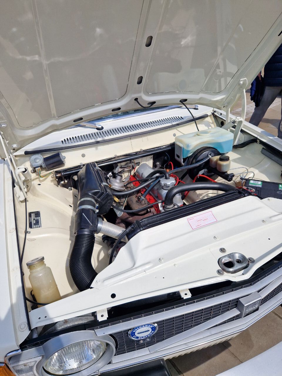

20260425_123056.jpg.5130737d52df3b073e09de0e8fcbbbe7.jpg20260425_123104.jpg.534fa6ba28f21aeb23010577cd91a657.jpg20260425_123109.jpg.dc67b487728fa1965b320164ea92ea42.jpg20260425_140246.jpg.48f5c40106a81f809b579ca734b40335.jpgS800 very much in its working clothes. And all the better for it.
20260425_122744.jpg.94e158647892b3a7dac52cdf49d46da5.jpg20260425_122744.jpg.94e158647892b3a7dac52cdf49d46da5.jpg20260425_122751.jpg.7e5e93e5bd08102a6c2250df6c915dfd.jpg20260425_122815.jpg.4bcf5c98cb0eeea95a54edb2cb14a11a.jpgThe first works van my Dad was given in 74
20260425_132849.jpg.f20a82afcb8dc6b11783bb18e5d71749.jpg20260425_132902.jpg.c5b9919f888ec9511eb3a52e99b56970.jpg

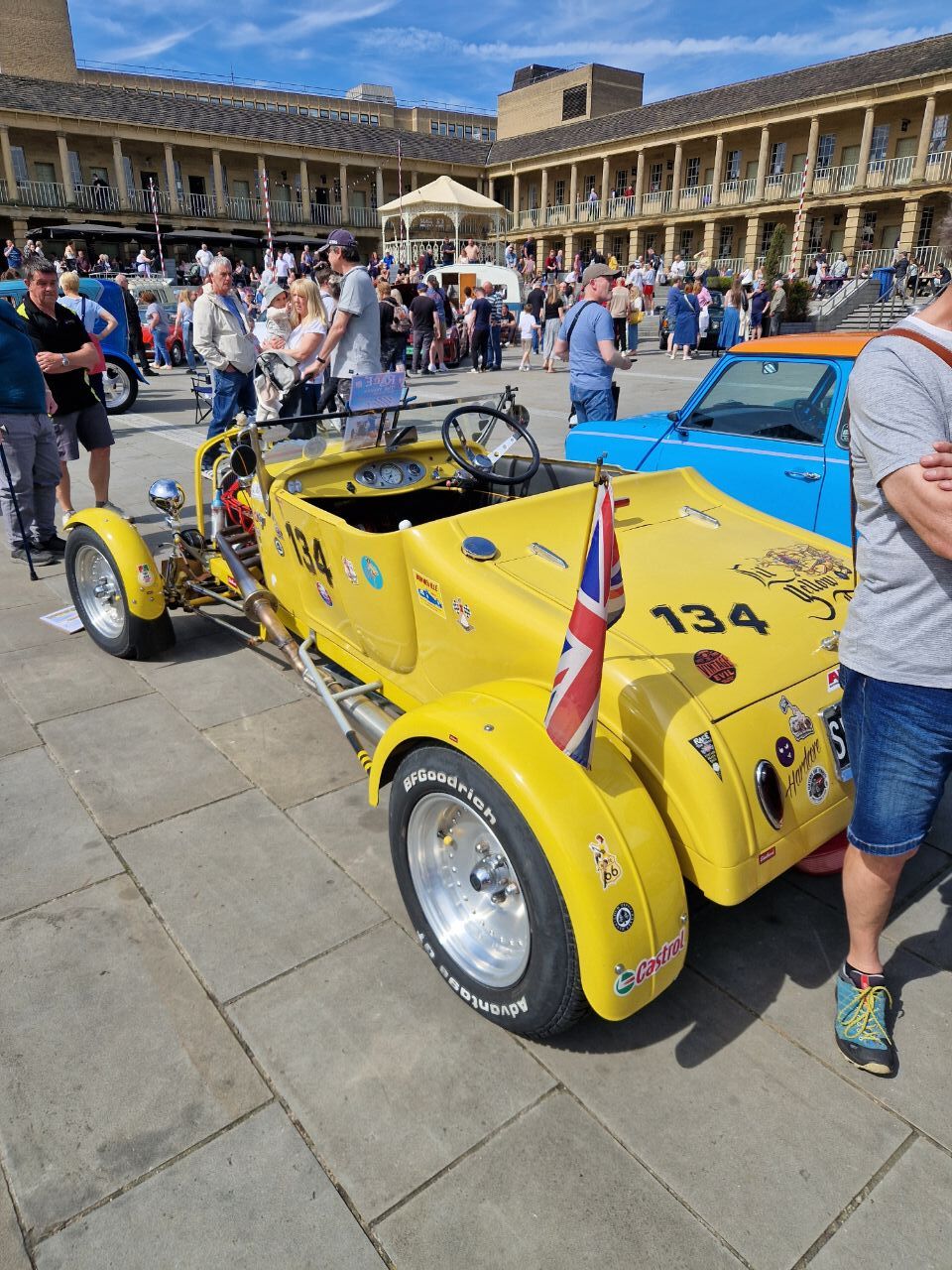

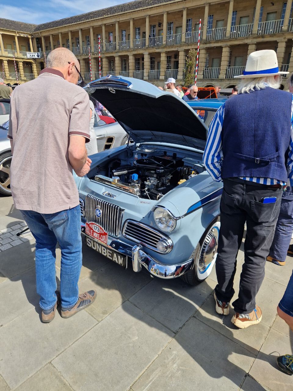

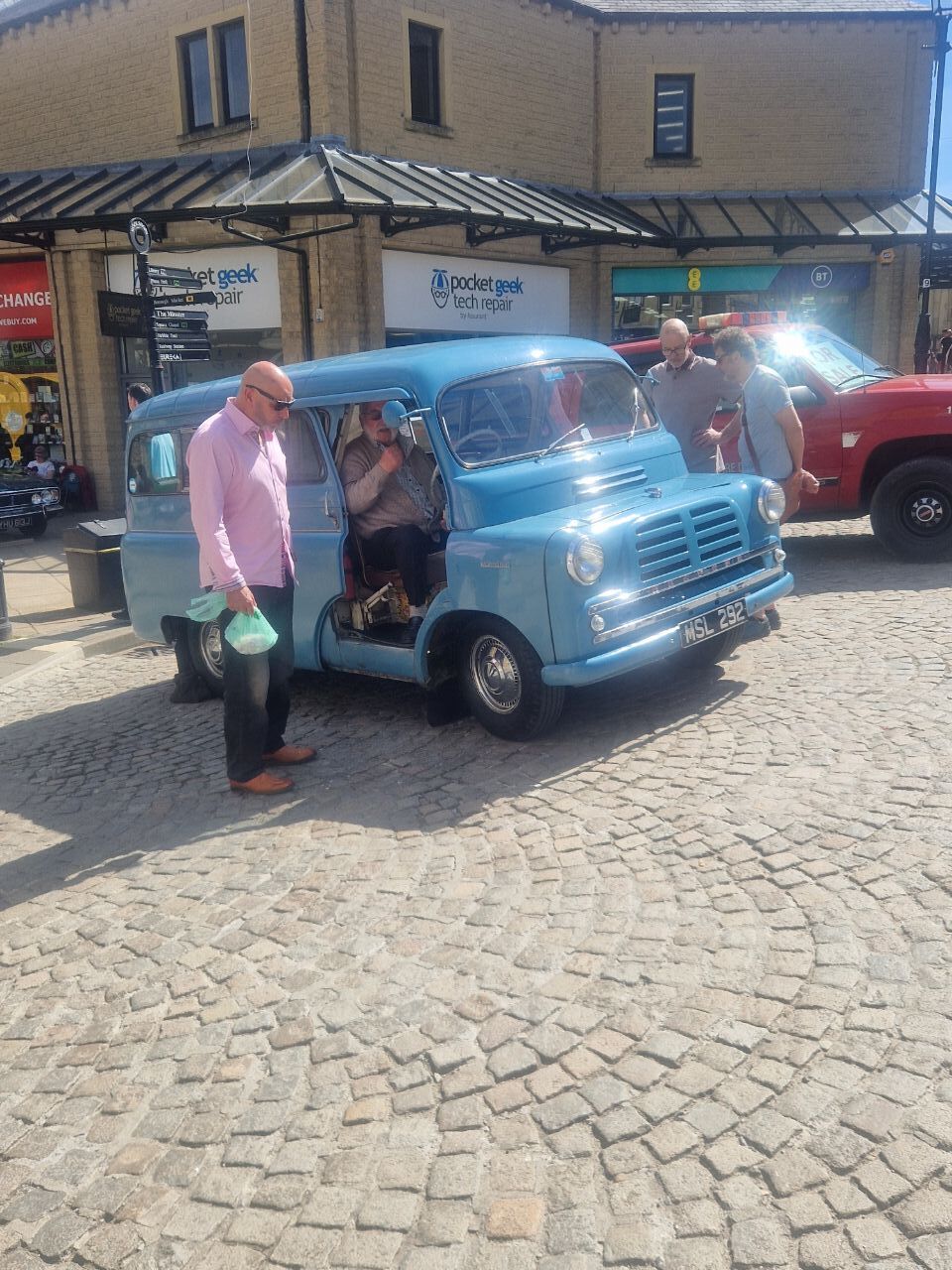

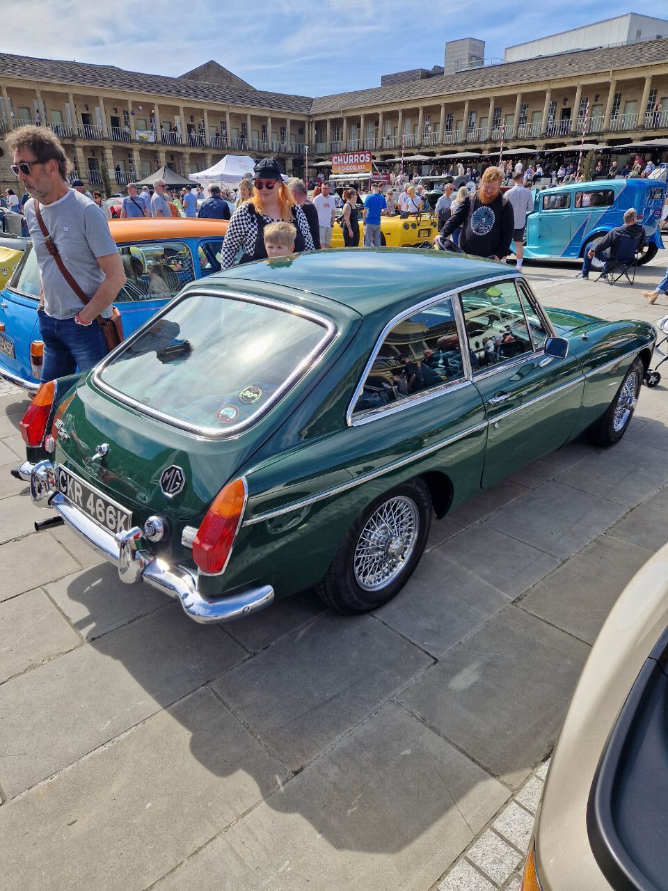

And the rest. Good show would go again. Good run out over to Todmorden, Hebden and onward. Starter is going fucked but then the car is a malevolant little bastard. You mend one thing it breaks another. Still goes like fuck though so ill forgive it 😄

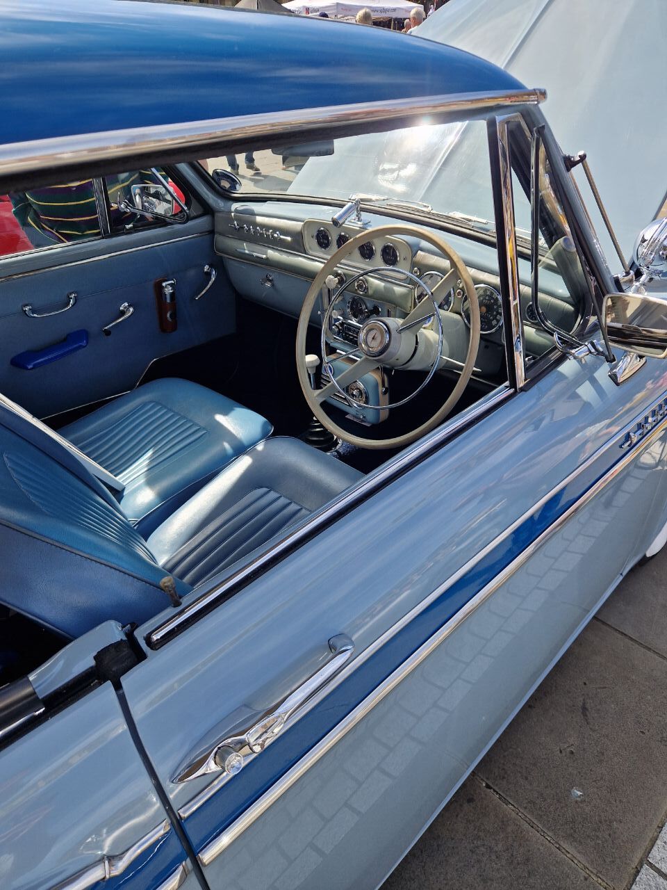

20260425_124145.jpg.4fbb791012965ddc4aa335708345614a.jpgYes its a Z3. So so clever though. The quality of the mouldings , paint and fittings are out of this world.

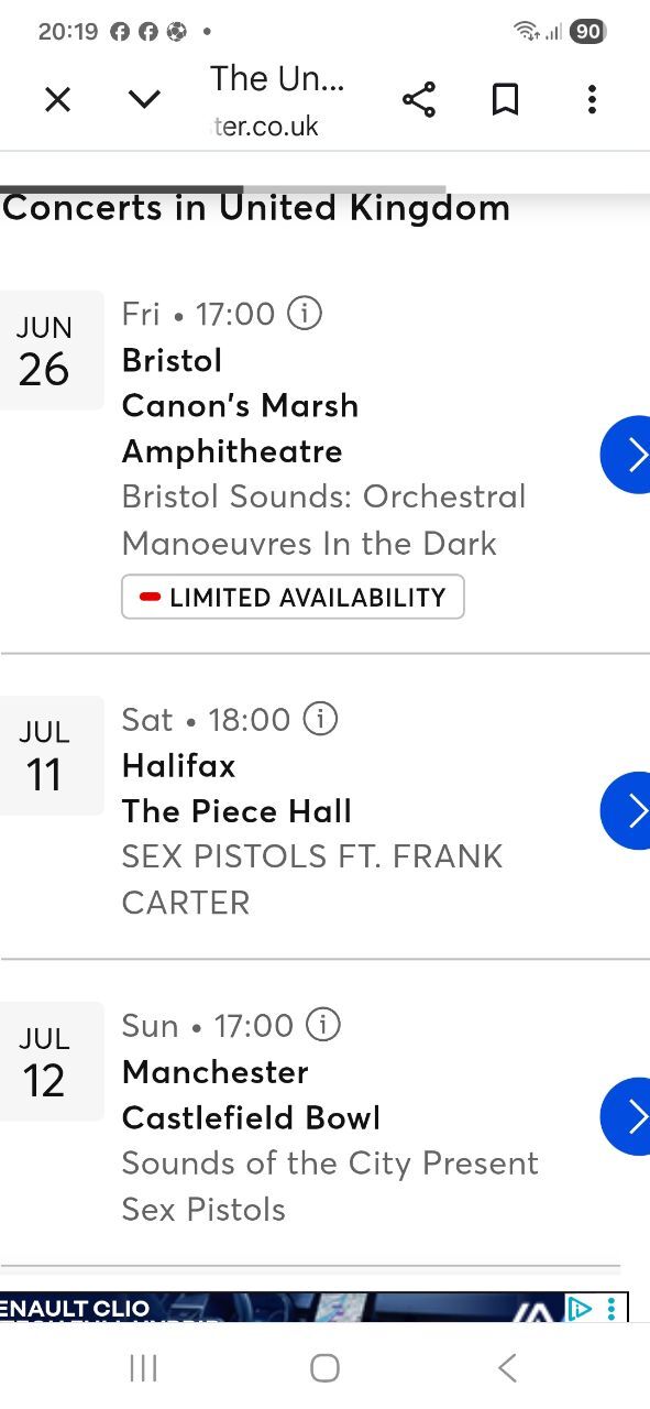

Isnt it just. My mum and dad have been to gigs and a theatre show but it was my first time. Id reckon a decent gig here would be quite something (goes off to see where the Undertones are playing next year).
Edit
July the 11th this year. Bugger. Thats more money i need to spend
Wow, those seats are amazing! Glasgow dealer badge on the front as well.

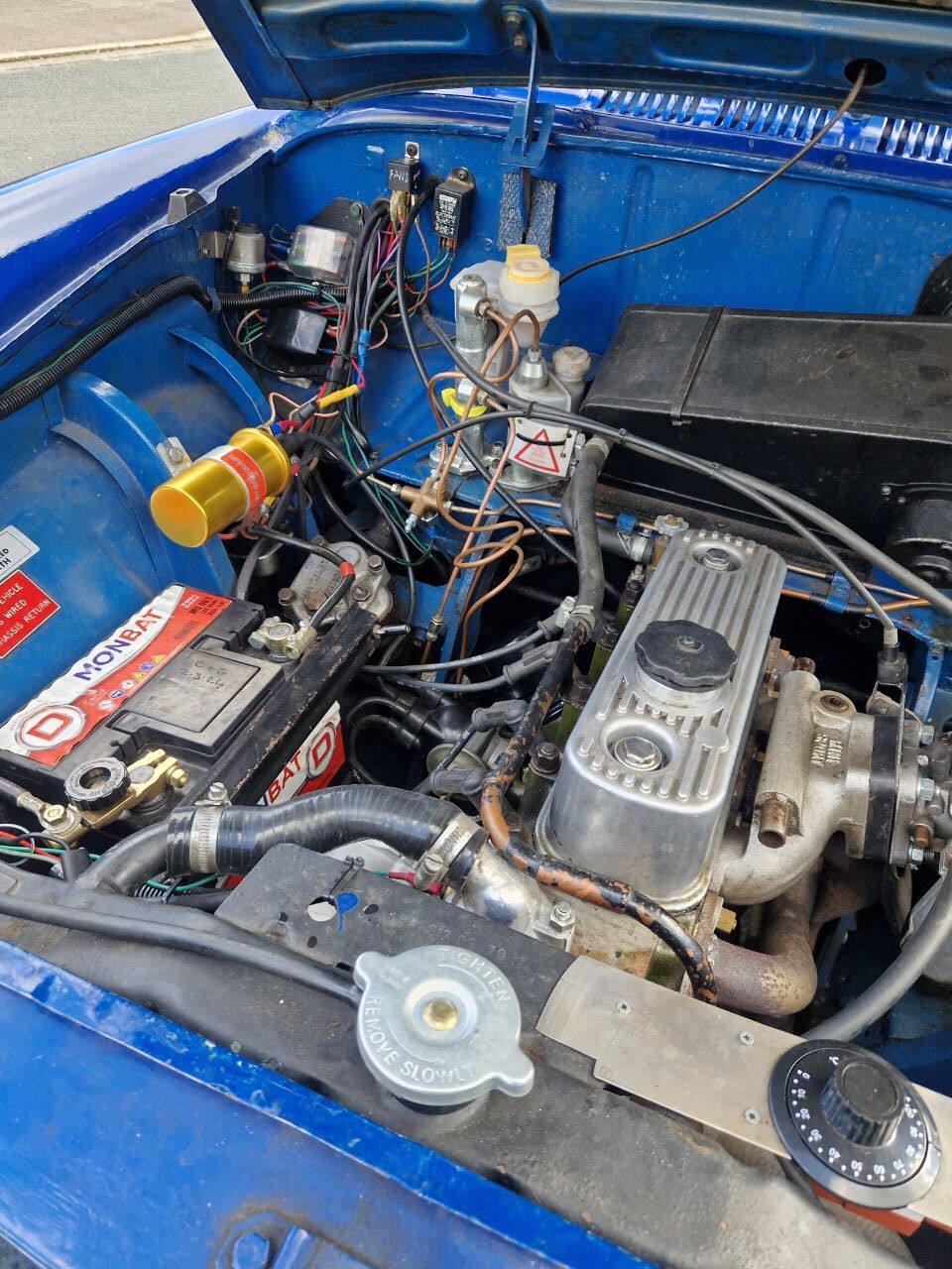

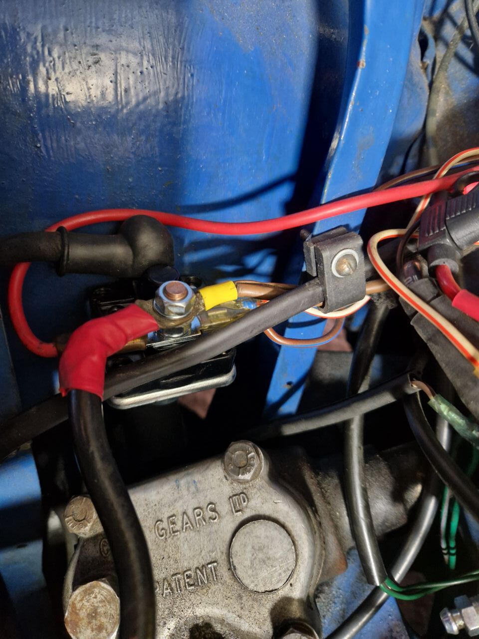

Another low quality update. Recently the idea of starting has become more a concept than reality. A lottery as it were. A twist of the key could be met with the coarse rasp of the 4 pots of Eric Barehams finest. Or a singular click.
Fighting my usual impatient urge to just stick a new starter on, i actually investigated. Bridging the contact posts of the solenoid (a slightly nervy job as its bolted to the inner wing right under the coil "Do not make contact with either of those 🤣") brought the starter straight in. Mercifully, a "genuine Lucas"solenoid is just £18. So one was ordered.
20260516_152621.jpg.aeb3da4cad327b076eb14ae43be85abe.jpgCoil unbolted and cast aside for access
20260516_153455.jpg.4be6686e5ba97cfcd4dd09e7c2645718.jpgOut
20260516_153512.jpg.f8d4886e981c8336918fd114599323e7.jpgGreen box of undisbuted quality
20260516_155758.jpg.e24627ce1411f32c4df4676d3b6dfcff.jpgAll buttoned up. Took the opportunity to tidy up more wiring, including heat shrink on the incoming live from the battery which previously had quite a bit of bare strand.
First crack of the key. Real do, normal service resumed.
Thanks as usual to the likes of @Tommyboy12 @Mr Pastry and @High Jetter (sorry if ive missed anyone off) for their advice in identifying which Lucas starter i needed before i decided to grow a setand mend summat.
Other than that it just works. Very well in fact. Such a fun little bus this. Join me next time when i call in my warrenty from the gearbox rebuilder for the second time (its been coming a while).
Cheers all.

Those 'genuine' solenoids are shite nowadays. I carry a spare now as they just conk out for no reason
Fuck me Tom, at this rate im going to need two gloveboxes 🤣
Yep, I replaced one of those not so long ago on something - Series LR I think.
I was dubious of the quality of the new one at the time, but it doesn't look like the originals can be rebuilt. Shame: presumably just a clean of all the contacts inside would fix most of them.
