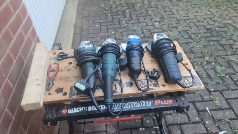

Is it possible to have too many grinders?  A different disc in each one is very handy:

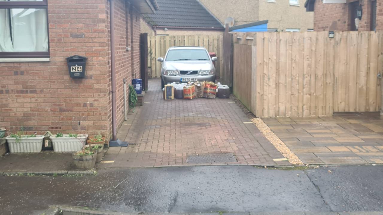

Got it up to @MrsJuular, what with it being her car and all, and left it randomly on her driveway.  Mainly to replace this little lot:
All of which went in the back of the E300, and got brought back down to my filtering setup.

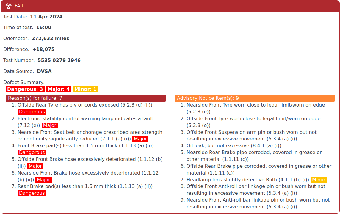

Not long after that, the E300 had to go in for MOT.  I am glad I had the C250 roadworthy, as this happened:
Bums.

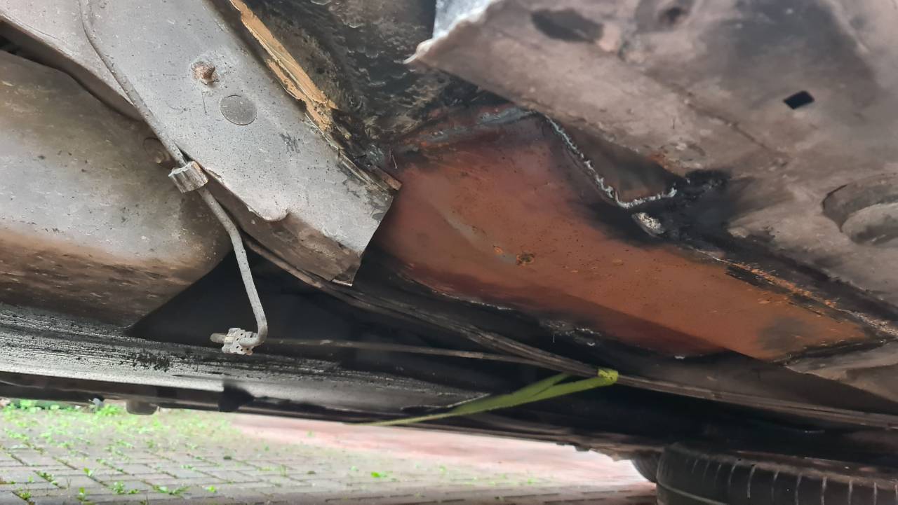

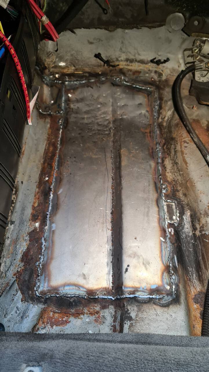

Most of it was easily sorted, but yet again... corrosion.  And a lot of it.  What started out as a hole about 5mm wide and 30mm long...
Got worse:
ended up as this:
egads that's a hole.

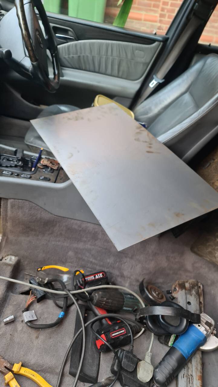

Sheet steel from the local steel stockholder:
Thickness comparison:
The old steel has a fairly hefty burr on it here, so I'm going to say they're close enough.  I then got a bit "hammery" with the new steel, and made up a new floor section:

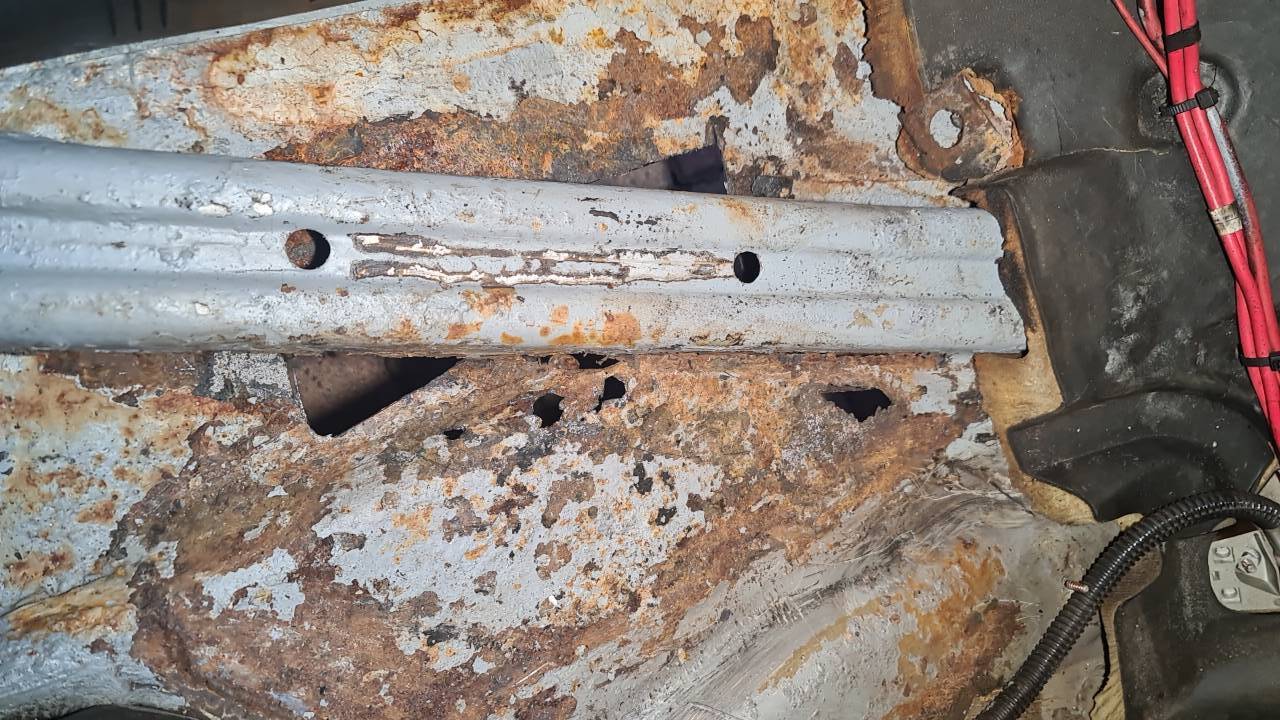

The stiffener that comes down from the engine bay was also looking fairly forlorn, so it got hacked off and replaced with some more folded steel:
A large pile of unwanted bits of mercedes were left over:
and I had had to pull the brake lines and fuel lines well out of the way of welding.  I did not want to remove them, so it was just easier to bend them out of the way and retain them with a ratchet strap:

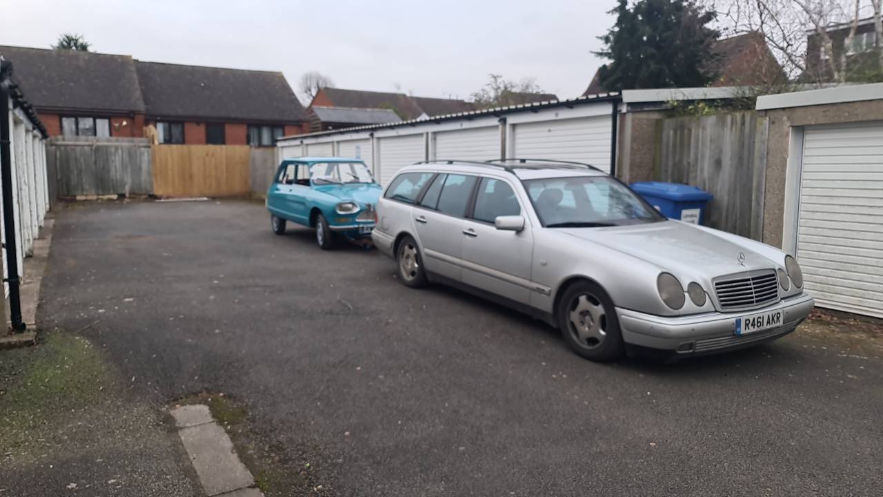

Rather out of focus, but that is a french registered LHD AMI8 that ended up being towed up to the FoD to be used as spares and parts for the rather nicer one that was A-framed up to Scotland.
It was also astonishingly rusty.  Various parts were removed simply by pulling them off up at the FoD.  Rather concerning having just towed it about 150 miles.  Although amazingly the brakes worked fine.  LHM is just so much better as a hydraulic fluid than DOT3 brake fluid.  Nothing siezed, working just fine.
