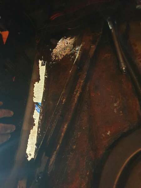

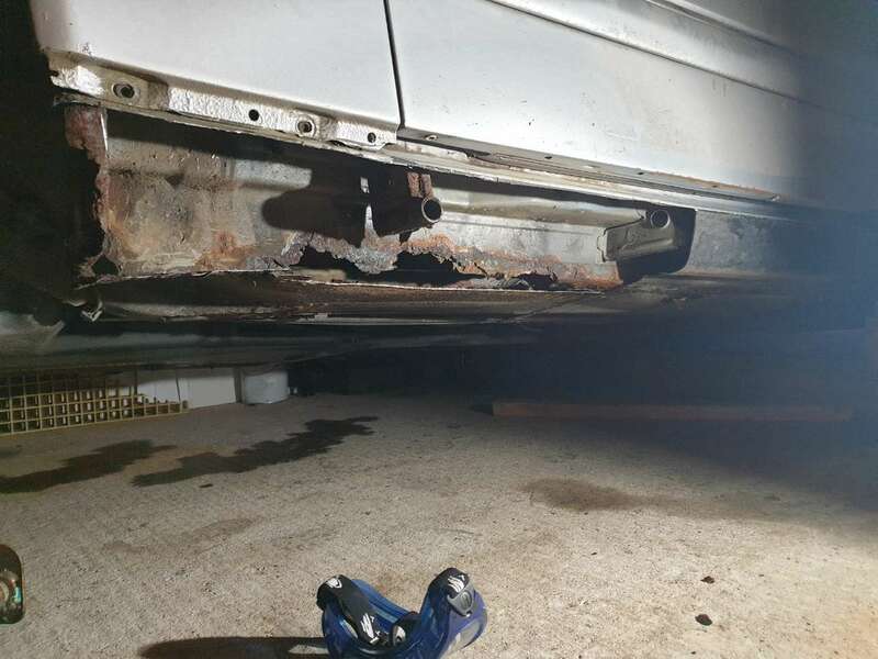

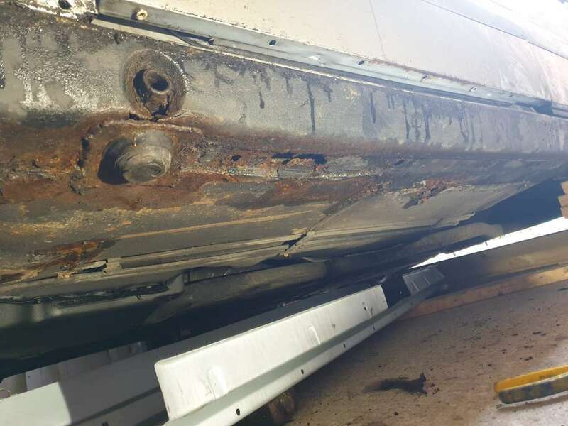

As mentioned on the grumpy thread, I managed to poke a hole in the sill of the Merc.  It's MOT is now out, so I need to get going with the welder to get it sorted.  This was what I did:
Which doesn't look *that* bad.  But, as anyone who has done repair work knows, the rust is going to be worse than that.  I also knew that on the last time I jacked the car up on the jacking point, the sill crunched and compressed in quite a bit, so I was expecting rot.   Removal of the wing liner and the sill liner was needed, as the liner wraps around under the sill.  Theoretically that should give protection to the sill, but I have a feeling that actually it holds a fair bit of mud behind it:
Arch liner off,  wing trim piece off, door outer seal off too.
This is not looking good.  I can *feel* the crunchiness.

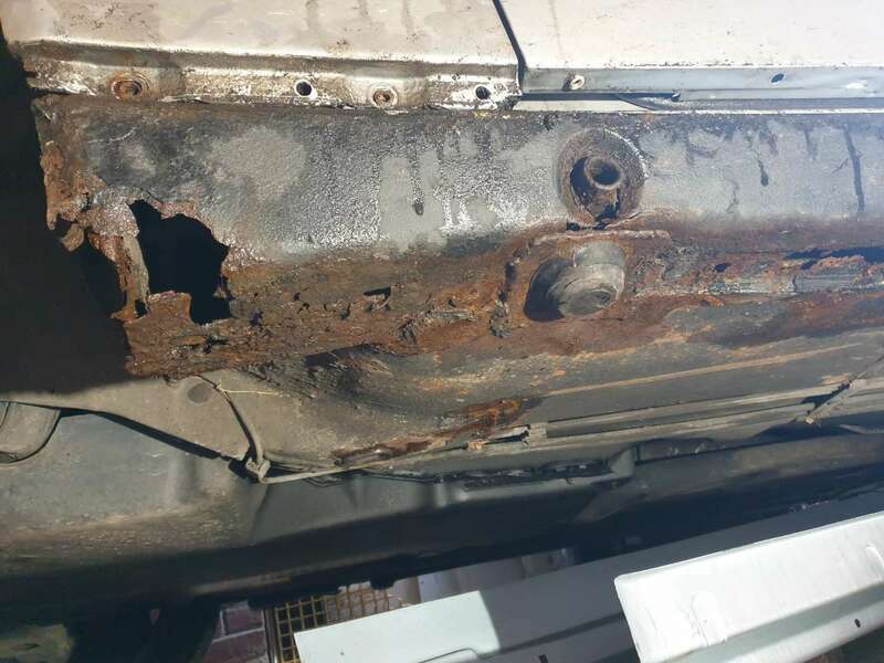

Sill guard off now too.. and surprise surprise, there's a fairly large hole under it:
And to be honest, that welded repair around the jacking point does not give me confidence.  This car has had a repair on this side floorpan before now, and I'm not hopeful for how well it was done..  The welding quality is good, but the fabrication and general quality of the repair isn't so clever.  There's going to be galloping rot in here...
Yep, there it is.   That is not good at all.  It extends further up the sill too.

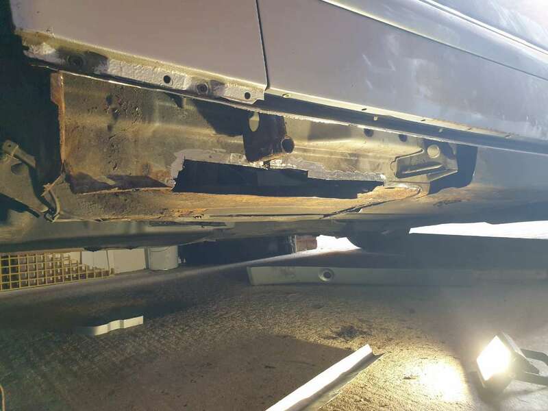

Several hours later, 2 cutting discs later and half a Henry vacuum cleaner full of jacking corrosion later, I have this:

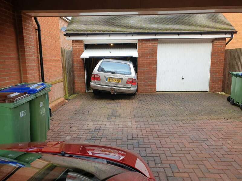

For amusement value.. there is so much shite in my garage at the moment, I can't get the car in fully, so it looks like this:
Single garages are crap.  I dream of a decent workshop.

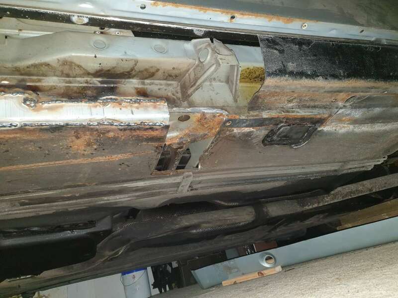

Didn't get a specific photo of it before doing other work, but I ended up cutting even more out of the floor of the car today.  The repair that had been done previously had rubberised seam sealer slathered all over it, which of course did nothing to actually protect the steel from rotting, if anything it served to hold onto the wet and rot it out faster, so having peeled back more of that ghastly "sealant" there was more steel to remove!
Getting bored of cutting bits out, and beginning to have some real risk of the floor moving so much I can't line it all back up again, it was time to start glueing bits together again, so the inner sill was cut back to a sensible shape:
and a repair section welded in:
I was still getting to grips with the 0.6mm wire and getting the welding settings right on this.. 0.6 mm wire is definitely a game changer on thin steel.  I've always used 0.8 in the past as I had a massive free supply of it, but as I've now finished all that, I thought it time to get some 0.6mm wire, and treat myself to a new longer euro torch.  This one has a rotatable head and is superb.. I now just need a longer earth clamp cable, as the lovely long torch is twice the length of the earth cable now!
Here's the section I discovered and cut out, mentioned above:
Got a bit cut ready to go in, but it was getting late, so I've opted to do that tomorrow.  The other square patch is another area of rot that was found.  Had to peel back the outer sill to get to it, and then let in a repair section.  Did that one from inside the car as it was easier access:
I'd not cleaned the steel up very well on that one, so the weld was a bit shit.  Kept blowing through too as I failed to reduce my welding current for working "normally" as opposed to overhead as I had been with the last weld.  Still, it's solid, and will be completely hidden with carpet on one side and zinc/bitumen paint on the other.  Best kind of repair.
Still need to re-manufacture the jacking point, as there's some larger sections of steel missing from there, do the other little bits and pieces and then weld on the outer sill.  Then paint, and rustproof.  Urgh!
