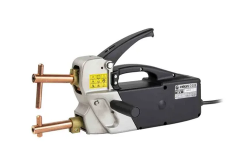

If you can afford, borrow or hire one, a resistance spot welder is a great tool.  Very easy to use - just need a lot of patience getting everything clean and ready.  Even with a long arm set, they have limitations of course.  Some good work in this thread so good luck with getting it going.image.png.14761cdc023978bae684b21d4d34c54a.png
My fiance's dad used to make spot welders out of old microwaves! 😬😳
They look like fun, and totally safe*
"Roadside Repairs" .....
*Tesla style 😄

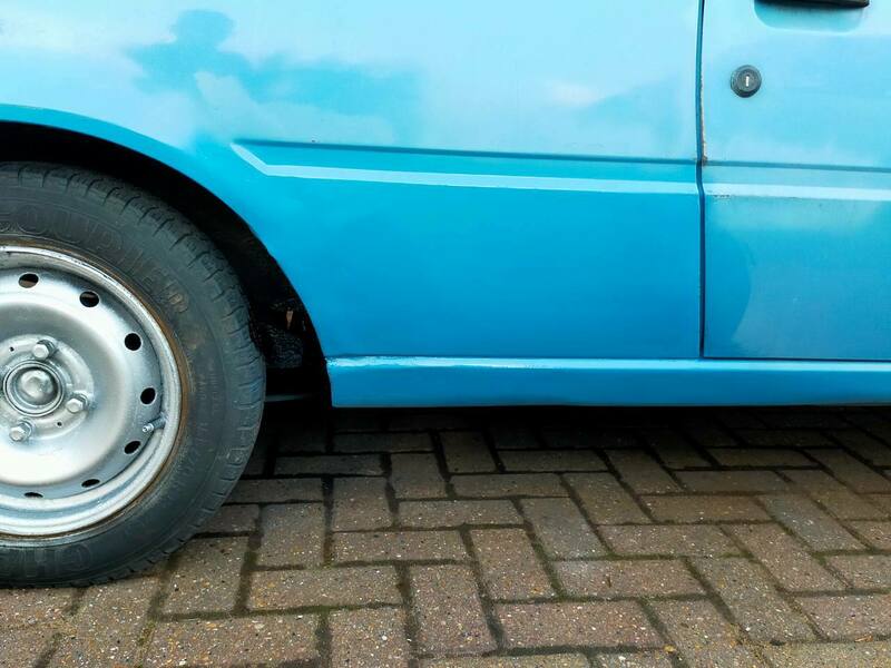

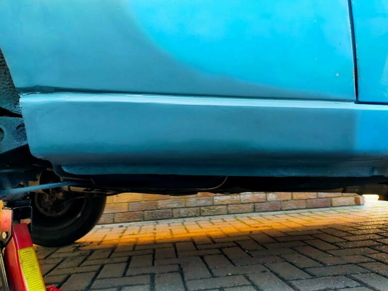

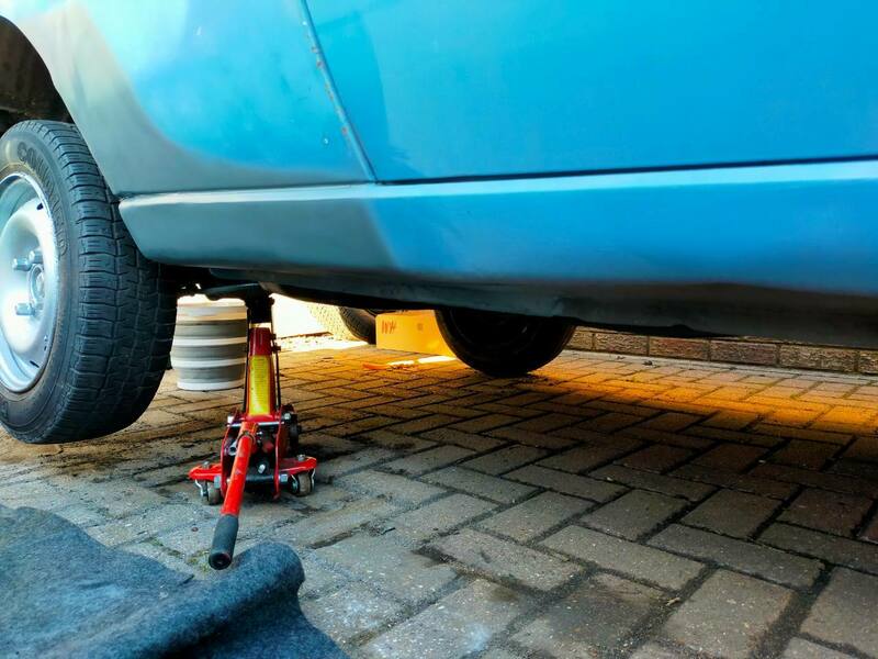

That'll do I guess. Still have to start the other side mind. And get some blue paint on this side.
53 minutes ago, DoctorRetro said:
Nowt wrong with that.
Pretty good finish and waaaay better than the grot before it. You've done well.
looks great. must be very satisfying as a first welding job.

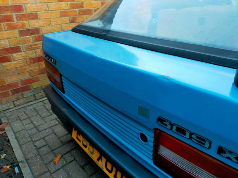

Looking good! That rear plate will probably need replacing to avoid an annoying fail.
Yep, definitely on the to-do list. Also, lesson learned. Be careful where you put your hands when pushing a 309... 😳 Oops.

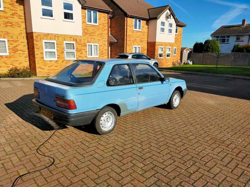

Great job! Looking loads better. Now just the other side to do! Found any more holes yet?
That's a great bit of work you've done there.  Hope you're proud of it (Dagmar Dents in the tailgate aside, of course).
Not really, I think I can do better. Will see if I can improve when I do the other side.
Dents gone now 😁
That attitude is even better.  Just don't let it become perfectionism, because then nothing will ever be good enough and you'll never get anything done.

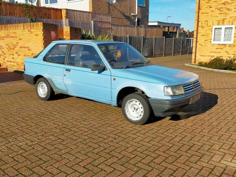

Paint arrived.
Tell you what, that's genuinely Bob on is that. Well done that man 👍
Brilliant job. Good idea to get one area done completely before starting another, especially if you're working outdoors with poor weather.
2 hours ago, DoctorRetro said:
Paint arrived.

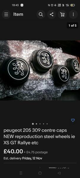

Silver steel wheels really set it off. I seem to remember them having black centre caps with the lion emblem when new.
Yeah, and the bit around the bolts was painted black I think.
Not paying 40 quid for a set though 😳
