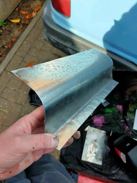

1 minute ago, DoctorRetro said:
I think this is how it's done ... 🤷
Did you fold that yourself? It looks brilliant!

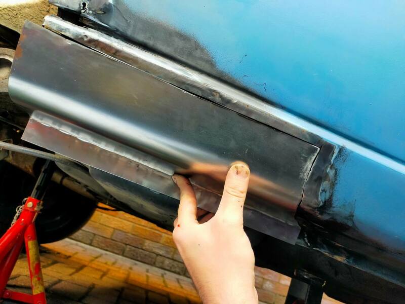

Immense work!!!!!!
Yep. Used mole grips and gradual bending for the lip, and an aerosol can for the curve
Just some minor adjustments needed.
I feel so fucking lost though, wish I had some in person guidance/support.
That looks alright that. Just wang it on and see how you get on. What’s the worse that could happen?  You got any magnets to hold it in place?
Looks like you're doing just fine. Confidence comes with practice.
Nice bit of fabrication that :-)

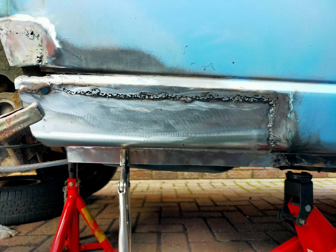

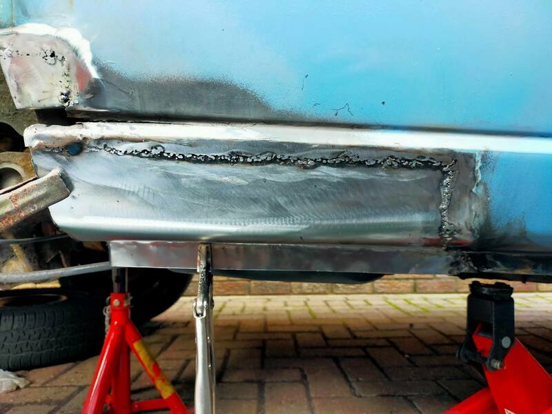

20 minutes ago, DoctorRetro said:
I'm really shit at this 🤣
No you aren't, that patch is really nicely made,and while the welding isn't pretty it doesn't look like it's going to fall off, you can add a bit of filler to smooth off the repair.
Don't forget to waxoyl the rear of the repair as it will rust out again extremely quickly if you don't.
Well done,that's really good work.
@DoctorRetro you're doing great, those welds are eleventy times better than I used to manage on the ba**ers, using that welder; twas either blown through of just blobby.
A bad workman always blames his tools etc, you're just proving that I'm the tool in this scenario.
Keep going Chuff.

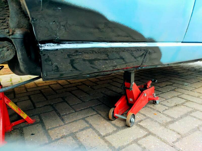

Oh, it's definitely solid. I need to get seam sealer, primer and waxoyl, so just blasted some paint over for now.
Bit of filler and it'll be fine. MOT worthy at least
That is brilliant. My first attempt was joining some exhaust pieces and it was way worse than that. I've seen much, much worse come out of commercial garages
Genuinely chuffed for you mate, you've done a fab job, just got stuck in and sorted it.
Putting the paint on to for now is a wise move.

You could probably grind that back a bit more to make it neater. I find a grinding disc helps more than a flap disc at times. Or get yourself a finger/power file sander.
