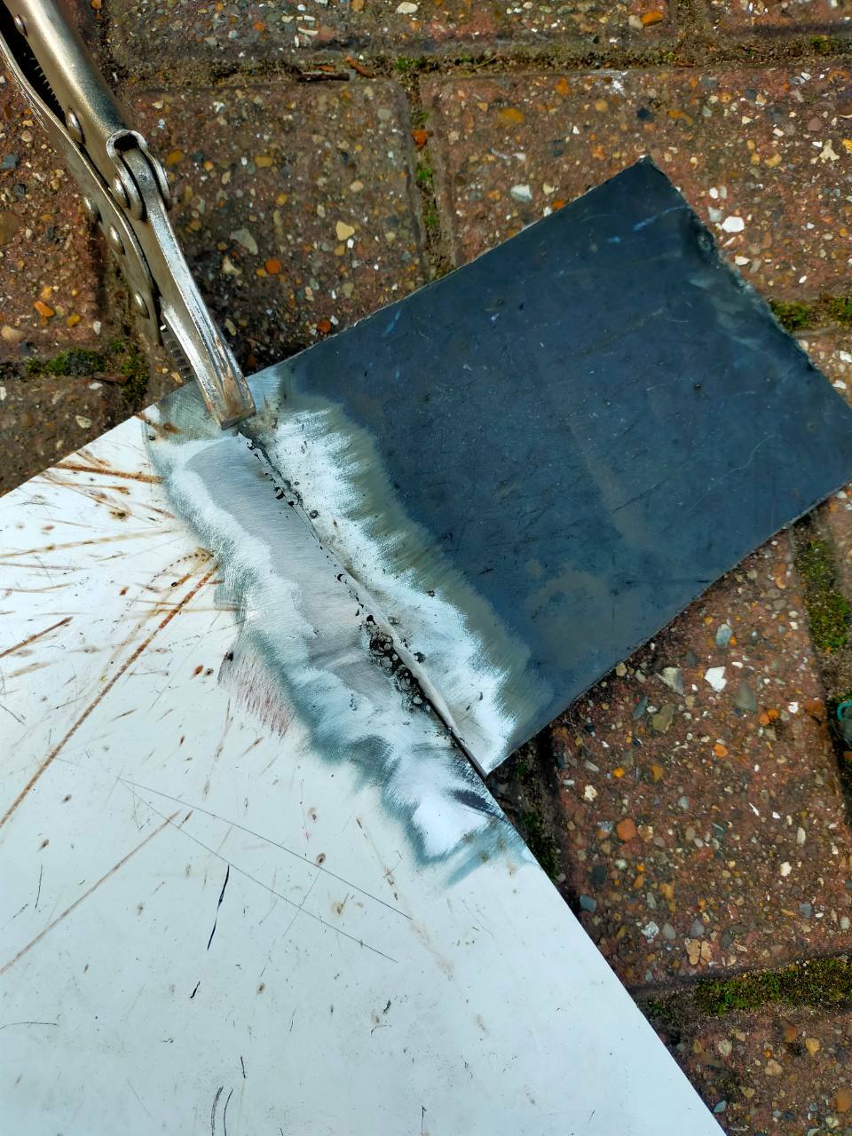

On 10/14/2021 at 3:00 PM, DoctorRetro said:
Had a little play with the welder, I literally have no idea how to actually weld/set it up.
8 pages of H&S advice is great, but not a clue how to use it 😂
Used flap wheel on it after to see which bits had actually joined.
The reverse.
From what I can see, none of that is an acceptable weld.
I'll have another play when I get chance.
Firstly, did you go over the welder to see what's what before you started? Is the wire rusty, if it is, strip it off the reel until you find clean stuff underneath and throw it away. Is the tip knackered, if so renew it? If the earth clamp is rusty clean it. The wire should be coming steadily off the reel, not slipping in the roller, feed some wire out and see if you can stop the wire with the palm of your hand, if it slips in the roller tighten it a touch, on a cheap welder keep the torch as straight as possible at all times, they really do not like being used while coiled or twisted.
To set the welder pick one of the settings and strike an arc, holding the torch tip 3/4" ish away from the workpiece then adjust the wire speed and see if you can achieve something approaching a smooth sizzling sound. Do this while the arc is lit, on thin tin you'll want to move the torch a bit to stop it burning straight thru. If it still does drop it down a notch and try again. Until you get the welder set somewhere near right and you know it's capable of actually welding it's a bit pointless trying to stick bits of metal together imo.
Personally I don't lap joint anything on cars/vans everything is butt welded. You know how to prep your material so that's a good start :-)

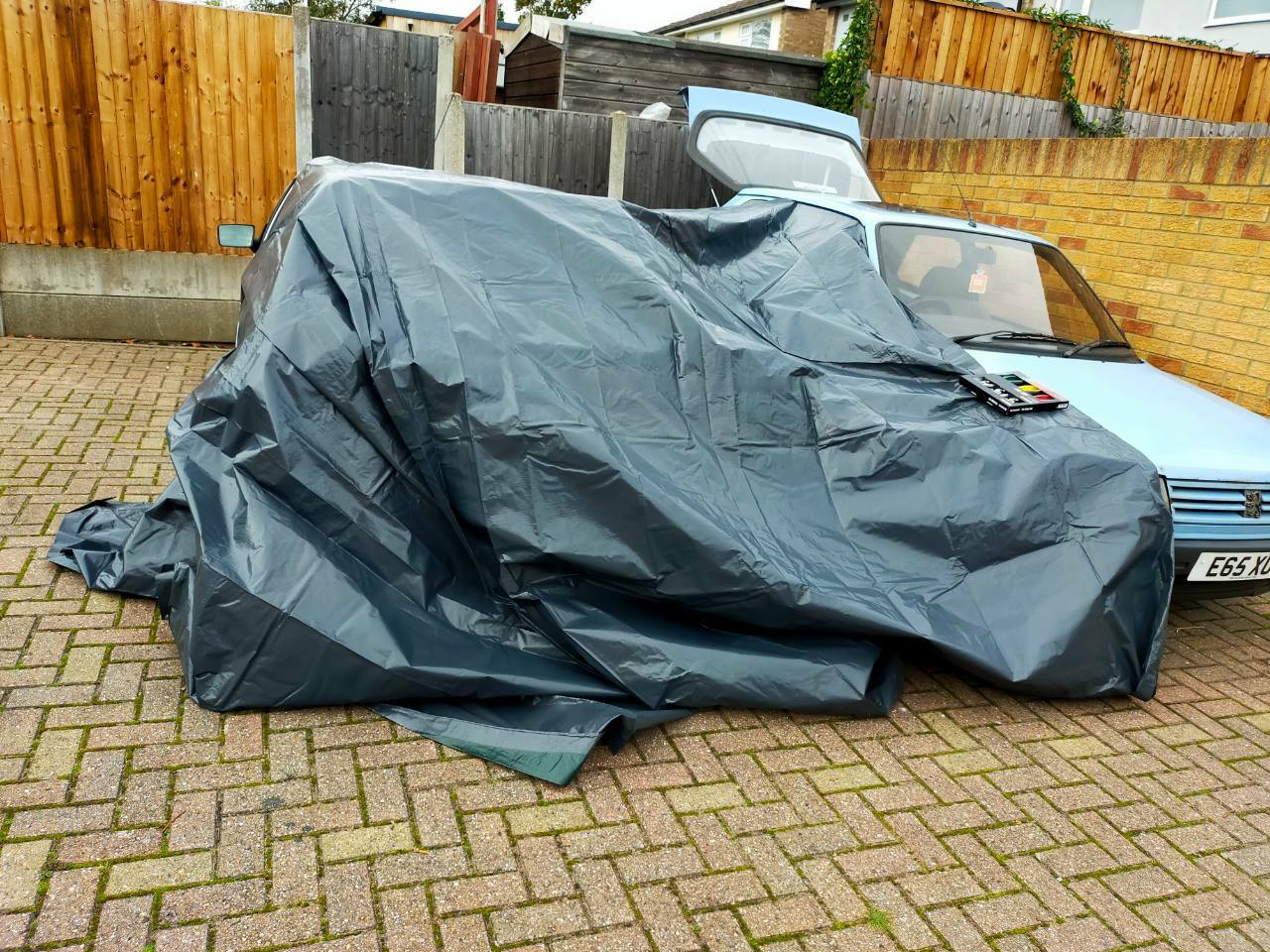

Welding tent.

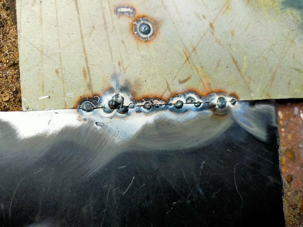

Still practicing
Your tacks are getting way better, starting to look like ideal penetration.
The top one looks quite spattery, as if either the metal isn't clean, or your gas isn't shielding the weld properly.
It looks like you've cleaned the metal, maybe there's still a bit of contamination? A quick scrub with some brake cleaner, degreaser or just strong detergent might help. You really do want 100% clean grease free metal, it makes all the difference.
On the second one, I think if you got those tacks closer together you'd be pretty much there. How do you find visibility through the visor? Would more light help?
Do you have an auto darkening helmet? With the welder on a low setting you can turn the sensitivity / darkness down to see better.
Good effort and definitely getting there!
Wire feed looks about right but it looks like you need a tickle more gas flow. The welds in the top picture look to have oxidised although that could be contamination from the surface. I'm assuming the second pic is just the reverse of the same panel? I can see the surface is painted, ideally you need to dress the paint down before welding. It will produce a cleaner weld and less spatter and make learning a lot easier.
Heat looks about right. If you're going to lap the panels over the top of each other on the car you'll need to crank the heat up.
