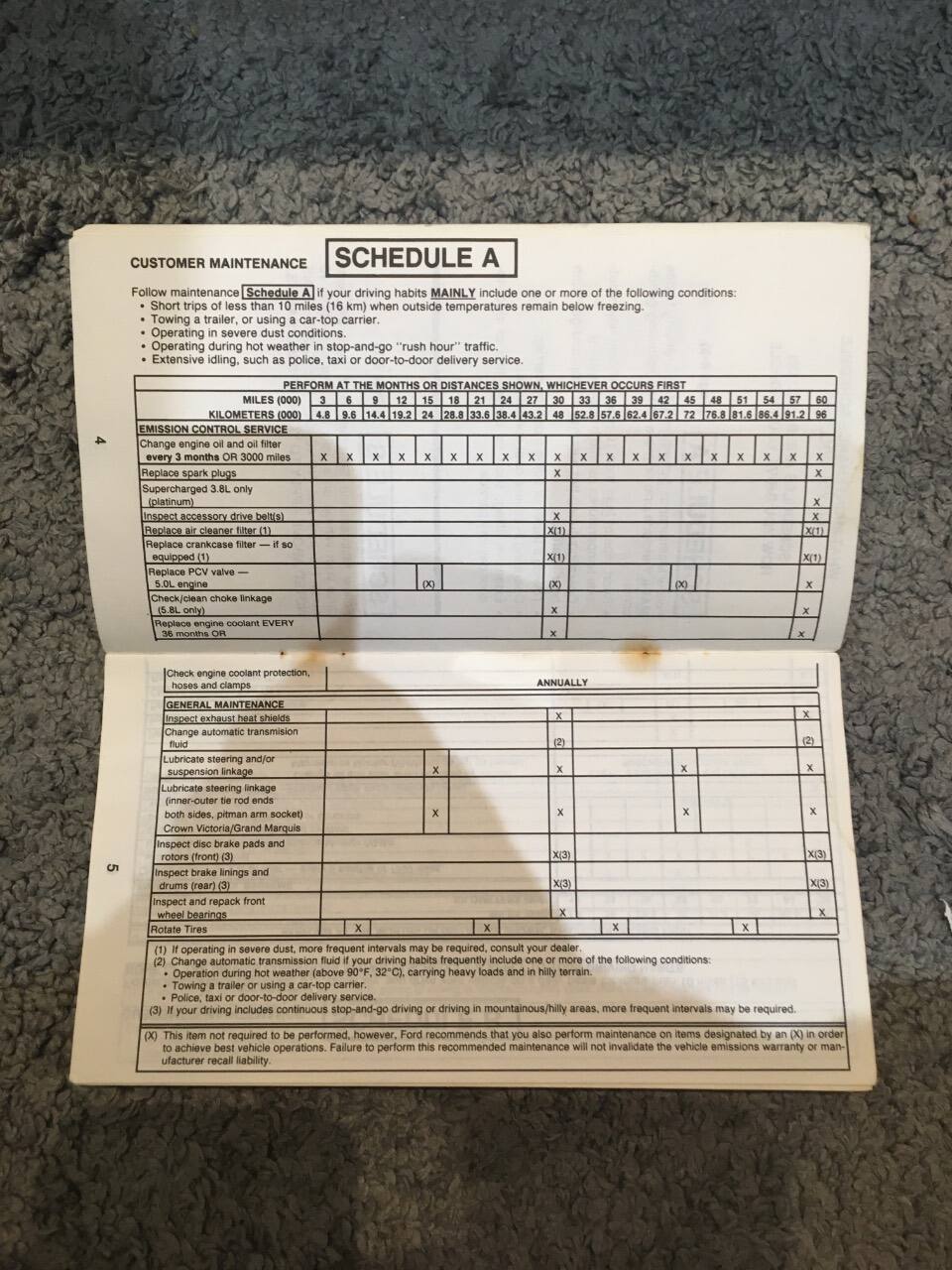

I’m guessing that if you’re in a hot weather state like Florida, Texas, California etc and you’re doing a lot of freeway and inner city driving then chances are you’ll be on “Schedule A” whereas colder states will most likely be on “Schedule B”.
The Mercury lived most of its life in California so probably would have been on Schedule A servicing.

9 hours ago, Steve79 said:
This is Fords 1989 service schedule for the Mercury
You beat me to it! I knew I’d read it somewhere that oil for the mercury was changed at 3000 or so miles. Crazy low.
the trucks I work on are changed at 120000km, or 150000km if on long interval plan.
