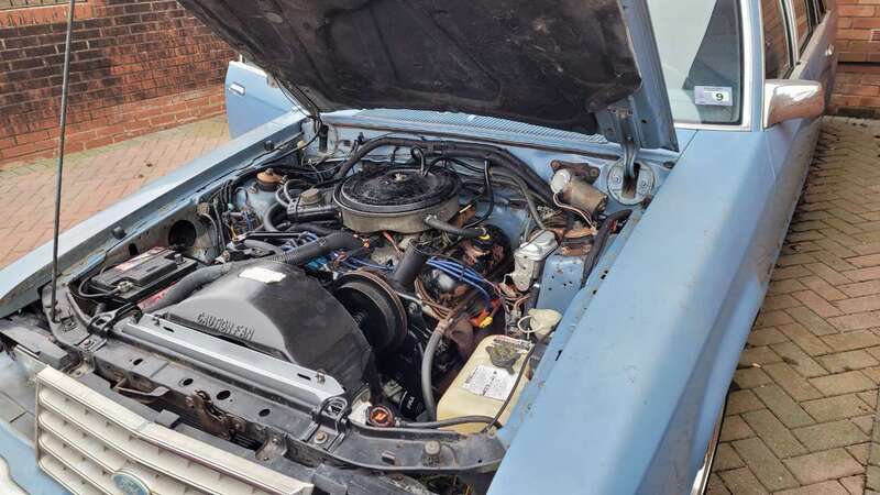

A couple of weekends ago I did some engine checks. Compression tested all 6 cylinders, checked & adjusted spark plug gaps, did continuity test on ht leads & checked base timing then with the help of my mate we fired the engine in what I believe to be 7 years.
Unfortunately I can't loads the video but it ran really well, no hesitation or lumpyness.
I've also been cleaning, stripping & rebuilding loads of engine parts ready for the rebuild.

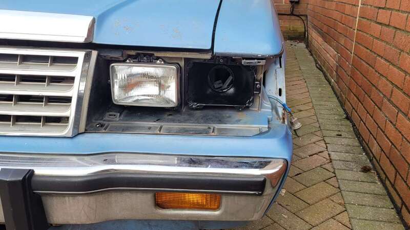

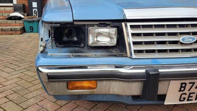

So I needed to remove the old headlights as they were rusted inside & frankly looked shit.
So I removed the buckets too & my mate is going to blast them in work for me.
I'm now trying to sort wiring to the sidelights as this cars sidelights are in the bumper indicator & corner indicator which is obviously orange, someone's been here before & hacked up the wiring So I'm going to sit with a multimeter & work out how to do it. I'll probably drill into the back of the outer headlight & fit a universal bulb holder. Hopefully I won't crack the reflective inside.

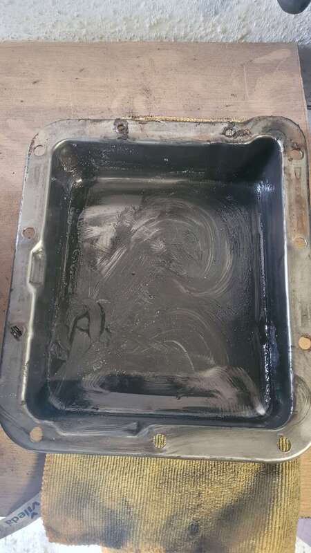

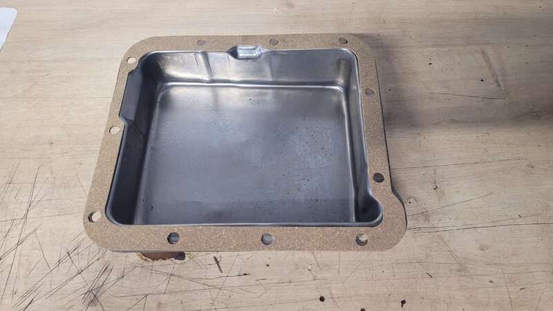

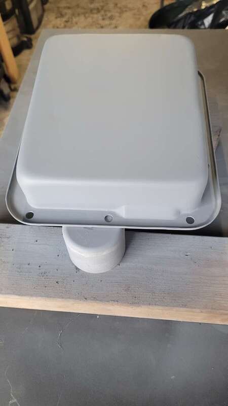

Drained the gearbox & removed the sump. Surprisingly clean considering its age. I made a gasket on the plotter in work as I couldn't find one in cork for an 11 bolt sump.
Prepped & primered.

I've ordered some new lights from Germany so cracked on & fitted the buckets, inner headlight & bezels.

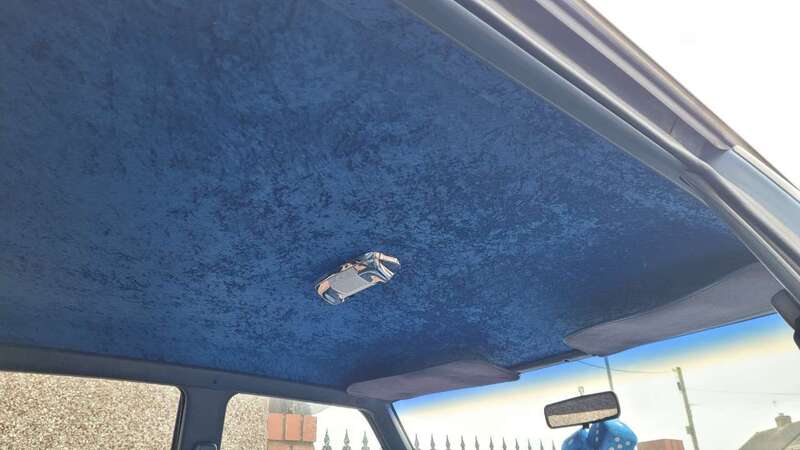

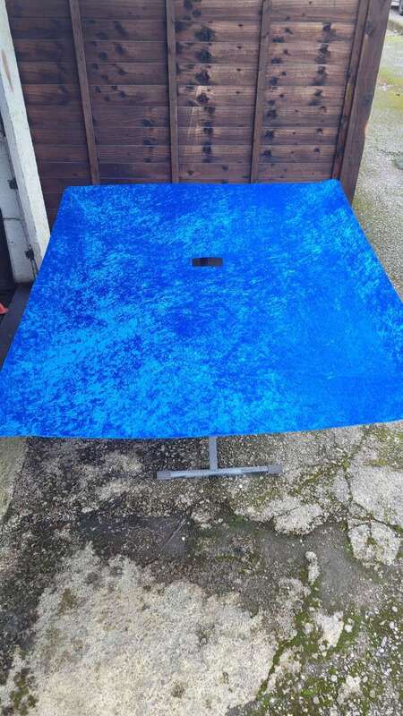

I pulled the headliner out as the cloth had sagged & was rotten. I replaced it with a bit of jazz. I need to fit some thick pvc strips to the back side as it bows a bit at the back.

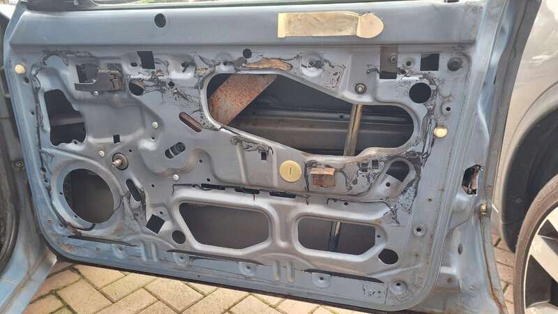

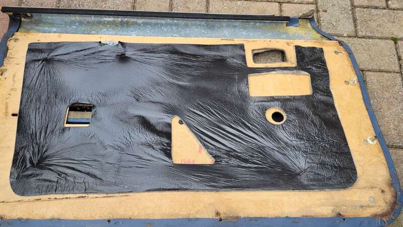

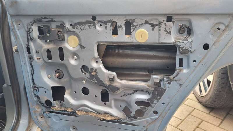

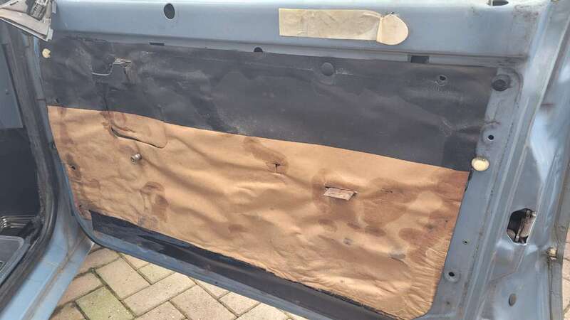

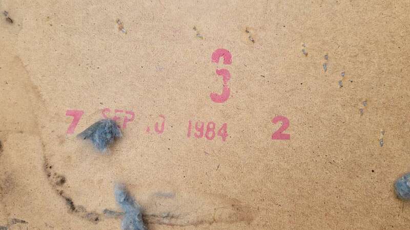

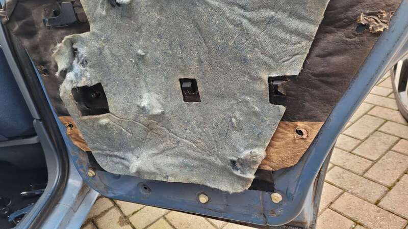

I then pulled the doorcards off thr passenger side to access a crease/dent that I want to try & make less denty. It was nice to see all the original sound deadening & insulation still in place & date stamps on the back of the panels.
20241206_120018.thumb.jpg.53ae82ef9fb39f45b3dd553abbc85dcb.jpg20241206_120041.thumb.jpg.588f37005b68dd9ce047235b584971b4.jpg20241206_120309.thumb.jpg.8d69e4c7ed111c7edd8102c170c0883b.jpg20241206_123811.thumb.jpg.db65db24afa40017090f106f2263721f.jpg20241206_123847.thumb.jpg.25d8d8cd08c3788ff8e7491cee24242f.jpg20241206_124328.thumb.jpg.fb2d8a997f0c1f9c362baa80c35fbaf8.jpg

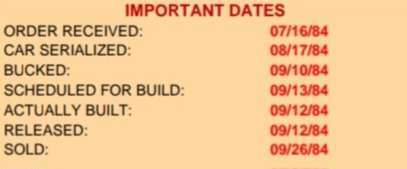

The dates corresponded with my Marti report.

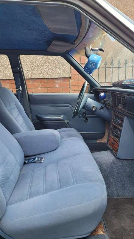

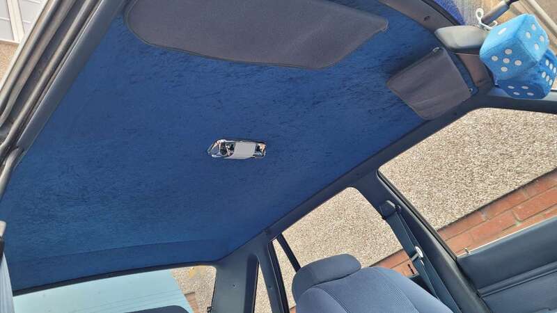

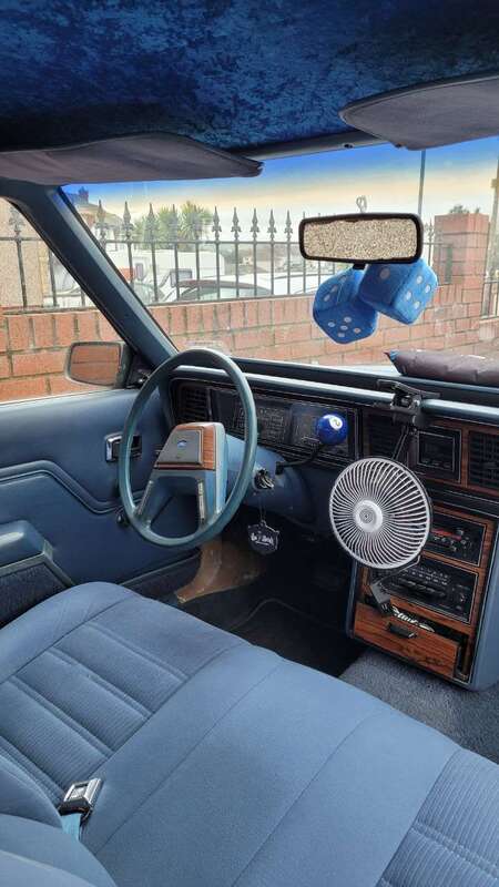

Good progress today. All the interior, other than passenger doorcards, is all back in the car for the 1st time since I bought it & parts where in the boot.
I fitted my pool ball selector & a 12v fan from Ebay. Refitted all the roof trims & sun visors.

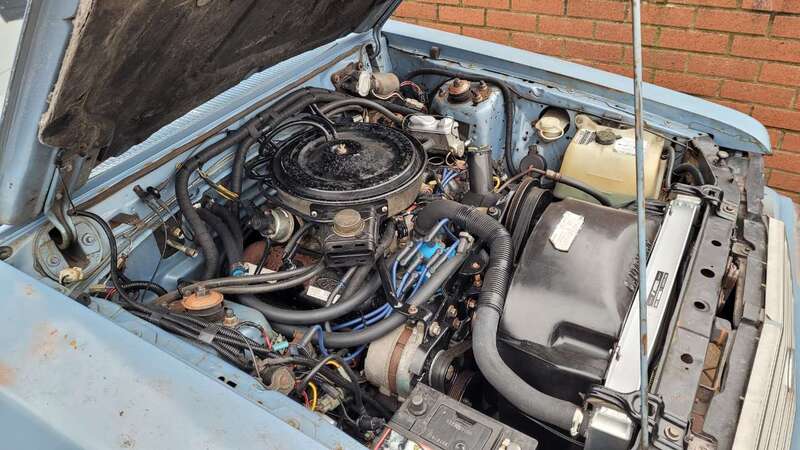

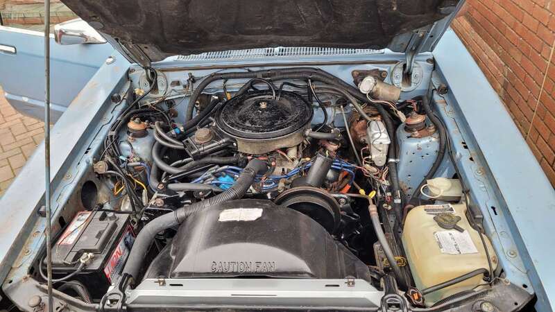

I finished the last few bits in the engine bay & gave it a tidy up. I've got rocker cover gaskets too fit & I was going to paint them but I've decided to rub them down & lacquer them to keep the original look.
20241212_121801.thumb.jpg.4f1a5c3f13ca1c754165bfd920e161ec.jpg20241212_121808.thumb.jpg.c6538f8f1833dc96970b2a65f4bcff30.jpg20241212_121814.thumb.jpg.45970f5b75ba106d771d4ed6b1028cdd.jpg
I've just got to fit my npt fittings to the gearbox, run the lines & make a mount for the remote oil cooler.
That is an impressive gasket for "Home made".  You could have a sideline business there.
Also, I assume the headliner is made entirely of this guy:
