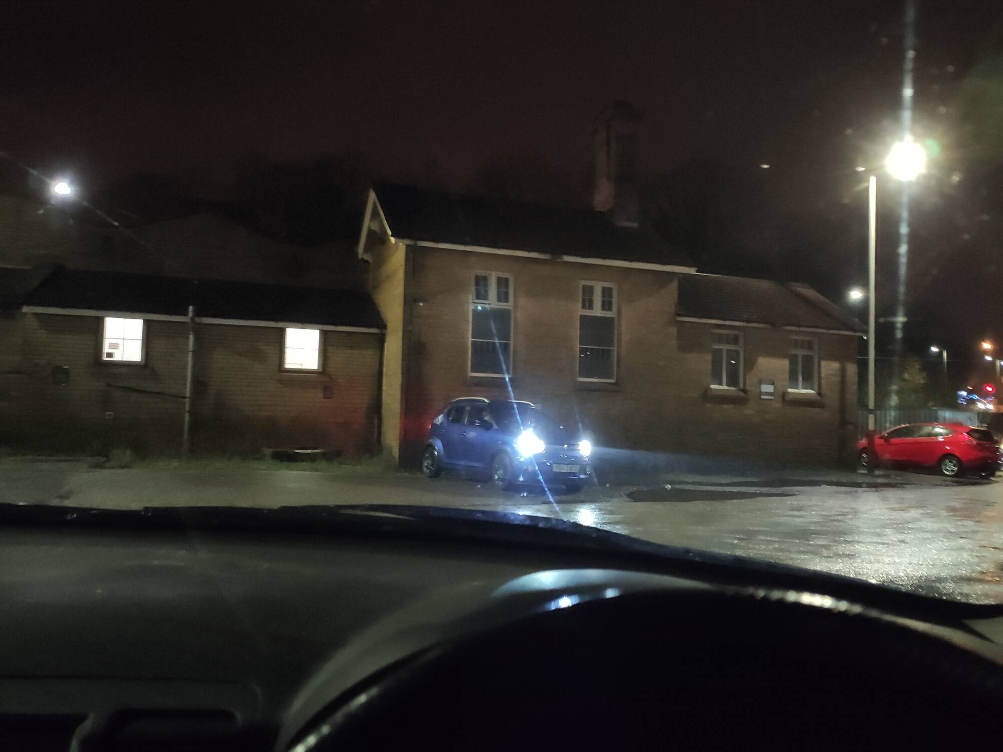

What is it with people parking up with their lights on in car parks. This is obviously an Ignis but BMW owners seem to be worst for it. I see several of them every morning here.
It makes it impossible to park next to them as you can't see shit out of your mirrors.
Drives me mad.

Dogging?
And engine running? Idiots not knowing there are two other options than "Auto" on the light switch.
Probably. I'm not sure why you'd want to sit there with your engine running either, just burning your exploding dinosaur juice.
