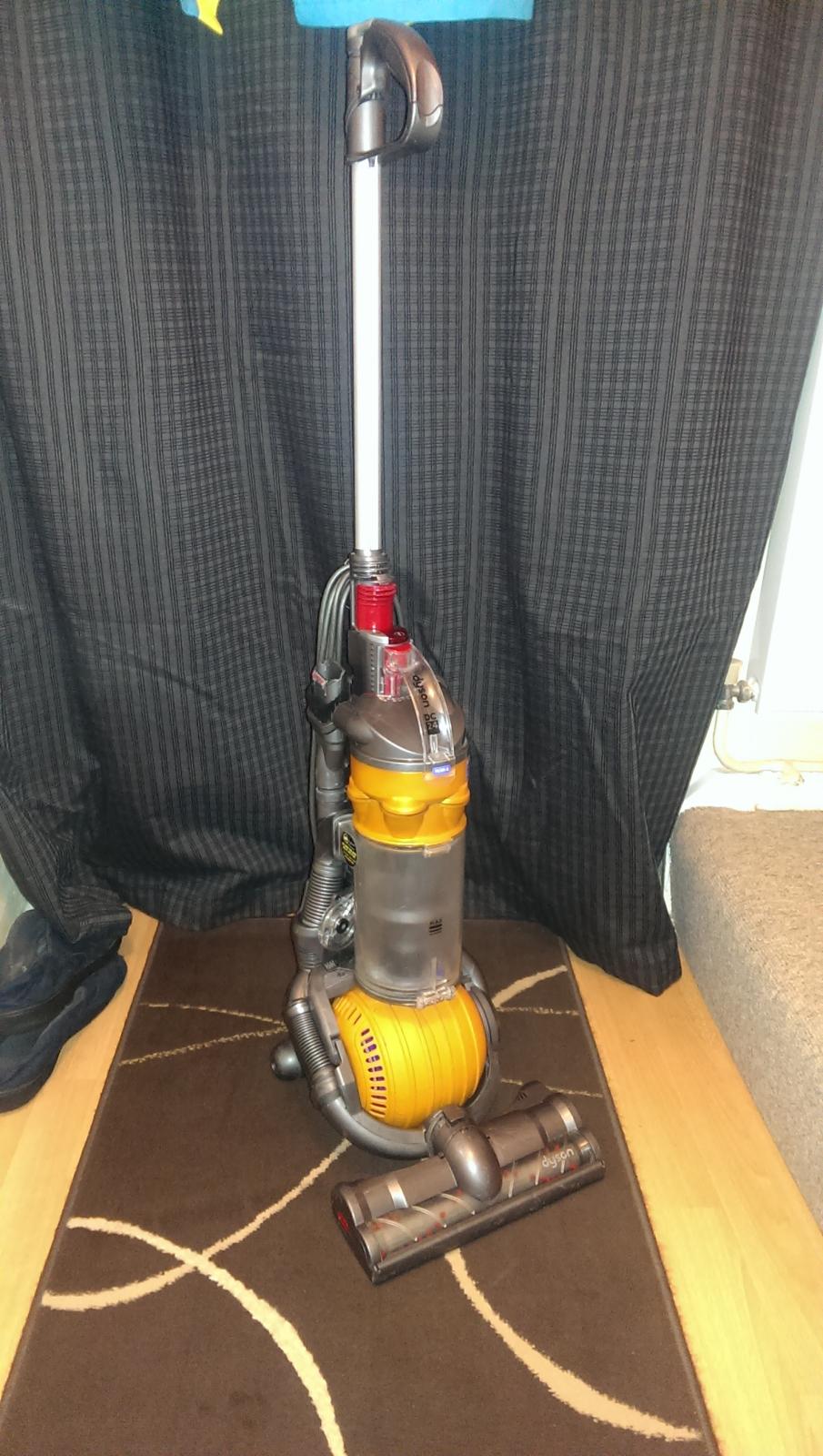

First off, have you pressed the reset switch on the side of the housing whilst the machine is reclined and turned on? Also jab the brushroll on/off switch that sits by the on/off button.
Still nothing? Doesnt surprise me...
Yes, they all do that sir! 67 hours of life according to Johnstone, the makers of the motor!
You'll have to do some troubleshooting unelss you want to just replace the motor...
http://manchestervacs.co.uk/DysonForum/index.php/topic,108.0.html
shows the process very well tbh. It's not too bad, but a bit fiddly.
Once you get the cover off from the tutorial, grab a multimeter. Unplug the motor from the PCB. With the machine reclined to the vacuuming position, and turned on, you want to find 330v DC coming from this black plug
If there's 330v, it's the motor. Available here http://manchestervacs.co.uk/Dyson/DC24-spare-parts.html/DC24-brushbar-johnson-motor-914703-03
If you havent got 330v from the pcb, then you need to swear, then buy either a new pcb first then try the motor, or buy both... http://manchestervacs.co.uk/Dyson/DC24-spare-parts.html/DC24-PCB-Reset-Module-917831-01
99% of the time it's the motor, BUT, I replaced both the main motor and the brushroll motor for a chap the other day (£120 all in including my labour fee!) (PCB was healthy, 330v etc).
3 days after he had it back I get a snotty message, it's stopped. Had blown a contact right off the PCB the bastard. I have a DC24 at the moment to refurb and sell, so nicked the working pcb from that and fitted it. It did this to itself http://manchestervacs.co.uk/DysonForum/index.php/topic,1684.0.html
The pic above was taken JUST NOW as I bought a second hand one from someone to replace it! I;d get a new one though, will last longer and be less of a trip into the unknown (cost me a tenner, but I'm only 40% sure it will actually work tbh)
Then hope it lasts 4 months before it goes again... (I hate the 24).
Once I;ve finished my 24 I have a thread to put up on mvacs so if you need any future help you should find it!
Luckily Mvacs bought 3000 of the motors so got a megabarg with them, were £40ish previously - http://manchestervacs.co.uk/DysonForum/index.php/topic,914.0.html. I've used a few, they are very good (well they would be, their genuine)
I had a DC25 in January with a sparky motor, they do this as well - http://manchestervacs.co.uk/DysonForum/index.php/topic,1599.0.html
The pcb works!
Just need to tweak the changeover valve and refit a spring that holds the bin flap rod in and she's up for sale. Will be on eBay though, with no returns or warranty! Shitters discunt available though if anyone wants it for £70 plus post... Full Cavcraft style warranty given
