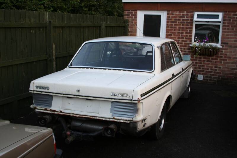

You can see the problems with the rear end on my old one...
Great car, despite its rough appearance! I’d love another one.
18 minutes ago, danthecapriman said:
Once the bumper was removed the rot had started in the seam where the boot floor and rear (number plate) panels join together. Obviously it can’t be seen normally and by the time you can see it it’s probably getting bad where you can’t!
Good shout then, I'll take the rear bumper off and have a look.  From initial screwdrivering I didn't find any rot, but since I'm basically making a new car out of sheet metal anyway I better make sure I don't miss anything 👍
