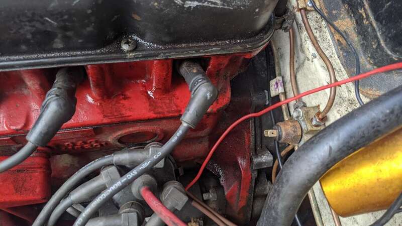

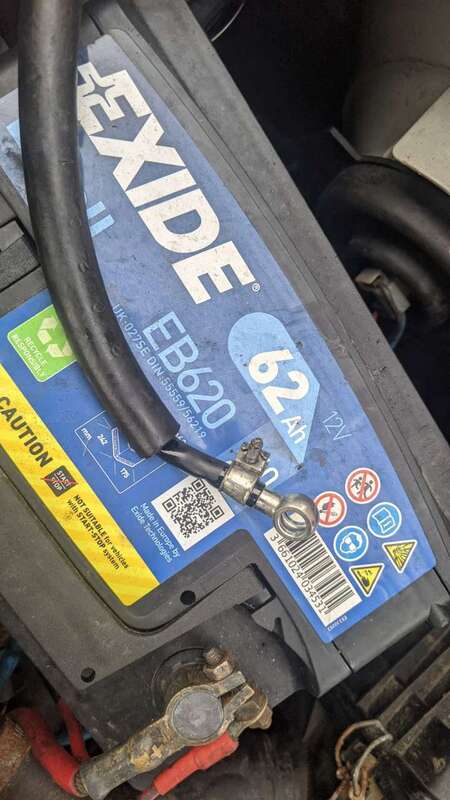

My head has not really been up for much of anything at the moment, but I took some time yesterday to chuck a couple of new earth straps onto the Amazon engine to see if it sorts the electrical fault.
I don't know how much the positioning of earth straps matter as long as they go to a bit of chassis or body, so I have attached one between the alternator bracket and front panel, and between the exhaust manifold and bulkhead.
Interestingly I noticed that where the throttle bar is resting against the stop, there was a bit of wear that looked different from normal mechanical wear, which is perhaps the smoking gun that some arcing has been taking place there.
I did try to take it out a run, but it wasn't for starting. Eventually tracked the problem down to the ignition points gap having closed up so far that it doesn't break contact at all.  I reset the gap, but by that stage I'd drained the battery, so it got plugged in to charge and left where it is.
I tried to remember when I last set the points gap or did any routine maintenance on the igition bits, then realised that I haven't done anything since the car went on the road which coincidentally is about exactly one year ago! So that's a bit of a milestone in itself. Happy birthday.
If the earth straps solve the electrical fault, then I'm down to just two non-urgent things to fix on this car.

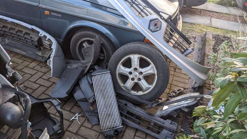

The winter blues have kicked my arse this year and I really couldn't face doing much with the fleet other than just keeping it hanging by a thread and providing basic transport as much as possible.
C70

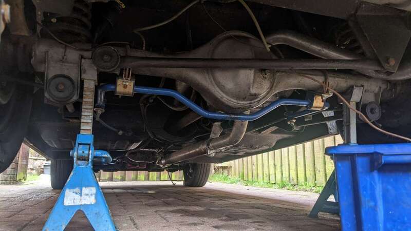

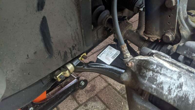

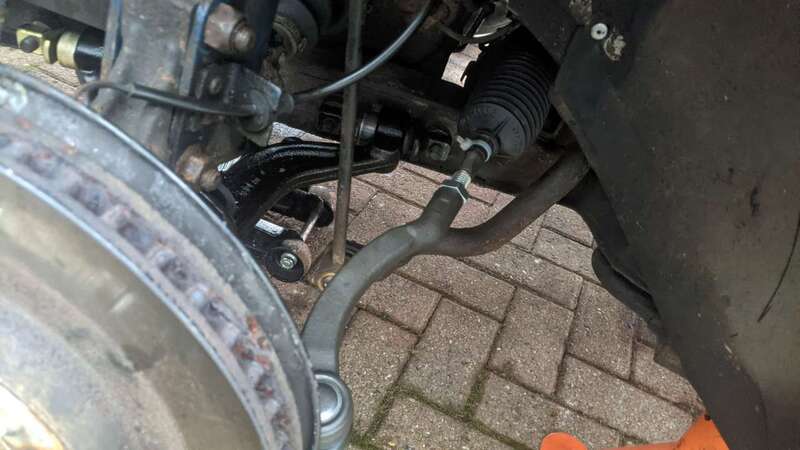

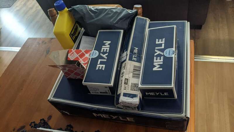

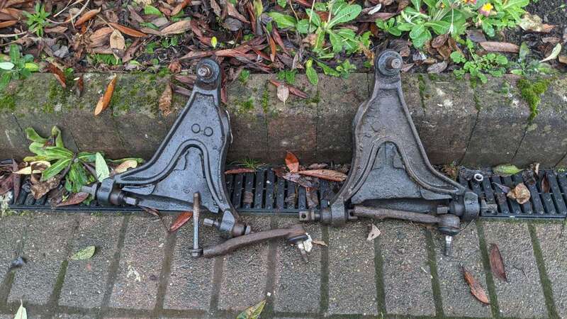

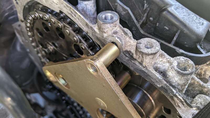

I stopped using the C70 some time in December as the steering started to feel grim, as in steering a rowing boat grim. The previous MOT in February '24 flagged up dodgy wishbone bushes and a track rod end, and nearly a year on from that I realised I'd had my money's worth out of them and it was time to sort it.
Good intentions sat on the shelf for quite some time!
At the weekend @Lacquer Peel offered to help and we got stuck in to it, doing a side each.  With extra hands it really didn't take too long to do both wishbones and inner/outer track rods on both sides.  I'm hugely grateful for the help.
The left side wasn't bad and I don't think it deserved a mention on the MOT at all.  The right side was absolutely humped though.

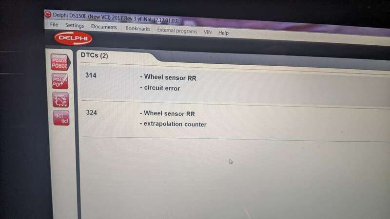

Final problem was to fix this.
On a hunch I jammed a bit of metal down the plug at the side of the ABS ECU and it appears to have gone away. Hooray.
Car drives lovely now and is booked for its MOT tomorrow. Forts and priors.

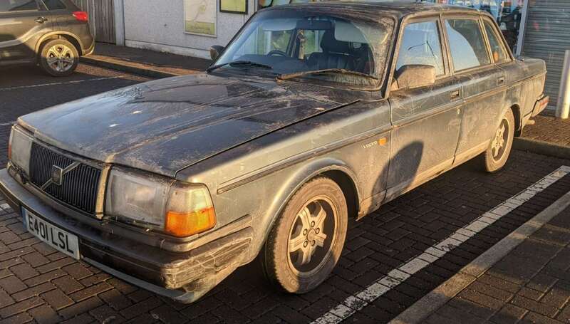

240

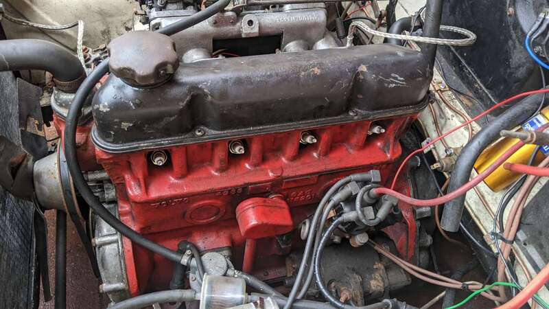

The 240 has been my winter daily since November and has done well enough with my normal 50 miles a day, with mostly niggles and annoyances but has never really caused a major upset.
Biggest pain in the arse is when it sometimes wouldn't run properly from cold, in a totally random manner.  Cue the usual K-Jet headfuckery checking pressures and flows and everything else.  Inexplicably the control pressure would go really high on a cold start causing it to run essentially off-choke lean, which was nice when it was -8C outside.
Sometimes all I'd need to do was wiggle some things and it would instantly run perfectly again. A complete head mincing pain in the arse problem.
Eventually, I tracked it down to a kinked return line off the warmup regulator. Of course, this was hidden right down out of sight and so I would never have noticed unless I decided to DISMANTLE THE WHOLE SYSTEM AGAIN AND FIND IT AT THE VERY END.
Apart from that, it has just been doing usual 240 things, such as the shit fusebox melting the shit modern plastic 'ceramic' fuses for fun, resulting in randomly no heater fan, indicators or lights. Again, nice when it's -8C outside.
A good fusebox cleanup and bending the contacts inwards helped a lot, and most importantly, it never left me stranded.

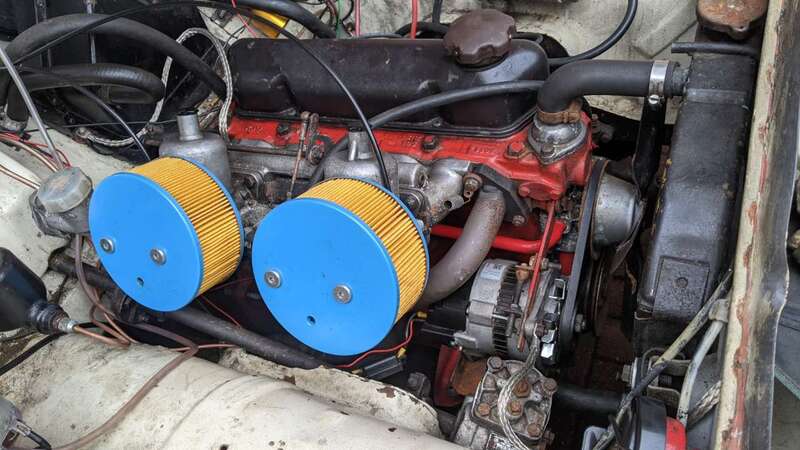

I'd carefully trundled the Amazon to a couple of local car meets in November, but no further than this because rightly or wrongly I had zero faith in the now very crusty looking brake lines. It was here that I noticed the heating had failed and the temperature needle was sitting really low.
Simple enough fix.

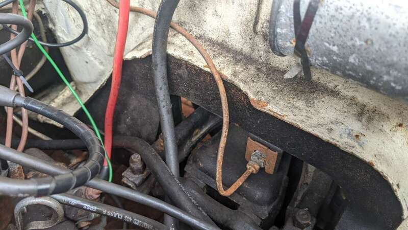

At the same time I fixed the grumpy sounding horn (earth fault) and reset the timing again.  I also managed to find a unicorn tears chrome embellisher for the last remaining unadorned wheel.  I think they look great in black and chrome.
I'm also still amazed at how good the Phosphoric Acid has been at shrugging off rain and salt and keeping the roof and boot lid almost completely rust free despite being uncoated in any way.  The roof looks the same as it did in the summer when I originally treated it.

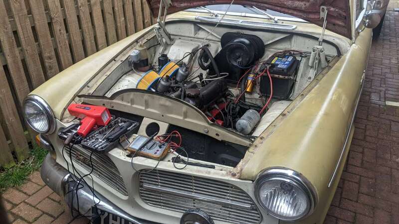

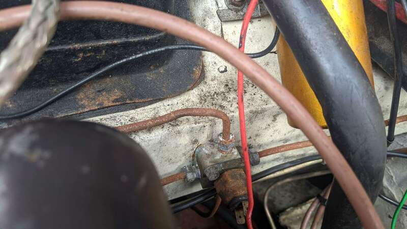

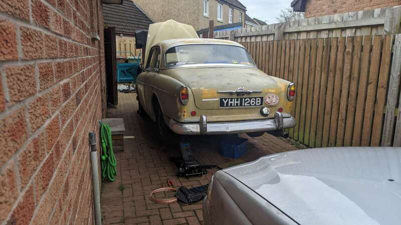

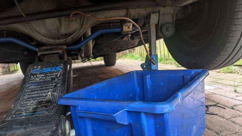

At the weekend since I'd had success with the C70 I finally decided it was time to make a start on replacing the fuzzy brake lines.

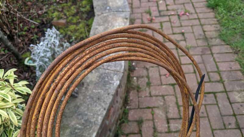

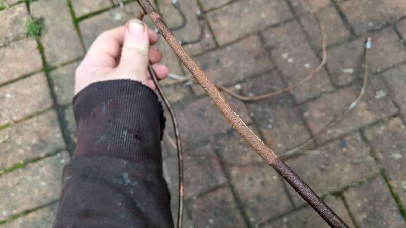

So, bearing in mind that I fitted all these lines from new around a year ago, this is a grim situation to be in.
Now, you may think these don't look too bad, but bear in mind these were sold to me as kunifer pipes, which should never rust this way. Normally oxidisation on kunifer would be a sort of coppery green-blue like you'd see on a penny which is totally harmless.  The reason these freaked me out is that obviously I'd been conned on the pipes, so I was also a bit sceptical of any other specifications they were supposed to have. Given how incredibly crusty they'd gone in a short time I envisaged one of the flares simply popping off.  Not the thing you want to happen on an old car with single circuit brakes.
The decision maker for me was seeing the stuff I had stored in a dry shed corroded badly inside and out. What a load of shit.
So, I dumped the fluid starting from the back axle.
Still really happy with how nice this car looks underneath.
Long underfloor pipe. GRIM!
New pipes made up from Halfords brake line.  I don't want to flare another pipe for a good few decades, thanks.
Just need to finish fitting this lot, fill with fluid and bleed it, and the Amazon can go back to terrorising the neighbourhood.

Never seen fake copper/kunifer line before. Is it just steel with a thin plating over it then!?

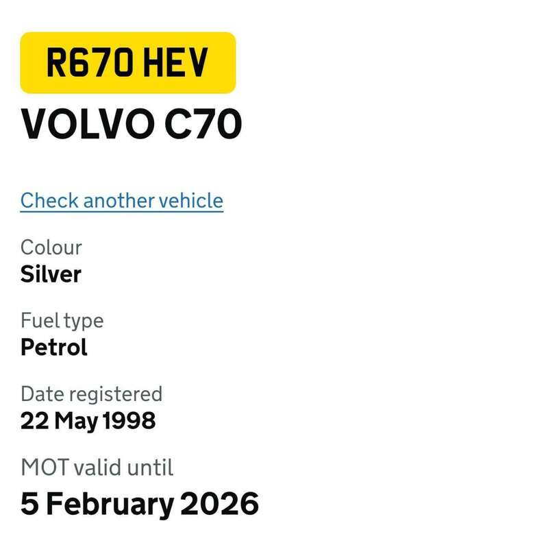

Work on the C70 has paid off. Good old bus!

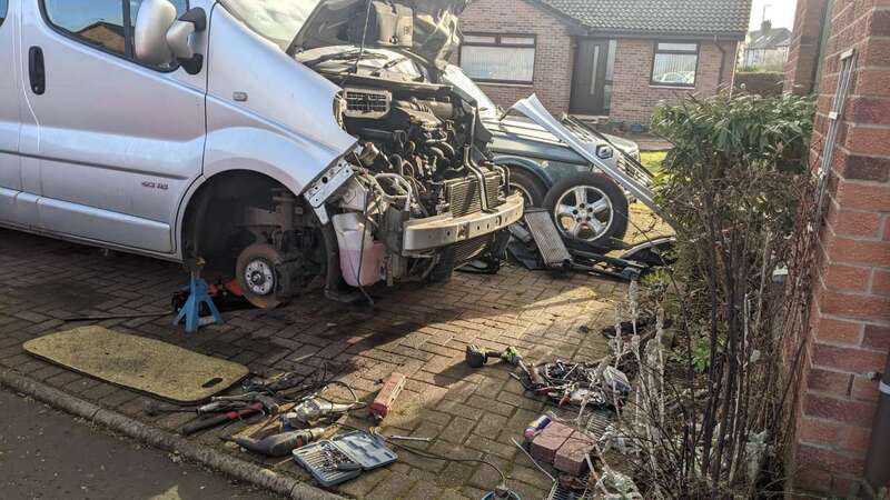

Now I can focus on the Amazon and my Trafic which needs a timing chain that I have been playing roulette on for several years..

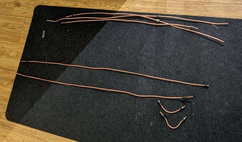

Regarding the Amazon brake lines, I did just find out that Halfords brake line is entirely copper, which I wasn't aware of.  I was told by a garage that it was the best stuff and decent kunifer, so I don't know if this is something which has changed in recent years.
Is there a consensus on whether copper pipes are alright?  Everywhere I look seems to think the world will end and they are highly illegal (they aren't!).
I honestly don't know what it is. It feels stiffer than copper/kunifer but significantly less difficult to flare than stainless. So it may well just be mild steel with a copper plating.   I did notice that when scraped, it goes bright silver and then rusts. So probably just mild steel.
Better than steel, not as good as kunifer.
I think the main issue is from it going brittle if shaking about under a car. But it should all be clipped in place anyway.
I have used copper from Halfords and Kunifer from a decent place near me. I prefer copper to work with as it's softer and easier to flare but my flaring tool is a cheap one.
Just done the CLK and Freeloader steel to Kunifer using this sort of handheld flare tool. Also did the 940 with it.
Also have copper in the shed but find that I can never get it formed off the roll into straight lines for some reason.
Spend £7.89 on a really cheap bendy tool that's ace (can't see it handling 10mm pipe but its OK on 3/16)
This.
Theres nothing wrong with copper brake pipe. I’ve used it for many years. Never once have I ever had or seen it fail unless something has hit it or ripped it off etc. but, it needs to be clipped into place properly, which any brake and fuel lines should be anyway.
Tbh, the kunifer stuff has been made into a much bigger issue than it ever needed to be imho by the motoring press like Practical Classics etc etc. Yes, it’s better than copper, but there’s nothing wrong with copper. If there was you wouldn’t be able to buy it from motor factors in big coils sold specifically for brake line, it’d also be regulated against.
Steel is the one people should be most concerned about given how quickly it can rust through!
  • Agree 2
I guess we need to check any brake pipe we buy with  magnet. Also useful for 316 grade (A4) stainless steel. The A2 is slightly magnetic.
I roll it between a couple of planks and that straightens it out nicely from the roll. Bit trickier if it's been bent a couple of times though.
I've also used copper for years without seeing any issues, but agree that kunifer is arguably a better material.  I think if there was a significant risk to using copper then it would be legislated against.
Got the Amazon brake lines refitted at the weekend.
I decided to stick with the copper lines. I decided it's best to follow the advice of people I know and respect over random internet pearl clutching.  I do try to investigate things properly when I read something may be dangerous, but I also find that 99% of the time it's just people who have never touched a spanner reciting stuff they heard in a pub once.
Since I used the copper lines, I followed the advice to clip them as often as possible by adding in new clip points.
The engine bay really needs a wash after all the effort I put in to making it looking decent last year.
Bleeding this car is easy. A few pumps on the pedal to refill the master cylinder, and then I opened all 4 bleed screws and left it for 20 minutes. When I came back I had a half empty reservoir and 4 puddles on the drive.  Shut the bleed nipples and tested the pedal. Perfect.
Test drive. After being laid up since November I wondered how it would start, but once fuel got back into the carbs it instantly fired up on 4.

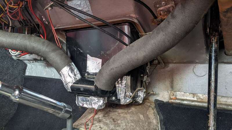

Brakes felt perfect, but I had a real problem with the car steaming up even with the fan on. A reach down into the footwell confirmed that pretty much all of the air was being blown out past dodgy seals in the heater box and onto the floor.
I of course opted to fix this with an OEM seal kit.
While I was furiously taping things I also removed the big plastic front to rear ducting that goes over the transmission tunnel. I think this is for demisting the rear windscreen but in reality it doesn't do much at all and just robs precious power needed to demist the front. I then taped up the vent that fed air to it. Seems to have made a big difference.
A lot of the stuff on t'internet is from the states, for some reason Americans seem firmly wedded to the idea that Nuns and Kittens will die if anything other than steel lines are used.
They are also a bit weird about making up lines by flaring, I once asked a garage in Houston to put in a new section of line for the self-levelling hydraulics on a Mercedes and he looked at me like I'd asked for a go on his wife before vaguely claiming that was dangerous and possibly illegal.
Mine used to leak quite badly from the screen surround (as lots of them do), is your driver's carpet wet? I ended up pulling what passed for carpeting in mine out during winter and just putting a mat onto the bare floorpan and emptying it as necessary.
I also found the heater could boil off the water in about 5 miles... 😛
It did, until I tigersealed the hell out of it 😄
Couple of wee things done to tick off some boxes on the Amazon.
When I fitted the larger front anti roll bar I had to drill a new hole up through the chassis leg. While this works fine I noticed that the bolt looked like it was starting to pull itself into the metal a little bit.
I was just raking around some bits at work that were going in the bin and I found the perfect washers to spread the load a bit.

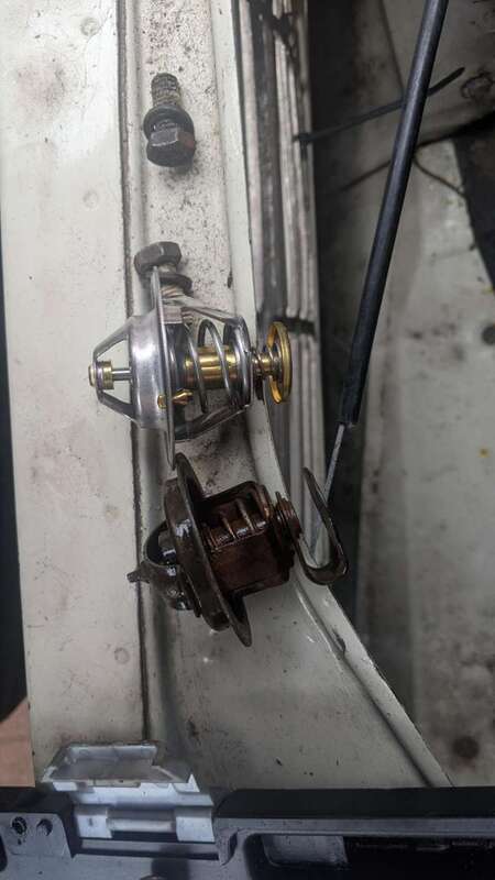

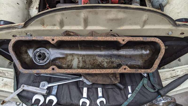

Next up I wanted to sort the oil that was pooling in the spark plug recesses. I made a mess of fitting the valve cover gasket back in October and crushed one of the edges.

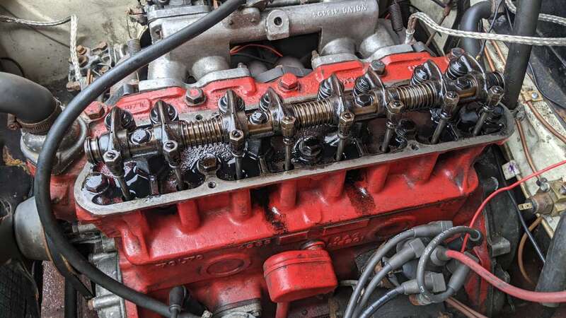

While I was in there I checked the valve clearances which hadn't budged since last time, so it seems I don't have to worry about unleaded fuel damaging the valve seats just yet.
New gasket clipped in properly this time.
Fresh set of spark plugs from a pleasingly NOS package.

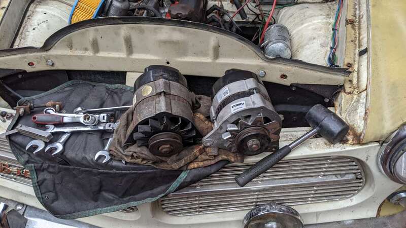

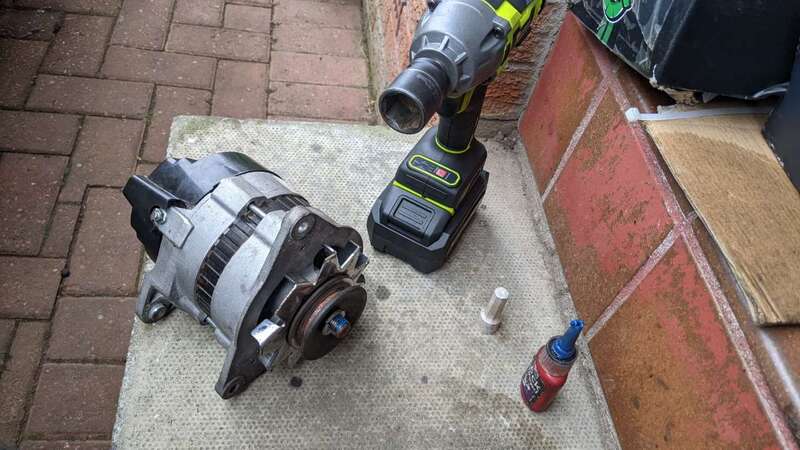

Finally I thought it was time to give @MrsJuular her Toledo alternator back since I'd now fixed the ground fault.
Firstly had to refit the fan and pulley to my one, which needed an impact gun and a dab of thread locker.
Triumph one removed and new one fitted in 10 minutes. Old cars M9.

Time for a guest appearance from my most modern conveyance, just to share my immeasurable pain with you lot.
When I say modern, I always classed it as such but it's now 12 years old which is a bit frightening.

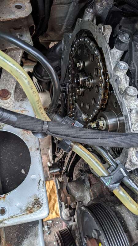

I have been putting off doing the timing chain on my 2013 Trafic campervan for a couple of years now.  I have often read that the magic number for changing these, despite Renault claiming 'fit for life', is around 100k.  It's now on 125k. I also kept getting told 'it'll be fine', but since I intend to keep the van as long as possible I may as well put the effort in and change it, so that I can forget about it and enjoy roadside breakdowns for other different and exciting reasons.

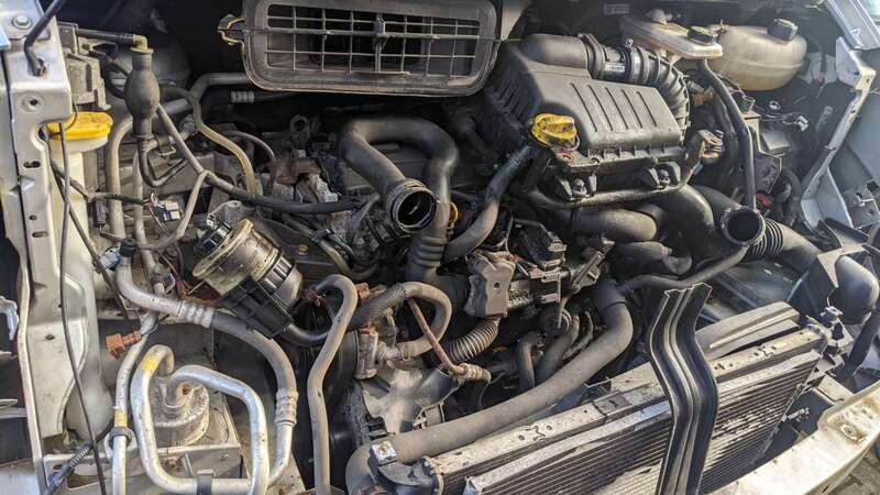

Anyone who has done work on these before will know it's pretty much impossible to do anything other than check the dipstick without removing the entire front end.  Everything is piled vertically into a short letterbox opening.

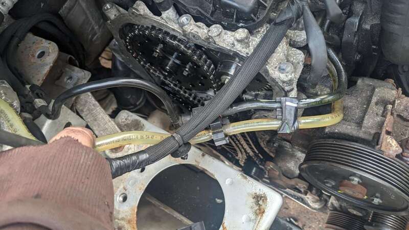

Opening the bonnet and looking at the stuff that needs undone, I got that sinking feeling right away.
I always knew this would be a shit job.  When all of the garages you try to palm it off onto refuse to take the job, you know it's going to be an especially shit job.
It was a shit job.
The sheer amount of stuff that needs to come off is just the first part.
And then you're left staring at this monstrosity.
What the fuck even is that?

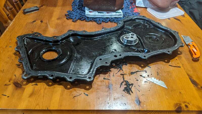

Also, it took me a full day, as in a full 9-5 with barely any time for an enjoyable poo, to get to this point.  Every single bolt goes into an absolutely seized captive nut / spire nut that is held in place by plastic. So as you can imagine as soon as you touch it, it rips through the plastic and just spins in place.  The majority of the day was spent with a drill and a grinder.
Day two was spent removing the crank pulley, drive belt and tensioner, and then moving on to the timing cover.
The timing cover took me a half day to get off because I didn't want to destroy it, and the sealant used by Renault is like cement. I eventually managed it by tapping a steel ruler round the perimeter of the cover which was surprisingly difficult given the access.
Once that's off, access to do the chain is actually alright. I could have removed the diesel pipes but I just worked round them.

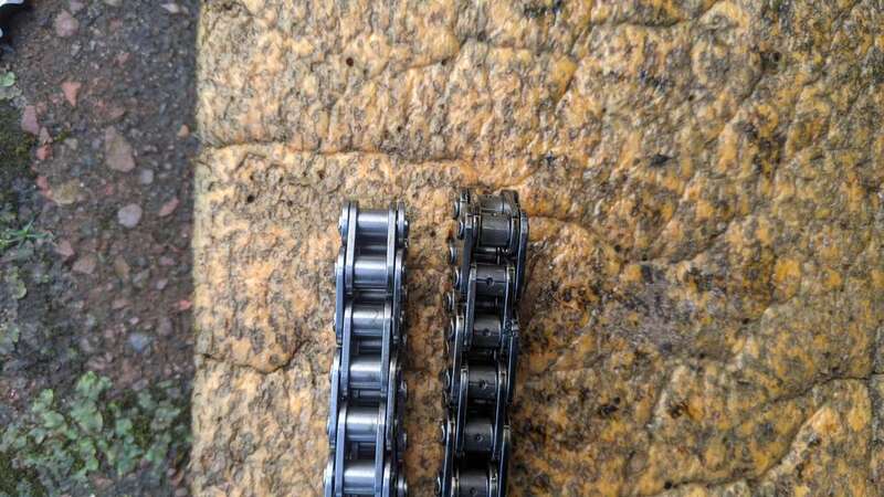

So here is where I'm glad I decided to take this job on rather than listen to the "It'll be fine M7" people.
That's at least 10mm of stretch in the old chain.
I did wonder why the cam sprocket hold down tool didn't fit in the holes properly.

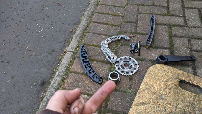

Doing the chain swap itself was a piece of piss especially with the timing tools.  I coated it in a generous amount of chain break-in lube and then an even more generous amount of RTV to seal the timing cover.
With possibly the most clenching I've ever experienced I filled it up and turned the key, and it burst into life in a half turn sounding lovely.
It only took me the majority of a day to refit the front end with various random nuts and bolts and an incredibly large number of cable ties.
At the very least it will be much easier to dismantle next time, as it will mostly involve cutting cable ties.

A couple of random pictures to tag on. Here's proof that the C70 is a hot car.
