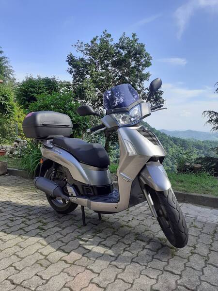

I have decided to try selling my kymco people S 200i. € 890. I hope to get €850. A great scooter but i just don't use it, i enjoy more the buying non runner and tinkering.

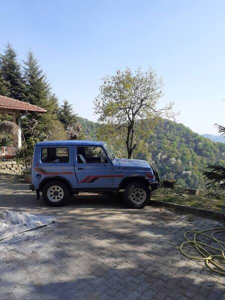

That blue one looks great, and would match my sj410.

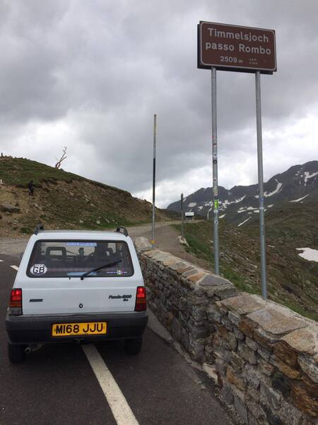

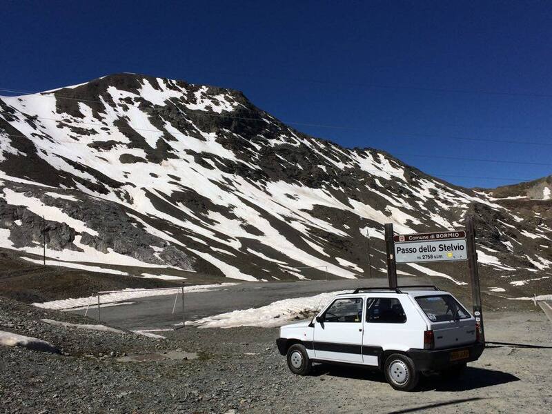

I love mine, done multiple foreign trips over the last 2 years. 1000 fire with SPi.
Been as far as Slovenia, Italy, Austria. Amazingly capable. Even the 2wd Panda 141s are starting to go up in price now.
edit: in the UK climate, they will rust everywhere.
No problems going up mountains either. The 1000 fire is totally fine for all circumstances ?.
Have done Timmelsjoch, Stelvio, Grossglockner, Sustan and lord knows how many others without any bother.
Huge boot with the seats down and will genuinely seat 4 full size adults in surprising comfort. After my first big European trip in it, I came home and sold my MX5 and V8 Jeep as they just felt pointless!
