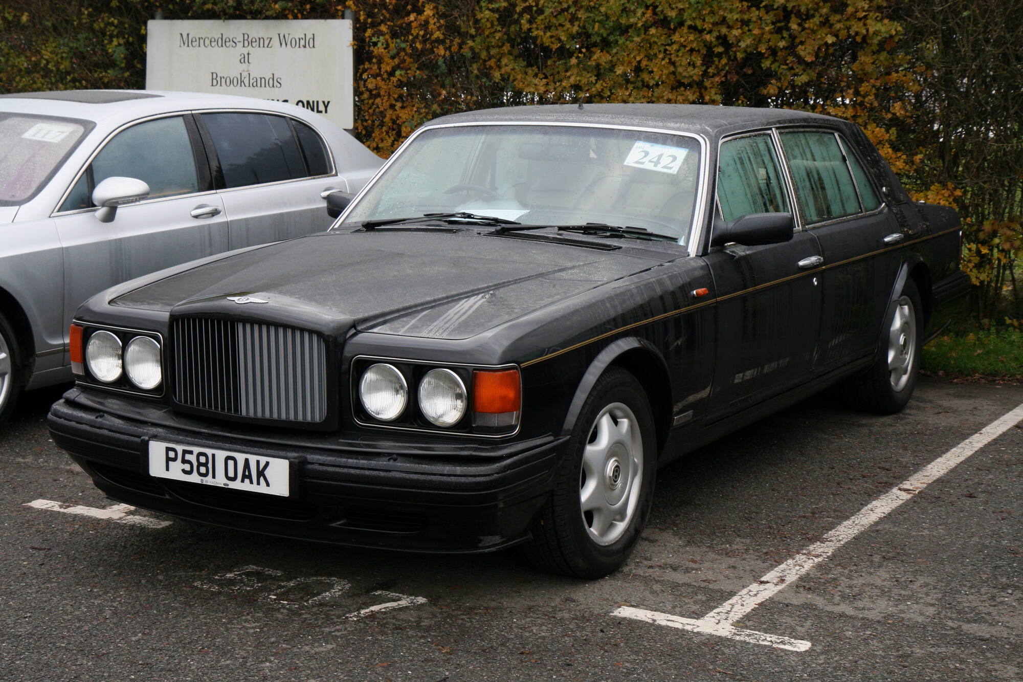

Grotty old Bentley Eight - should I?
As an old Bentley owner, I say
RUN AWAY!
If you heard me say away, you are not running fast enough. For ideas, a set of anti roll bar ends (like drop links), there are 4 of them - £300. That is each!
A set of bump stops - £420
Pair of rear load levelling units £3k plus the shock absorbers, about another £2k nothing is cheap. (these prices are for T2 parts which are normally on a par).
Despite what Panhard65 says, these suck up loads of cash without involving specialists. Parts are more than just expensive! However, I still have mine and think they are worth the expense, but it is impossible to run one cheaply. Secondhand parts are also expensive as most breakers are bought by two big marque specialists who have cornered the market.

Also beware the brakes.  They are NOT servo assisted - like on old Citroens the brake pedal is simply a valve - the braking pressure is provided by an engine driven pump.  If that fails you will have ZERO brakes.
That is a frankly terrifying experience...even in a huge farm yard when we had finally got an old Shadow started for the first time in a couple of decades and decided to see if it would move.
It did...however we had no braking pressure...and I quickly discovered that it was far more willing to go into drive than to come back out again!  It's astonishing how long it can take to find and turn off the ignition!
Plenty of old cars it's fine to limp around the yard before you've done much with the brakes... don't even think about removing the chocks from the wheels of an old Roller or Bentley unless the brake pressure light is out and staying out.
They're utterly gorgeous things, but can bankrupt you like nothing else.  They make looking after a classic Jag like maintaining a Toyota Aygo!
I'd say get a proper look at it and see what they want for it.  If it's cheap enough you could potentially get it, give it a damn good clean, get it actually running, and then if you think it's beyond your abilities potentially shift it on for a bit of profit.  A good wash and some decent photos can get you quite a bit of profit in cases like this sometimes.
I will own one one day (well, a Silver Spirit is my target)... though it still scares the hell out of me!
Find out if its for sale and how much. If really cheap (i.e. sub 2k) then you can't go that much wrong as it'll break easily for that. Then can fuck around in your own time DIY'ing and searching for cheaper but equivalent parts.

I was in Brightwells classic auction in November (and the recent one two weeks ago) and this was there.
Supplied new by Jack Barclay of London in February 1994, this Turbo R is a later fuel-injected model with quad headlamps and desirable floor-change gear shift with Sports mode. Finished in Graphite with magnolia hide upholstery piped in grey, it has heated front seats, rear picnic tables, expensive walnut door cards (a £3,000 option when new), central locking plus all the usual Bentley luxuries that you would expect.
It has had six owners in all, our vendor acquiring it back in 2009 from Royce Sales & Service at a cost of £16,250. Maintained regardless of expense in the current ownership, mainly by RR&B of Bromsgrove, it comes with lots of history from new to warrant the 91,734 miles displayed and was fitted with a new set of Avon Turbospeed tyres in 2014 since when it has only covered around 5,000 miles.
Supplied with its original owner’s handbook and many invoices for upkeep over the years, it also has two sets of keys, remote control radio/CD player, all its original tools and wheel-changing kit, original Bentley umbrella in the boot and an MOT to June 2020 with no advisories recorded. In generally good order throughout, it looks criminally cheap at the modest guide price suggested.
Please note that the private plate shown in the photos is not included and the car has now reverted to its original number, L662 WOT.
Slide 2
Sold for just under £8000 including fees. Was a stunner-good history, immaculate condition. Would I splash £8000 on this? Probably before the latest issues -no, if and when we get through-fucking yes.
