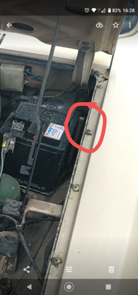

Amazes me how even just fitting a battery is an utter arse on this car. The bolt goes through the inner wing and is entirely inaccessible on the underside when the car is sitting down... Genius!

That's no right. Should be a big tall rod with a threaded end and a hex end so you can screw it into the bracket from the top. Shouldn't need to go under the car
It's obviously had a bolt and nut put in instead.

Looks like it. This one clamps onto the bottom of the battery.
Aye, the clamp is at the bottom. The rod is separate so you can tighten it from above the battery :-)

I am the same and do not have to go under the car to get the battery clamp off.

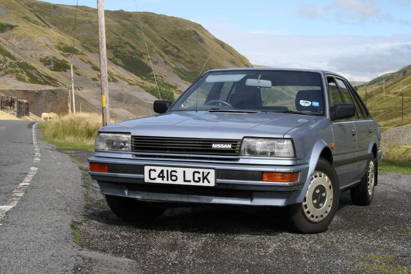

Remember this?
I bought it on this forum, I think from Steve79 about eight years ago. It replaced the shonky MK1 BX estate that was C44 LGK rather amusingly.
The other day, I saw the Bluebird on a recovery truck. I was thrilled, but feared the worst. Happily, the new owner has proudly posted some pictures of his new project on a Facebook group. Very happy!

You certainly did Ian. I remember you coming to collect it in a rather fetching Citroen GS. That Bluebird was a great car and i still miss the little warning bell tinkling to remind you that the lights were on.
I know you were excited about its pantograph wipers 😂
