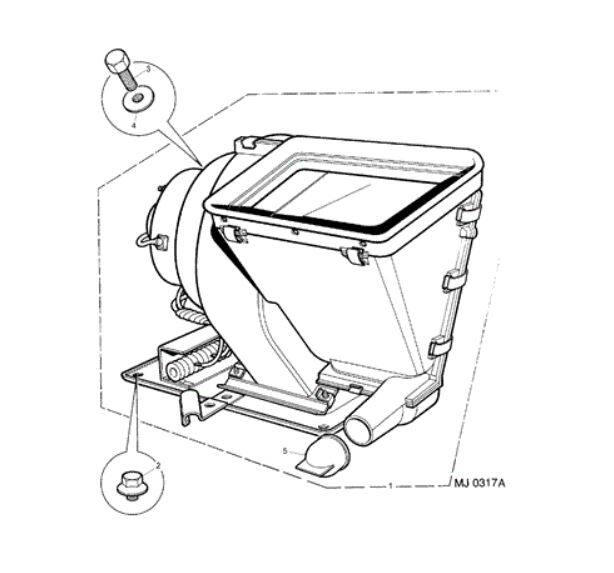

The blower fan only works on speed setting three, I wonder if that's because this Great British Design decided to mount the speed resistor under the bonnet in exposed fashion. No wonder it has rusted...Rimmers want £70 for one!

Can you not just replace the fan resistor?
I had to do it on my MG ZR and it was as cheap as chips!
Indeed! And I've done it on my Mondeo too with an OEM part for less than a tenner....but on the little Metro...
https://rimmerbros.com/Item--i-JGM100090

He said it was £70. That's half a Xsara...
Ouch!
Talk to the guys FB group Metro Owners Club, there is a discussion group and a parts for sale group.

ZR was a fiver.
Will do, thanks. Rimmer's own drawing shows the resistor tucked under a little cover (bottom left), the cover seems absent on mine...

if its just a high power resistor pack
cant you make your own using a set of discrete high power resistors?
(only question would be which resistor values do you get, but you could ask someone to measure a good one, and also the running current/voltage drop across it so you can figure out how much power the resistor is dissipating so you can select the correct power rating for your resistors)
(only question would be which resistor values do you get, but you could ask someone to measure a good one, and also the running current/voltage drop across it so you can figure out how much power the resistor is dissipating)
@Pillock or @cobblers could knock one up in 5 minutes with the values known.
