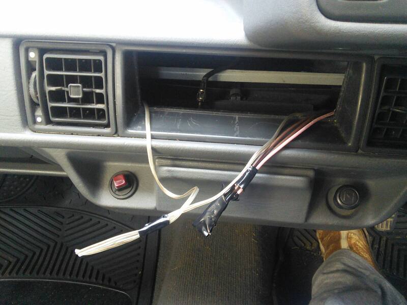

egg Posted March 1, 2020 Author Share Posted March 1, 2020 22 hours ago, Noel Tidybeard said: take a pic of loom and it might jog my memory betterer This is all I've got... Link to comment Share on other sites More sharing options...

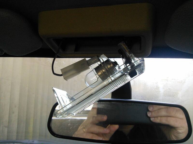

egg Posted March 1, 2020 Author Share Posted March 1, 2020 While the filament looks intact, the interior light bulb isn't working. Of course, one I don't have in stock! Link to comment Share on other sites More sharing options...

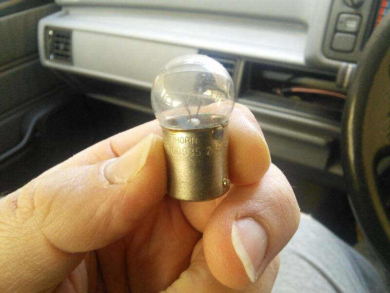

LightBulbFun Posted March 1, 2020 Share Posted March 1, 2020 8 minutes ago, egg said: While the filament looks intact, the interior light bulb isn't working. Of course, one I don't have in stock! Thorn! thats pretty rare, although I have not looked into it in great depth, I have noticed you don't see many Thorn automotive lamps compared to other brands of lamps when comparing lamps of the same age (so between 1976-1991) it would be interesting to see the Date code on it, as by 1991-1992 GE had bought thorn and was doing away with the Thorn brand name (it probably is original to the car) I see some milky white deposits on the bulb which may indicate its gone to air and burnt out, (although if it has gone to air id expect some more deposits then what I currently see in the photo and the filament does not look oxidised) an easy way to test is stick the bulb across a 9V battery like so the Rarity of thorn Automotive lamps is one of the reasons I took this close up shot of one of Dolly's head lamp bulbs as I noticed it still has a faint thorn looking etch on the front and I was trying to see if I could make any details out (Dolly being from November 1976 it COULD be original, but it would be very early for a Thorn branded bulb, although it could also be Atlas branded from before Thorn ditched the atlas brand name, their etches being the same company etc! where very similar on some lamps) (going by the blackening on the bulb wall, it is very well used!) egg, HMC and Craig the Princess 3 Link to comment Share on other sites More sharing options...
Crispian_J_Hotson Posted March 1, 2020 Share Posted March 1, 2020 Those smoll blubs though.... I got sick and tired of scratching around and trying to salvage those and 501 bulbs for years that I eventually bought loads. Bloody things. egg 1 Link to comment Share on other sites More sharing options...
egg Posted March 1, 2020 Author Share Posted March 1, 2020 full markings say: 37R (E11) 00035 245 R10W 12V 10W No go on a 9V. Link to comment Share on other sites More sharing options...
LightBulbFun Posted March 1, 2020 Share Posted March 1, 2020 17 minutes ago, egg said: full markings say: 37R (E11) 00035 245 R10W 12V 10W No go on a 9V. Aww probably means it has burnt out then (good news for you tho, it probably means its not a wiring issue!) hmm its being a bit tricky to date! but my best guess is either 35 Nov 84, or 37 Jan 85 however according to the information I have on hand Thorn Automotive and miniature lamps don't normally use the 2 digit ELMA code but use a number-letter code ie 1A would be January 1981 so, 7R could be it, but R is not valid since the letter is for the month and only goes to M for December (skipping over the letter I) 7 would be 1987 tho Link to comment Share on other sites More sharing options...
High Jetter Posted March 1, 2020 Share Posted March 1, 2020 56 minutes ago, egg said: This is all I've got... The 2 pairs taped together (on the left) will be for speakers. Of the rest, which are permanently live and which are switched live? egg 1 Link to comment Share on other sites More sharing options...
egg Posted March 1, 2020 Author Share Posted March 1, 2020 Thanks, I'll check that out. Link to comment Share on other sites More sharing options...
High Jetter Posted March 1, 2020 Share Posted March 1, 2020 You should also be able to identify the Earth wire if you have a meter, then let us know what you have left egg 1 Link to comment Share on other sites More sharing options...

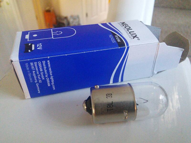

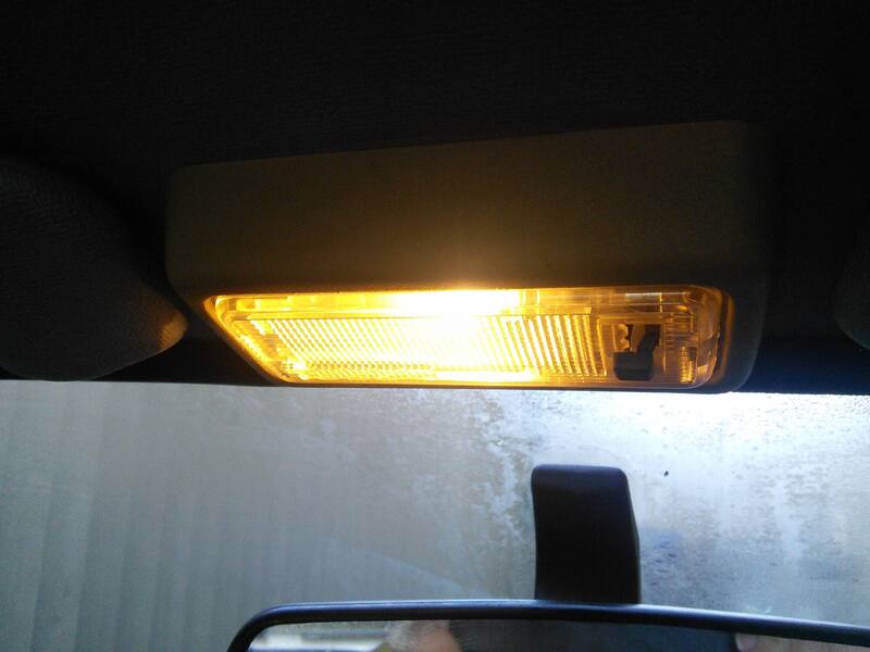

egg Posted March 6, 2020 Author Share Posted March 6, 2020 Distracted from the radio stuff last weekend, I did at least order an interior bulb. seems like carparts4less will do free postage on the tiniest items - so I scored a new one for 16p delivered! Crazy. In she goes.. OK, we have a contact problem as well as a bulb problem. It does light up with some fiddling with the switch in the on position, but nothing in the doors open position (the door jamb switches are a known failure point I believe). Next step a bit of contact cleaner etc if it doesn't actually blow a gale again this weekend. I think the light cover has an Austin Rover sign etched on it, but can't quite make it out. RobT, Burnside, The Moog and 4 others 7 Link to comment Share on other sites More sharing options...

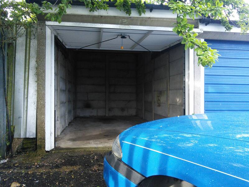

egg Posted April 30, 2020 Author Share Posted April 30, 2020 The dream... Oh look, empty garage, drive the metro over, get it up on axle stands, strip it down and identify the water leak, maybe do the cambelt with some help.... The reality... Drive the metro over, close garage door, forget about it, let MOT run out, scrap it. Dick Longbridge, BlankFrank, Kiltox and 4 others 5 2 Link to comment Share on other sites More sharing options...
