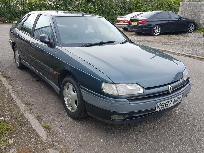

Safrane is having a massive strop and resolutely refuses to crank whatsoever.
The immobilisor light goes out so its recognising the keys but when you go to crank it doesn't do anything apart from the lights goes dim until you release the key.
The general consensus is that:
1: Earth strap corrosion which judging by how badly the brakes are seized could well be a possibility
2: Borked starter which is just as possible.
Also the voice synth isn't outputing any noise. @catsinthewelder i know you said you turned it off. Did you disconnect the speaker?
Apart from this thr car is in good shape. Just disappointed i can't drive it ☹

Not sure about this age but voice synth on many Renaults have a button to disable it.
Tried jump cable on engine block and body, then try starter again? Battery not almost flat is it?
Link to comment
Share on other sites
Lights going dim suggests it's trying to start with the motor is trying to turn over with large amount of current being drawn.
Starter accessible? Might be worth giving it a wallop.

It was definitely cranking yesterday, it started briefly but cut out when I tried to put it in gear.  It's been sat for a while but I left it in park with the hand brake off.  Have you tried charging the battery?  I charged it before I started yesterday then when it wouldn't fire up straight away we connected up to the Focus with jump leads and left them on while we tried.
I think I just pressed a button to shut Mr Cholmondly Warner up, I certainly didn't disconnect anything at the time but one of the speakers from under the dash is in the boot from trying to get the bonnet open last week.

I've left it with the garage at the moment as i'm flat out with work. If it get chance at the weekend then i'm going to chuck the new battery i bought for the saab on it and see what it does.
@SiC good shout ref the battery cable, i'll give it a go.

Mate did say he put a jump pack on there but no dice, zero crank. Hopefully a new battery will sort it. A 75AH is going on it.

About the bonnet not opening: I did have that issue before and replaced the crusty bonnet locks with replacement ones which worked perfectly. I originally had to have a second person pull the bonnet release while pressing down on the bonnet itself to make it pop,  the locks might just need to get greased up again. I can't remember the car having starting issues although the immobeliser might have caused issues in the past, make sure to lock the car first after connecting the battery before unlocking and starting it, otherwise the car thinks you broke into it. Having a properly charged battery or a decent battery jumper is the very first thing you would try though, the battery might just be dead from sitting so long. And yes, there is a button to deactivate the diagnostics voice.

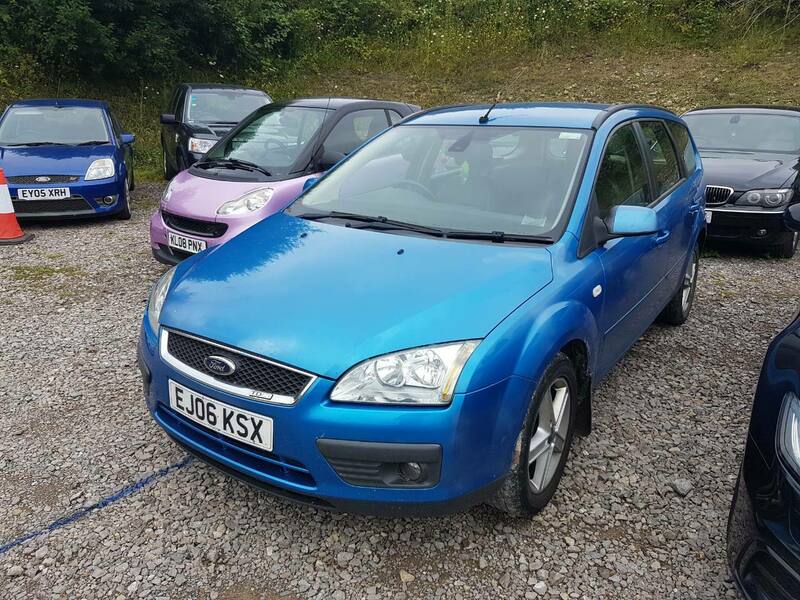

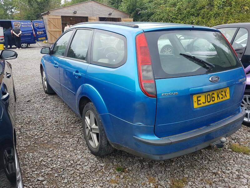

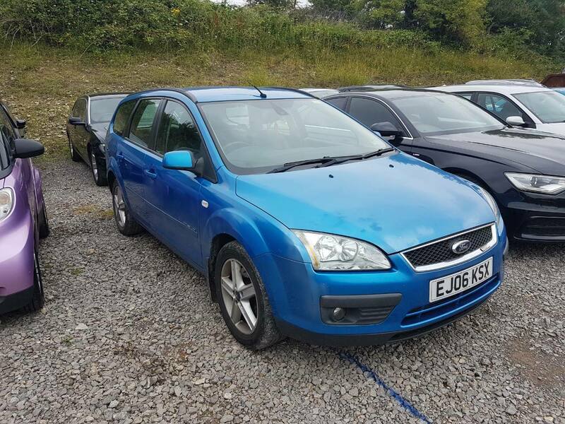

Now this is entirely the dogs fault as i've been going back and forth in my head about selling the saab over the last few weeks trading the speed of the saab for the practicality of an estate.
I'm usually sceptical of any cheap car on  Facebook, let alone from a used car dealer so the journey across town was made with low expectations.
The dealer mostly had 3 year old vehicles on site and i was pleasantly surprised by meeting a car salesman that did not specialise in bullshit and was very upfront and honest.
The car had been driven to bristol from okehampton yesterday for px and was getting punted straight on with no prep as its too old for forecourt.
It's a 2006 Titanium with the 2.0 Tdci, 6-speed manual box and 155k on the clock.
I thought the seats had been replaced with blue ones but it turns out these are original.

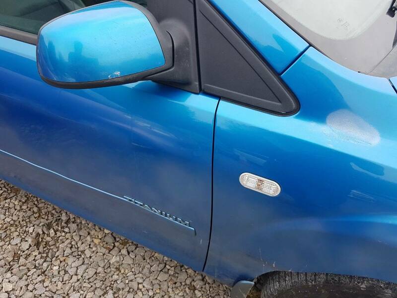

Bodily its a 20 footer and certain areas have had a blow over in the past which haven't been done terribly well.
I was chucked the keys and took it for a blast. It actually drives really well. It pulls through all the gears fine with no noises from the dmf and all the electrical bits are fine.
Aircon, heated front screen, cruise, auto lights and wipers and leccy windows all round.
I couldn't get the bonnet open as the lock mech is missing so that'll need sorting and the mot is out on 1st Sept.
The bonus is that the service book was in the car and is fully stamped up to date.
I reckon it could be made reasonable tidy for minimal outlay and will look 10x better inside once it's been cleaned as its complete filth.
I'm happy playing bargain basement roulette
