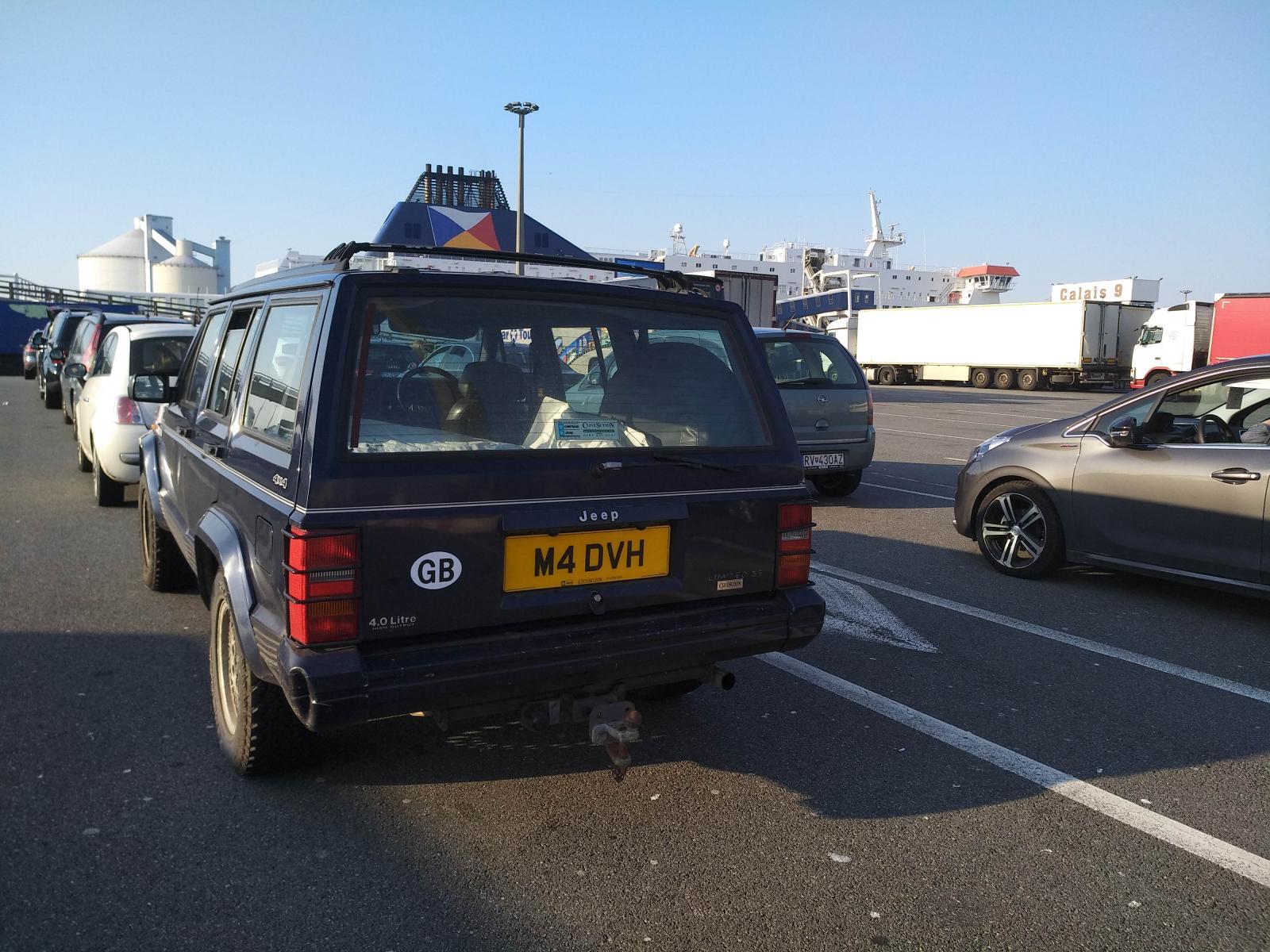

Apologies for the lack of pics, I'm a bit crap at that sort of thing, all I have with the jeep in from the trip is the above Calais ferry and the one below, taken in a Dutch hotel car park:

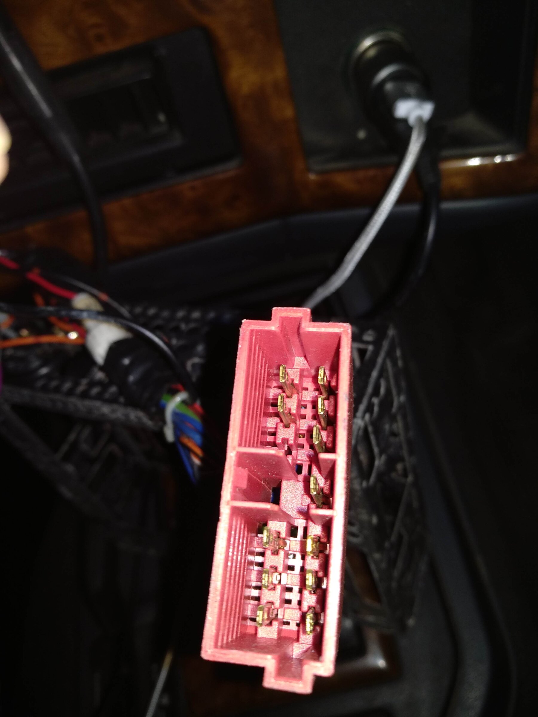

Stereo query, can anyone identify this connector?
This is what's attached to the car to connect to the stereo harness.
IMG_20190506_221319.thumb.jpg.4ec1c9ca46c4f7adc7adea200e146a27.jpg IMG_20190506_221442.thumb.jpg.6f82598e6fb62779c54df28fbfc8870f.jpg?
Is there something I can plug this in to convert to an ISO harness?
I've been lookcing at various Jeep ones and none look like this,
Below is what is butchered to the current Panasonic stereo  (lots of tape and mess not pictured)
I think I'm going to have get the crimps out, remove the current butchery and butcher in a new ISO harness to the above red connector. I've done similar before on other cars, but I'd much prefer a plug and go harness if I can find one.

Today I also changed the stereo:
New stereo … £21 amazon job with aux, USB and Bluetooth:
Not very deep, plenty room to hide cables.
I formulated a plan,:
Print off factory wiring for '94 Jeep stereo.
Compare the factory wiring with the output of the multiplug.
Chop multiplug out of the radio loom.
Wire multi-plug to ISO cable using what I learnt above.
Connect stereo & cross fingers.
And....
Success, I think everything is working, and it sounds pretty good.
I know some will hate how it looks, but I don't find it offensive and it should be better/easier to use than the previous one.
