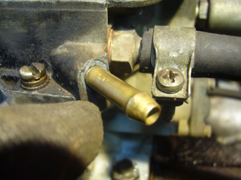

Question re - Samara pissing out pez:
I replaced the badly perished fuel return hose, to find it was still dripping from where the brass penis fits into the carb:
It's slightly loose; it moves in and out (about 1mm) and can be twisted, but it isn't threaded and screwed into the aluminium. Any ideas how these are put together, and how I might stop the leak?

The brass penis is probably a press fit, if you're lucky it may have worked out a bit and might reseal if tapped home, but probably best to yank it out, clean everything up and smear it in JB weld or suchlike decent araldite.
