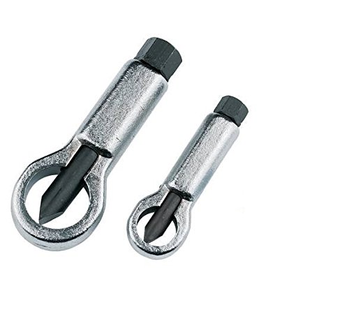

Can anyone recommend a bolt splitter for a 10mm bolt? Cheers.

Do you mean a nut splitter, like these?
The two sizes in a set of nut splitters seem to cover most sizes of nut that you encounter.   The big one would manage a 17mm nut like you'd find on a M10 bolt, and the smaller one will make easy work of a 10mm nut.
I've had decent results from a real cheapo set of nut splitters, and as they all look the same I suspect the difference between cheap sets and expensive ones is going to be in the hardness of the steel and therefore how long they last.   I managed to blunt the bigger one in my set by abusing it (iirc I was trying to split the head of a hardened bolt I hadn't looked at properly) so if you're at all likely to do something like that I'd start with a cheap set and see how long they last.
Yeah, they seem to come at all prices and qualities. I need to remove two rusted M6 bolts from the exhaust manifold heat shield. As I don't have heat as an option or any kind of metal cutting device, I thought this might be worth a try.

If they're bolts rather than nuts, then nut splitters won't do the job - a sharp chisel and a big hammer would probably be a better choice, or (if there's sufficient access) even the world's cheapest angle grinder would make quick work of a M6 bolt.   Grinders are useful and versatile (but dangerous) tools to have and well worth the money.
Thanks, access to the lower one is pretty tight due to the radiator.
I might get one of these type of hack saws and slowly saw 'em off!  Conventional hack saw has access issues too.
I bought a pair of Toolstation's finest nut splitters for 6 quid or whatever they are a few weeks ago. They weren't advertised as such on the website but came in a Silverline branded packet. I thought the thread seemed a bit rough when I got it the larger one out so prior to use I wound it all the way out and greased it. It then made short work of the job I'd bought it for, a track rod end Nyloc nut. So I'd be inclined to give the cheap ones a go.
Hope you have plenty of patience, as I suspect using a saw like that might take a little while and test it rather severely.
I have an electric reciprocating saw which is quite good for that kind of job because you can get hacksaw blades for it that are flexible and quite long.  As long as you can get the blade into the space with a bit of pressure in the right direction, you just pull the trigger and wait for something to go clonk or the blade to jam and bend (either of which usually indicates some degree of success).   Mine cost £60 or so, but I've had it years and it has come in useful for all kinds of jobs on the house and car that would be a proper pita without it.

Don't know if anyone's suggested it egg but a imperial socket that's just a fraction smaller than the head hammered on over it.
Good idea, however the only imperial set I've got is my dad's precious* favourite set on loan, so better not!
