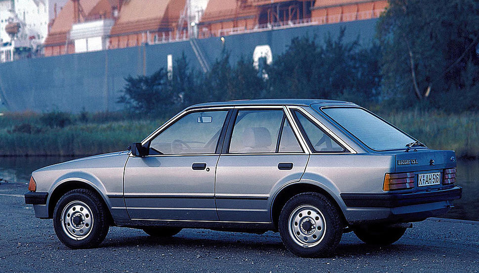

egg Posted May 11, 2018 Posted May 11, 2018 Are square UK number plates legal on UK market Japanese cars.... i.e. could I replace the normal plate to look like below? 2ndly, would it look crap?

DodgeRover Posted May 11, 2018 Posted May 11, 2018 Are square UK number plates legal on UK market Japanese cars.... i.e. could I replace the normal plate to look like below? 2ndly, would it look crap? Yes you can use a legal motorcycle size plate if it's an import and fitting a full sized one would be impractical. egg 1

egg Posted May 11, 2018 Posted May 11, 2018 Yes you can use a legal motorcycle size plate if it's an import and fitting a full sized one would be impractical. But if a UK car from new, I guess not?

warren t claim Posted May 11, 2018 Author Posted May 11, 2018 Are square UK number plates legal on UK market Japanese cars.... i.e. could I replace the normal plate to look like below? 2ndly, would it look crap? I run a square rear number plate on the rear of my Mk4 Mondeo estate with the full blessing of the law. egg 1
Guest Hooli Posted May 12, 2018 Posted May 12, 2018 I thought the rules were for the character sizes rather than the plate. You have to have set size (& obviously correct font) characters with a minimum border width. Hence plates with less characters can be smaller than a normal plate but still legal. I do agree though that some imports are allowed motorbike sized characters. Eddie Honda and Ghosty 2
