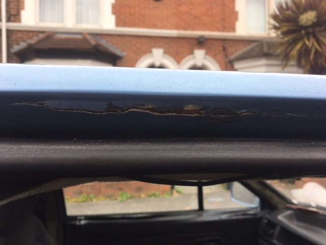

A little while ago I was keen on a factory built fibreglass car with a galvanised spaceframe chassis, about 25 years old. This was 300 miles away so after a bit of to and froing I asked the seller to sent pics of the worst bits, none bothered me except this one. It was sent with no explanation, I took it to show the rotten roof frame bursting through the fibreglass above the drivers door seal.
Team thoughts please? Did I read it wrong, is it just a cosmetic problem?  Sorry for the vague details but I wouldn't like some perhaps wrong internet speculation to kill the sale of a strangers car.
That looks to be exactly what you think. Frame rusting, swelling and bursting through the fibreglass.
