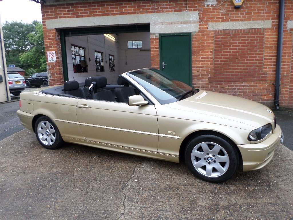

Thought you guys may have a rough idea of the value of this since my mate is looking to offload it:
BMW 320I (Petrol) with 2.2 M54 engine, 5 speed manual box.
2004 04 plate
90,000 miles
1 elderly owner prior to him from brand new, even has plastic spare key and 2x remote fobs, original dealer plates, sticker, tax disc holder, original tool kit still present and unused, very original car.
2 new non rusty wings (non genuine)
2x new front springs
12 months MOT or it will have when its being sold.
Grey Green Metallic in colour
Full cream leather interior with wood trim, wood effect gear knob, steering wheel etc.
Its a strange spec because its not an M Sport, has cream interior, standard alloys, and isnt a sporty colour but has factory optional extra M Aerodynamic bumpers package.
Spec includes: Dynamic stability control, front fogs, onboard computer, BMW business radio with 6 disc changer, auto air con, park distance control, front armrest, automatic dip interior mirror, first aid kit & warning triangle, 16" alloys, model badging factory delete, sports leather MFSW.
Its got a couple of rust spots (wings were really bad but were changed for aftermarket ones which have no rust and are a good colour match)
Reg is SB04XLZ.
Is it worth £1200?
Sounds like it is on paper.
Seems to be £1200-1500 for a 320 in similar age/condition on Auto Trader.
My mate thought he would get laughed at if he tried selling it for £750, I was convinced it was worth more, but thought id ask the experts here for a true valuation because the prices things are advertised at on ebay/gumtree usually dont have any relevance to their true worth.
Quick sale, £750, if he is prepared to wait a bit, possibly haggle with a buyer and can present the car nicely in pics and words I'd say stick it up for £1350 but expect £1100/£1000.

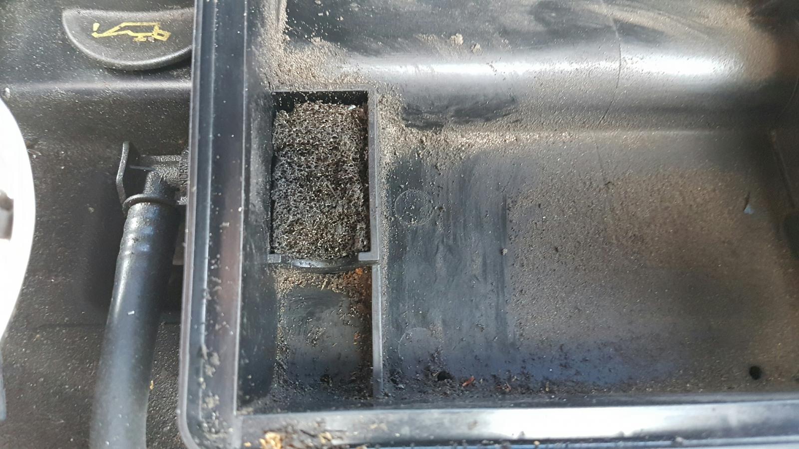

Three things the 55 Fiesta ST is revving up (goes from 1500 to 2000) when you press the clutch slowing down to stop. Any idea why?

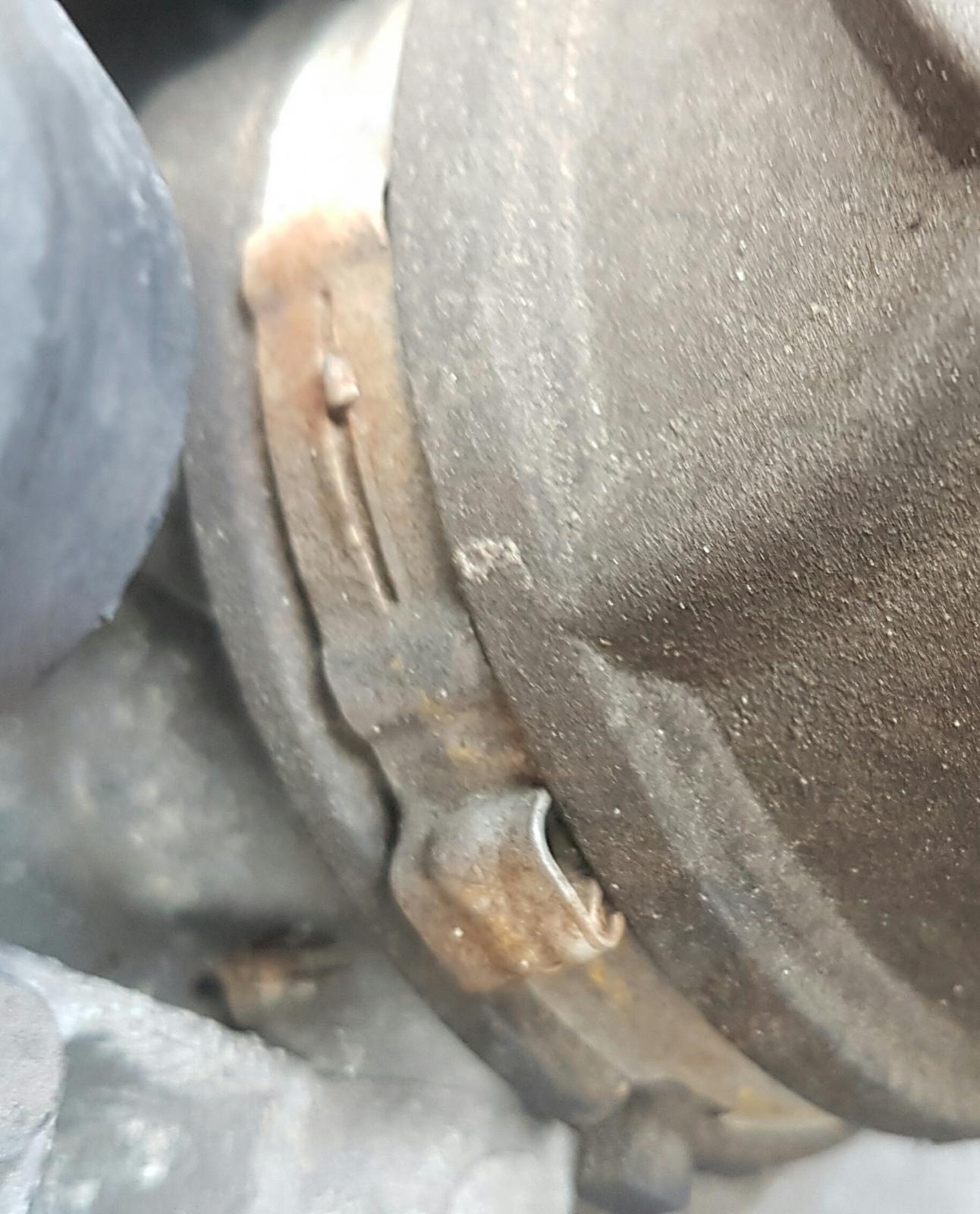

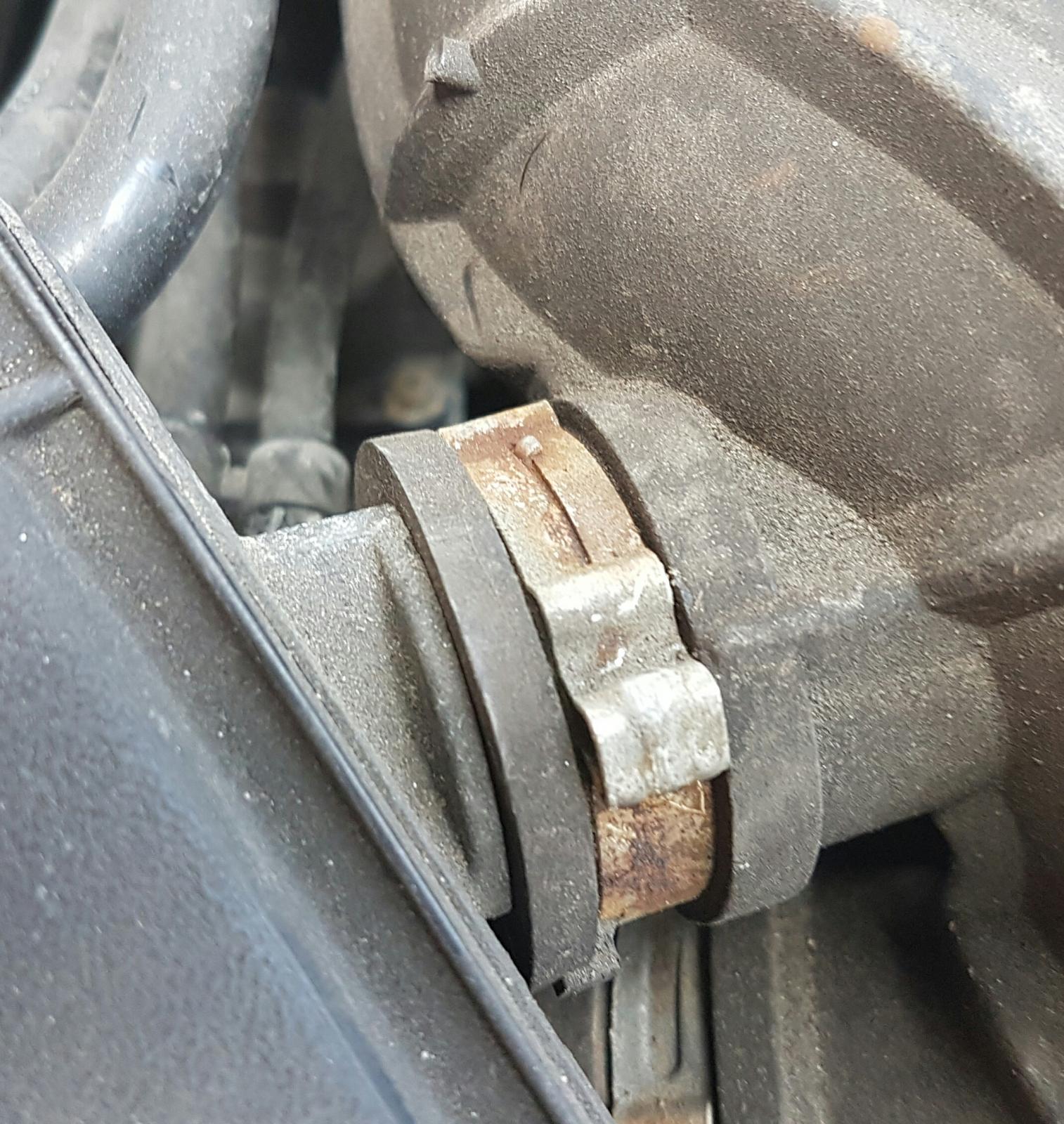

As im trying to take the bits apart to see if something just needs a clean I can't, how do you take these clips apart?
This little sponge under the air filter is falling apart, what can I replace it with?
My bet on the reving up would be a damaged rubber hose on the intake side which opens up with engine movement. The second photo showing the clip, insert screwdriver and twist and it should pop off however unless you have the special tool it will never go back on; best replaced with a standard jubillee clip.

Thanks I'll get some jubilee clips ordered. I think it's to do with that split hose too and then crap getting into something.
Tried to get the hose before but Ford only do it as a giant chunk of plastic that costs a fortune.
You can flip those clips open with an electrical ( small ) screwdriver and re clip them with a pair of pincers .
Oh and the foam is a breather filter and decent air filters come with a new one included .
Opened it with a screwdriver but I couldn't find the right pliers so I've left it undone. The other end was only a cable tie which I had to break.
