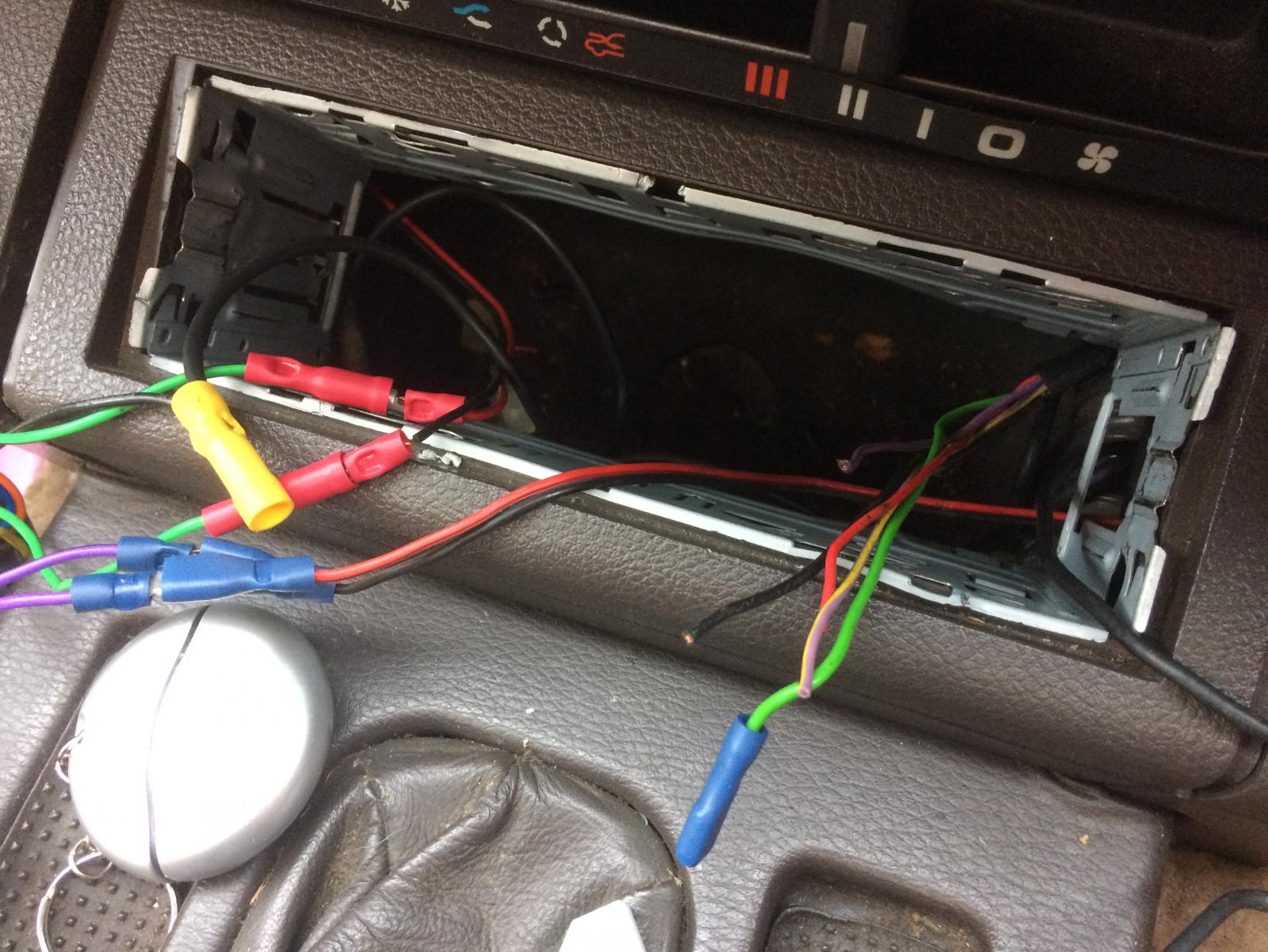

Anyone know or have superior (Google-fu) the radio wiring colours for a 1994 Range Rover Classic (Vogue SE) with factory rear sub?
I seem to have Purple/White Purple/Yellow Green and Red (I reckon Black is earth) Done a bit of a Google, even found a 1986 workshop manual with a wiring diagram but colours are nothing like.
I reckon and could well be wrong that the purple ones with different colours are speakers, red is power (switched?) green is power (not switched) and the black is earth. Check with a multi meter before you take my word for ANYTHING!
Thanks - I can't be wrong cos I don't have a clue :) (except guessing about earth).  One of them is one I accidentally disconnected whilst removing the radio :( - that was perm live but I don't know which - maybe the green then.  I could check with a meter, but that won't confirm which if any are speakers.

Stereo wiring. Use a meter to check the lives and earth, then use an AA battery to check the speakers. Touch a pair of wires to plus and minus on the battery should give a click/thump from the speaker.
