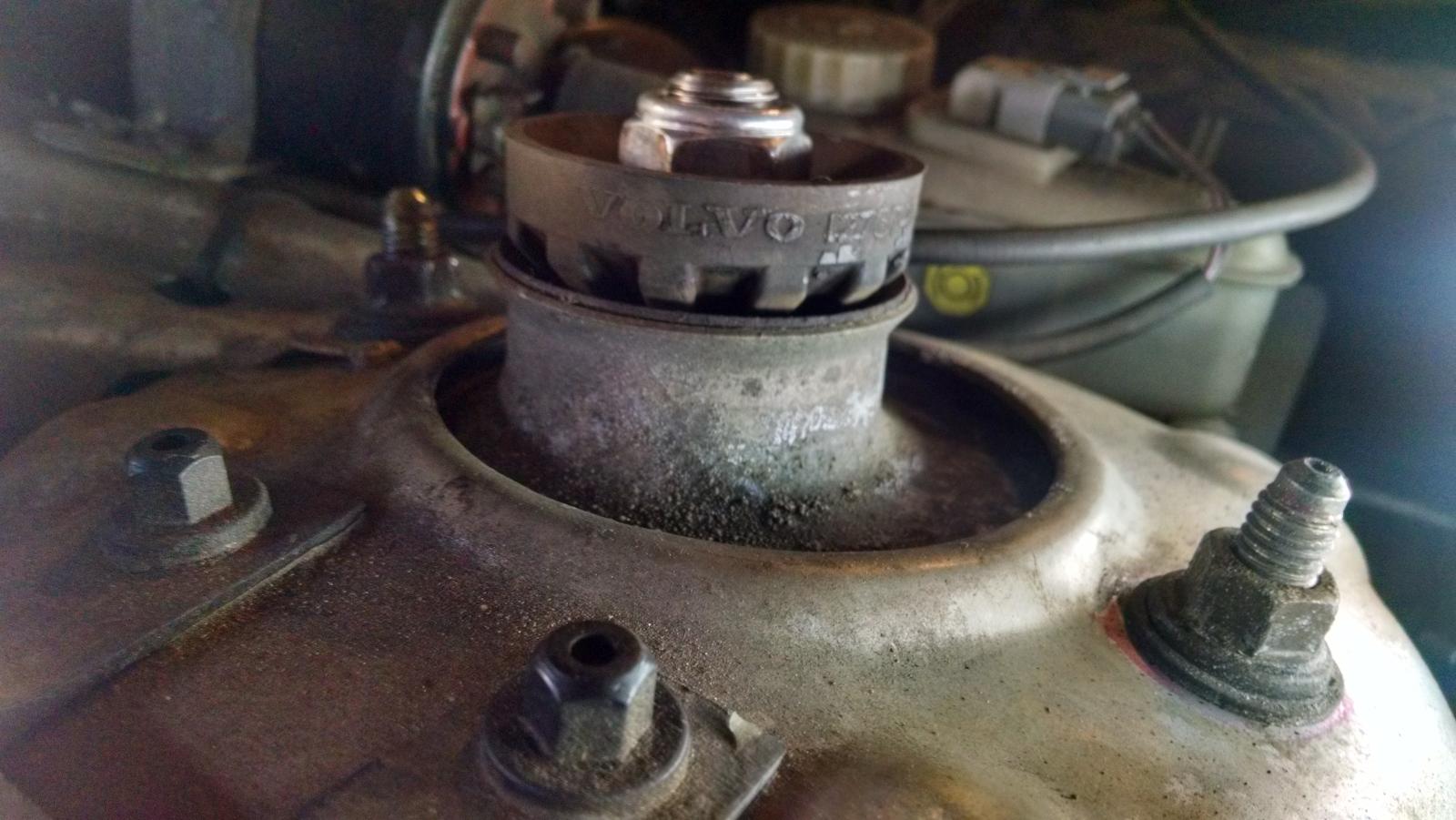

New shock fitted and after 100 miles I now have about 5mm vertical play here:
There appears to be no horizontal movement, just vertical.
The but is tight and the top mount and stuff seemed OK when it was all apart.
Stumped unless it has just shit itself!

The volvo strut mount - is the same amount of thread showing on both sides?
Both sides have the same amount of thread.
I have stripped it all back down and just about finished reassembly.
Is the loctite for the big securing nut holding the shock insert in? If it is I have done it up very tight but no loctite.
Edit now read the above on a screen larger than a matchbox so now understand the loctite was not for me!
I ought to have my Weetabix then. It came out when the fitter started winding it out on the ramp, perhaps the bit of Loctite will sort it out.
