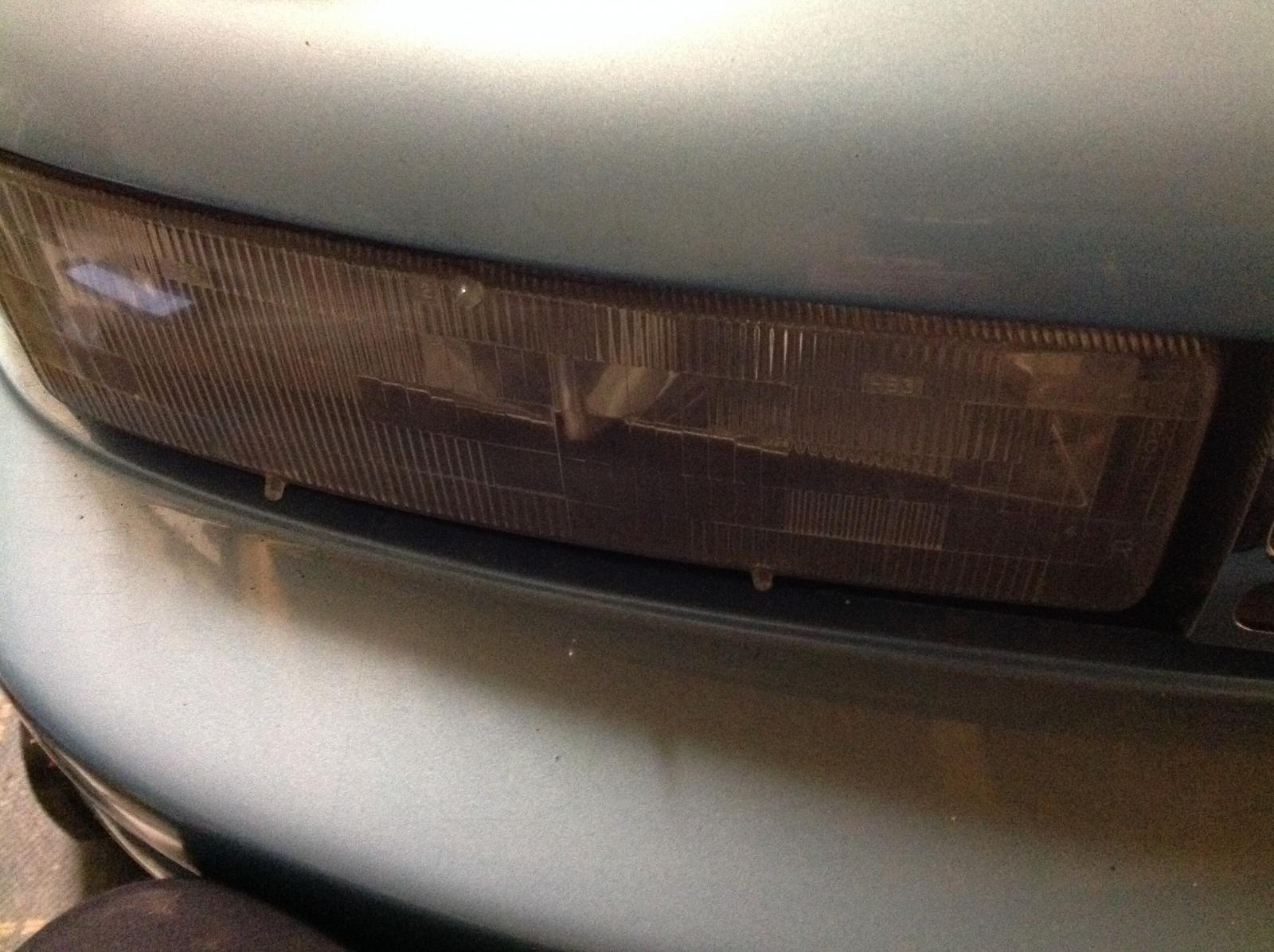

What are these nubbins for and why? On the headlight lens of the Oldsmobile. Three nipples on each. Is it to do with injection moulding? If so why are they not trimmed off? Not important obv. Just wondering?
Most likely to locate the headlight lens moulding exactly in the tool that assembles it to the headlamp shell. If it didn't have those features it would be harder to accurately hold it because it is a smooth and awkwardly shaped thing.
the three bumps are for alignment - US spec machines clamp to the headight and project a laser or use spirit bubbles where ours stand in front of the car and measure the beam itself.
