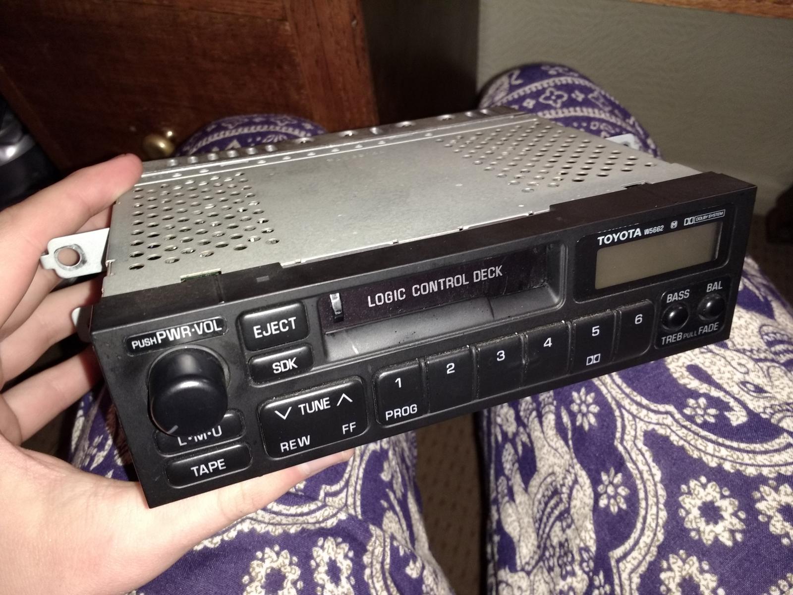

I took the corrosion's stereo out as I want to plug in an aux lead so I can play my iPod through it.
At the back there is a 13 pin C-bus DIN socket which I can plug in an aux cable... but I find this odd as the car is a 1991 model, and predates CD autochangers (this type of connection is what Kenwood units have). If I plug a cable in, will I get my ipod music or is it not worth the hassle?
If you plug-in via an aux input the stereo would output the sound but you would have to still use your phone's touchscreen controls.

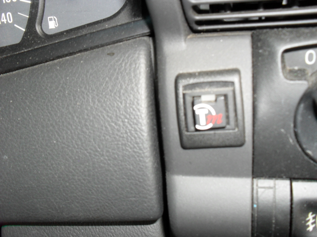

Can anybody identify this 'TM' logo please? I have just got my newly purchased Omega back from the garage and whilst trying all the knobs and switches I discovered this mystery one. I am thinking some sort of aftermarket sat-nav but nothing happens when I press it. Any info greatly appreciated,thanks.
old TrafficMaster system.
It needed a subscription and would blurt out updates on traffic jams in your area through the speakers.
Defunct now.
Traffic Master . It's supposed to warn you of nearby traffic issues. I think it used those blue cameras you see on trunk roads.
It was a subscription service and I'm not sure if you can still subscribe. I killed it in both the cars I've had with it.

Thanks very much for the info.
