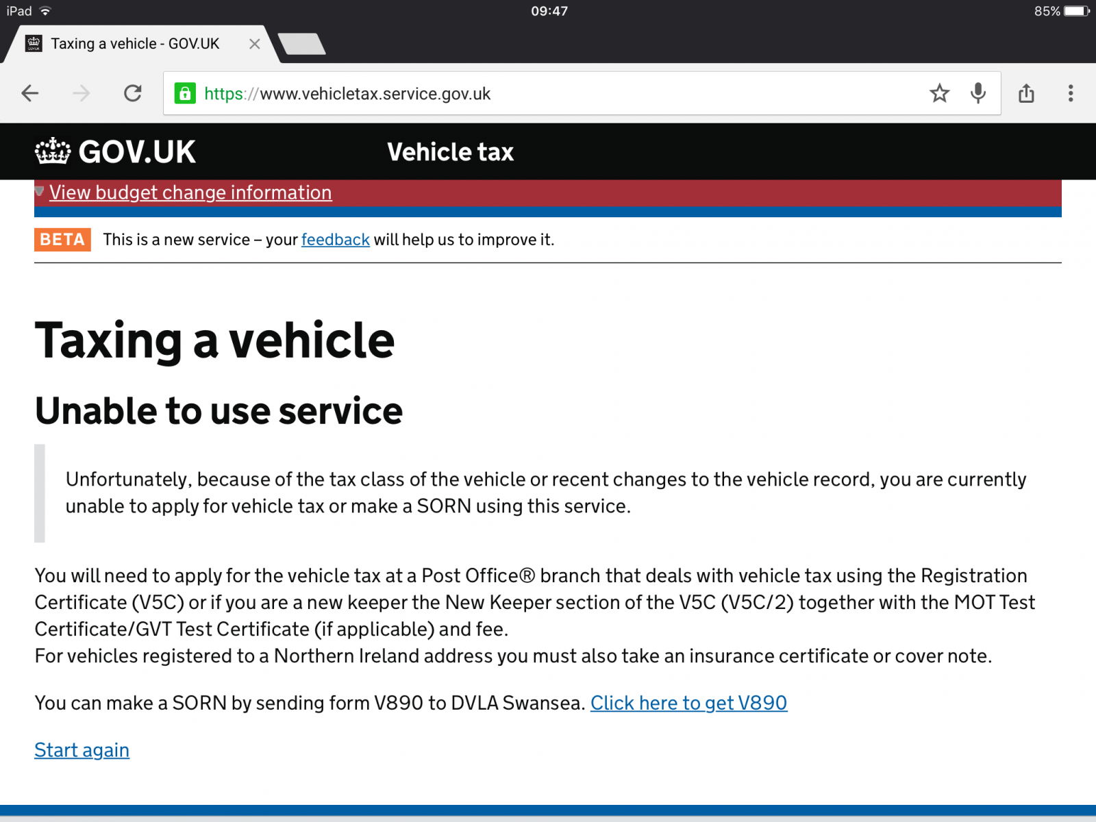

Kiltox Posted April 14, 2016 Posted April 14, 2016 How long ago did you buy it? Are you a new keeper with a green slip?
