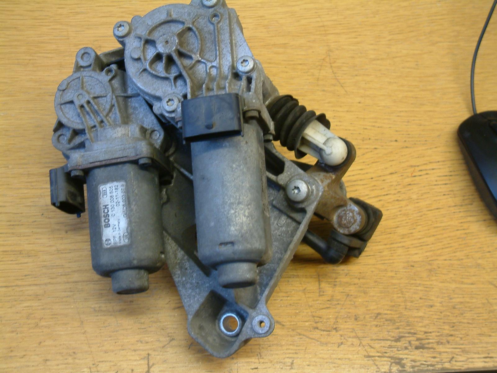

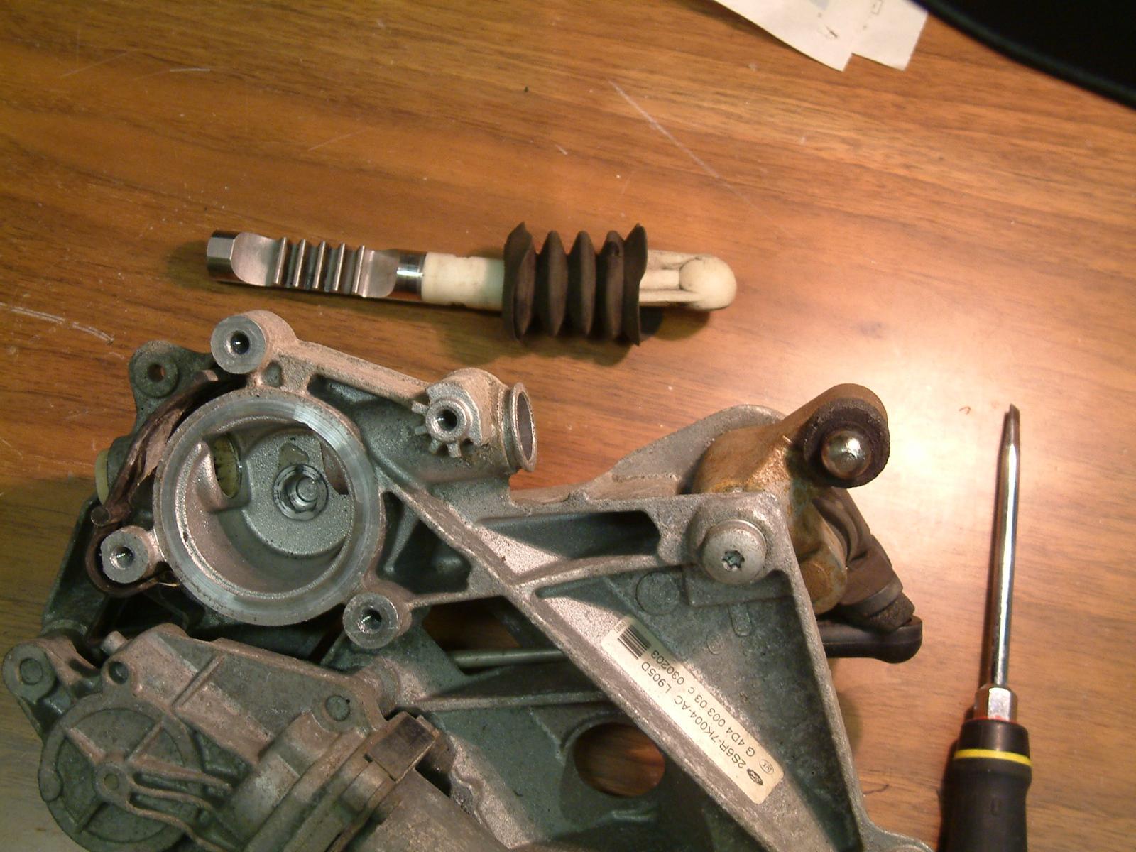

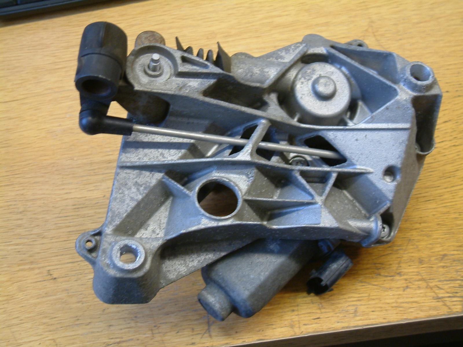

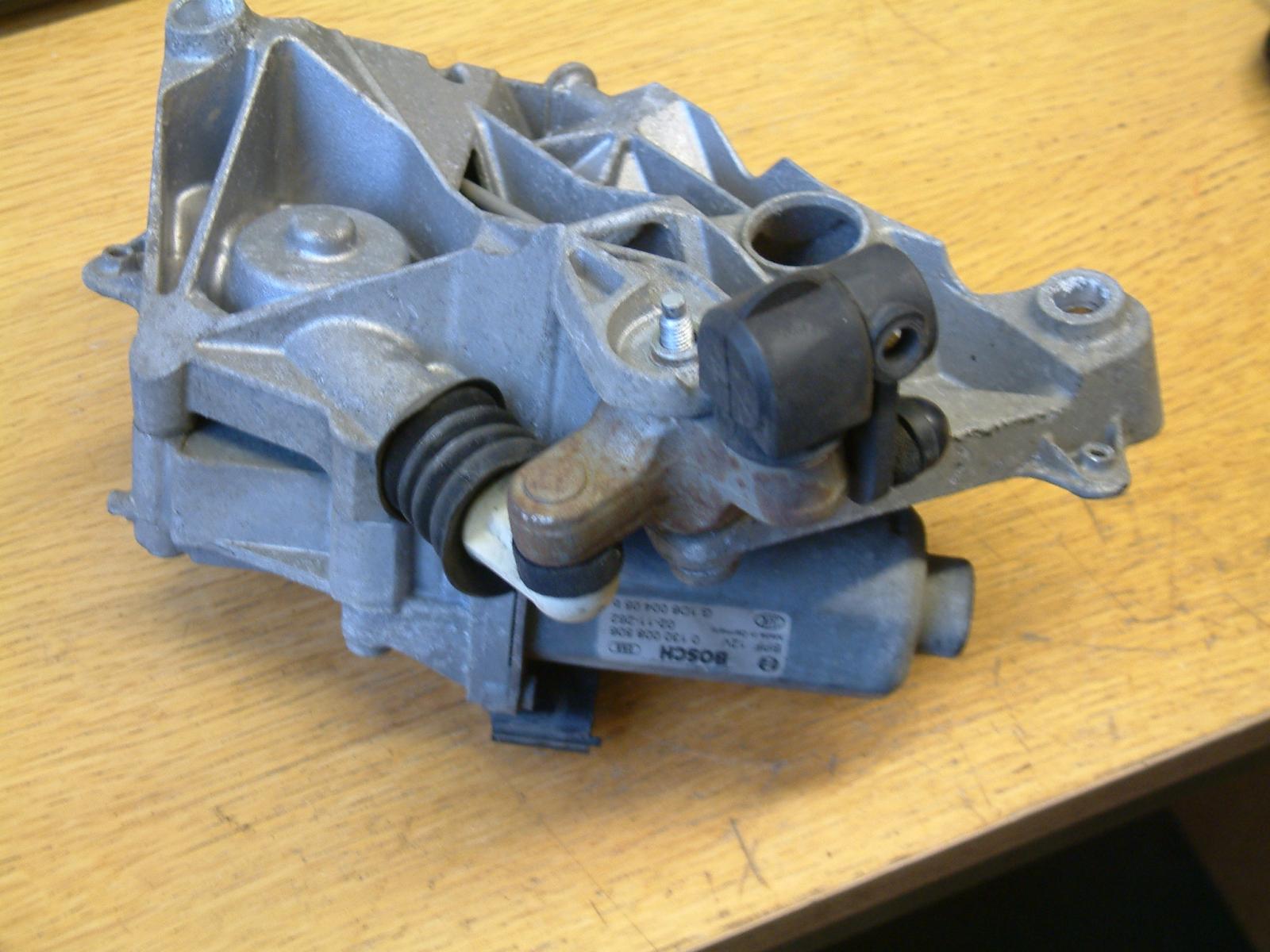

castros_bro Posted April 4, 2016 Posted April 4, 2016 On the subject of gearboxes, what are these automated manuals they have now? The picture I have in my head is a manual box with little robots working the clutch and selectors. Here bee roberts in a Ford/Mazda Durashift semi-auto. No no no it's windscreen wiper motors with GCSE level mechanical bit added one wiper motor does the fore-aft movement one does the side to side movement after a while the non lubricated bits and electrics exposed at the front lower of the gearbox stop playing The other bit is a pump to control the manual clutch WCPGR ? Normally no one knows how they work nor wants to be involved with them. But it does mean that a manual gearbox can be used in an automatic car till it stops working then billions of pounds as it's usually a "known good unit or new" swap for each component till it works again. P(is)S. If you have a Fiesta or Mazda with Durashift which doesn't work then either contact me for a bit of help or sell it to me very cheaply as I may be able to fix the mechanical/electrical/electronic fuckery. cort16, CGSB, The Moog and 4 others 7
