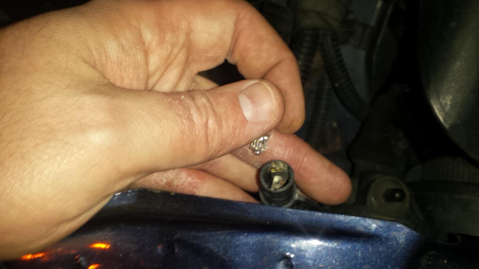

What type of bulbs fit this?
Alfa 156 sidelight bulb socket
My last 156 was a facelift but the sidelight bulb on that was a tiny bayonet-fit halogen one, which you can't touch and was absolutely impossible to fit (without touching it)
I think that is what this is, as it aint no normal sidelight bulb...
501 isn't it?
Edit- beaten to it.
501 capless
Nope -that i what is in my hand- its too small and the contacts are different
Apparently an H6W bulb..
