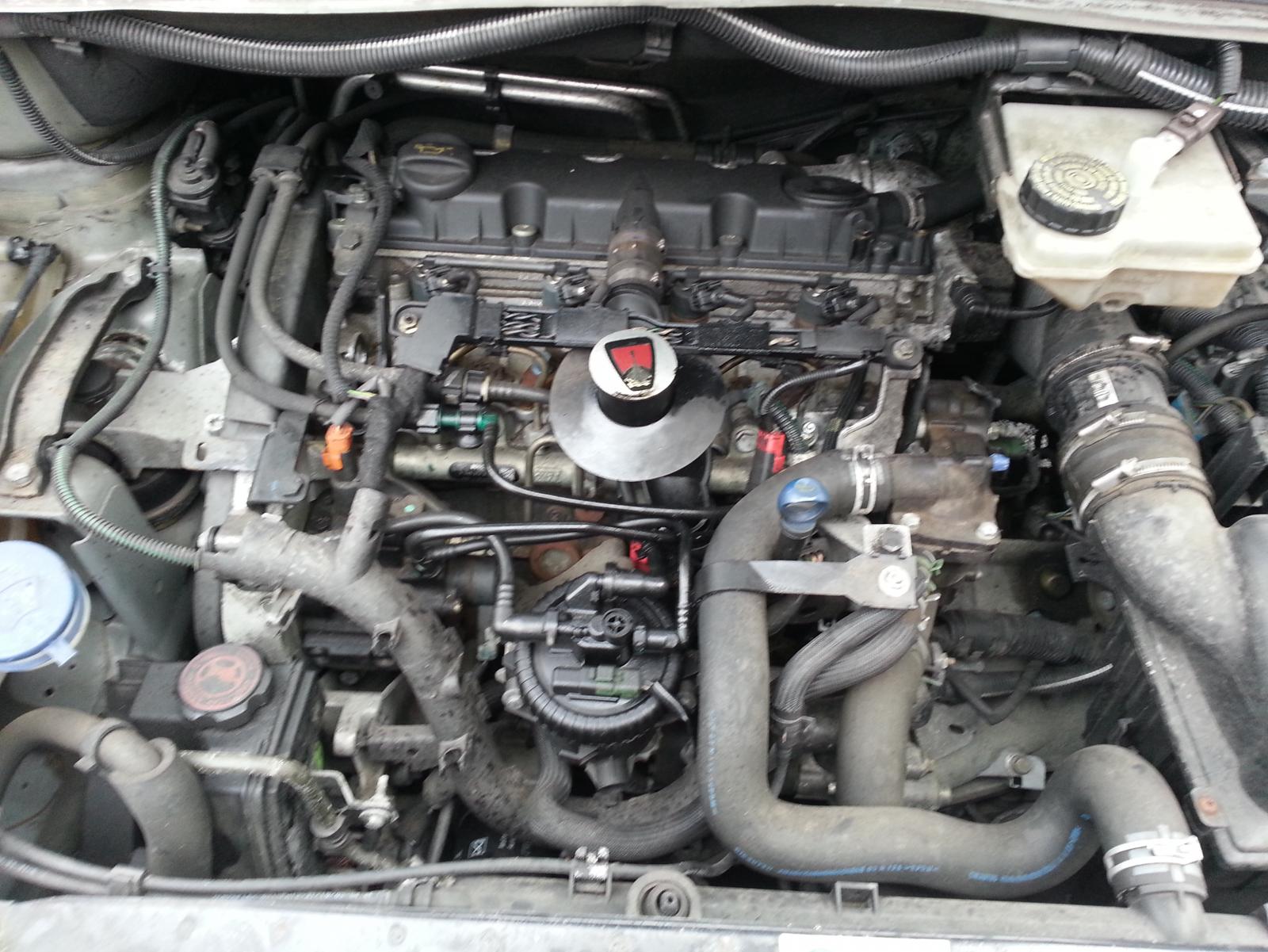

saucedoctor Posted February 17, 2016 Posted February 17, 2016 Went to lob a new battery in the Shitröen of doom today. Turns out it's under the seat! Anyway, while I was looking for the battery under the bonnet, I spotted something that probably shouldn't be there. Can you spot what it is? Question: is it the oil filler cap that's supposed to be there? Xsara Pickarsehole 2.0HDi 2003 Thanks all. Edited for information purposes in case anyone comes across this in the future: Despite there being an oil filler cap on the cam cover, due to access issues, there is actually supposed to be ANOTHER oil filler cap (top photo) where the errant Rover wheel centre is placed on the car I was looking at. I was in EAMF this morning and showed the photo to an "Oul Hand" who happened to be in the shop as well. Every day a school day etc. Asimo and KruJoe 2

steve_earwig Posted February 17, 2016 Posted February 17, 2016 20160217_123639.jpgWent to lob a new battery in the Shitröen of doom today. Turns out it's under the seat!It's a Picasshole then.Anyway, while I was looking for the battery under the bonnet, I spotted something that probably shouldn't be there. Can you spot what it is? Question: is it the oil filler cap that's supposed to be there?My first thought was "why has someone stuck an HDi into a Rover? Maybe for reasons of boilage." Umm, there's already a filler cap on the cam cover, from memory there's nothing much there, just the pressure sensor on the fuel rail and I don't think they need a hat.Xsara Pickarsehole 2.0HDi 2003Ah.
