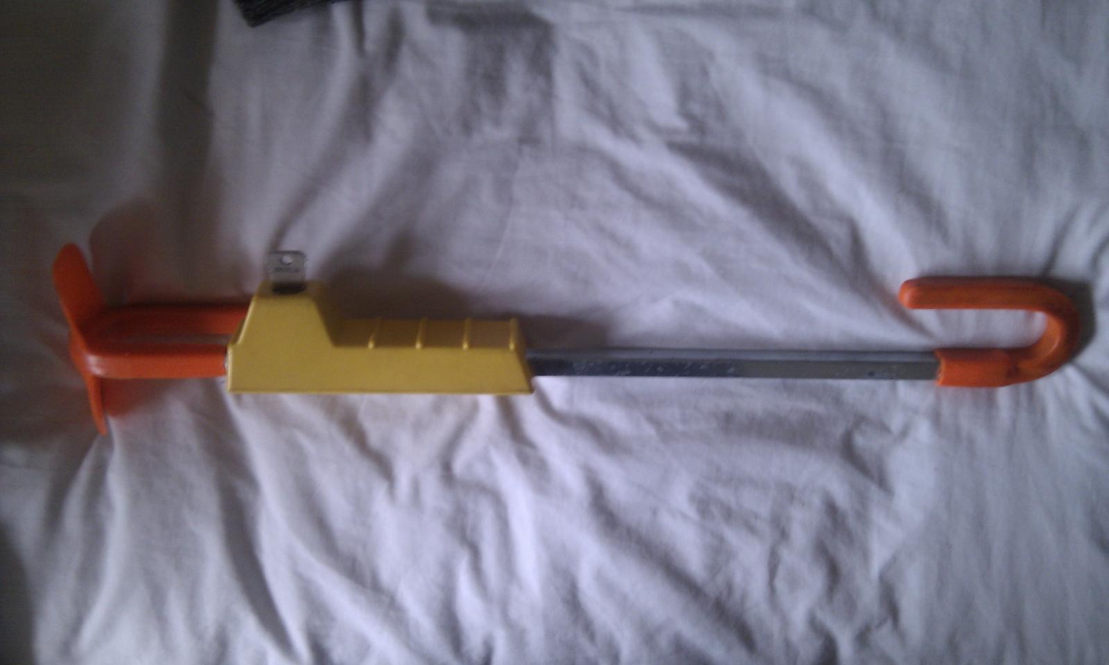

willswitchengage Posted November 8, 2014 Posted November 8, 2014 How does this work? Never used it but about to leave the country for ages and therefore doing SRS car security...
Skizzer Posted November 8, 2014 Posted November 8, 2014 Ah, KrookLok. You hook one end over the steering wheel rim and the other over something else, like the brake pedal, handbrake or whatever. You then pull it nice and tight. Then, if someone breaks in, they have to snap off the yellow plastic bit and fiddle with a screwdriver for about 10 seconds before they can release it and drive off. mat_the_cat, willswitchengage, cms206 and 3 others 6

Pillock Posted November 8, 2014 Posted November 8, 2014 Ah, KrookLok. You hook one end over the steering wheel rim and the other over something else, like the brake pedal, handbrake or whatever. You then pull it nice and tight. Then, if someone breaks in, they have to snap off the yellow plastic bit and fiddle with a screwdriver for about 10 seconds before they can release it and drive off.Or, on a 1988 Escort, you just lift the brake pedal up with your foot, it unhooks, you throw it in the hedge. It was either that or a Mk2 Polo, my mum had that exact krooklock in the late 80s and it annoyed her that I could remove it, aged 7 or so. Skizzer 1
