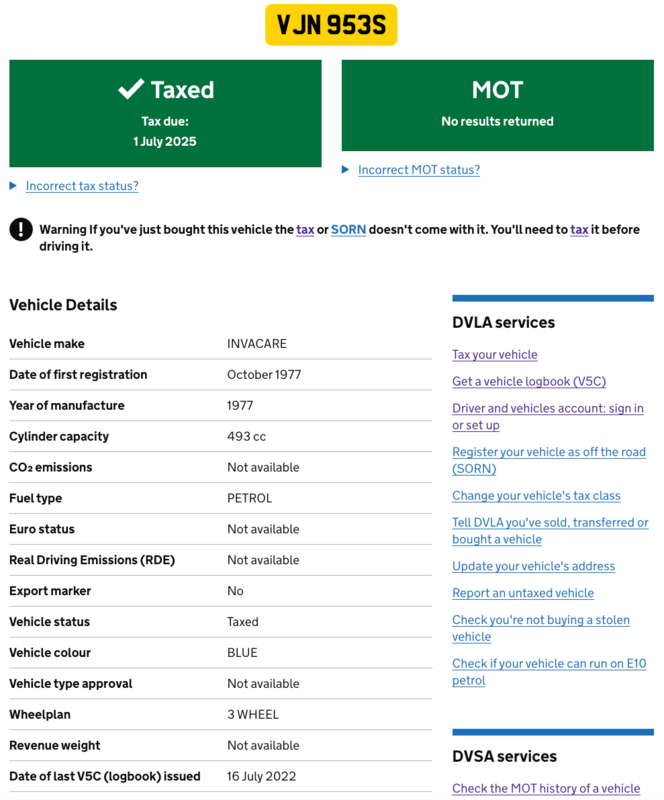

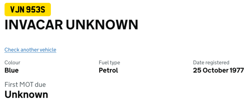

Missy Charm Posted November 9, 2024 Posted November 9, 2024 23 hours ago, LightBulbFun said: are you checking with the DVLA's vehicle enquiry services, or the DVSA's check-mot services? because @beko1987 is, and I am wondering if everyone else is as well those 2 checkers are completely independent from each other, and the DVSA only queries the DVLA's database for the raw data, to the point that the DVSA has its own make and model code lookup table, which is why for example a Model 70 on the DVLA will incorrectly report back as "INVACARE" but it will still correctly report back as "INVACAR" on the MOT checker, since the DVSA have thankfully not fucked up their own lookup table at least because of this, vehicles, even vehicles with a CoD will still show up on the MOT checker thankfully, but if you try and of the vehicles in the DVLA 1st party vehicle enquiery service checker, you will see that as above they dont show up sadly even ones that would of shown up until recently If it helps, plugging a random selection of our old number plates into here: https://vehicleenquiry.service.gov.uk, returns results that seem to be all over the show. My father's first Mondeo, which was written off further to a crash and scrapped in 2004 appears in the database - albeit untaxed and without MOT, ditto for a Ford XR2 we ditched in 2002. Conversely, the number of my father's second Mondeo - the replacement for the crashed one, incidentally - is absent from the database. Another Fiesta my mother owned is missing*. My Nissan Bluebird has vanished but a Ford I had afterwards is present; my old BMW coupe isn't there, but a car I owned years before that one is. God knows what is going on! *this one is really odd, given we know that particular Fiesta lived on for years after we sold it. The buyer was a semi-local woman we'd see out and about. Rust Collector and LightBulbFun 2

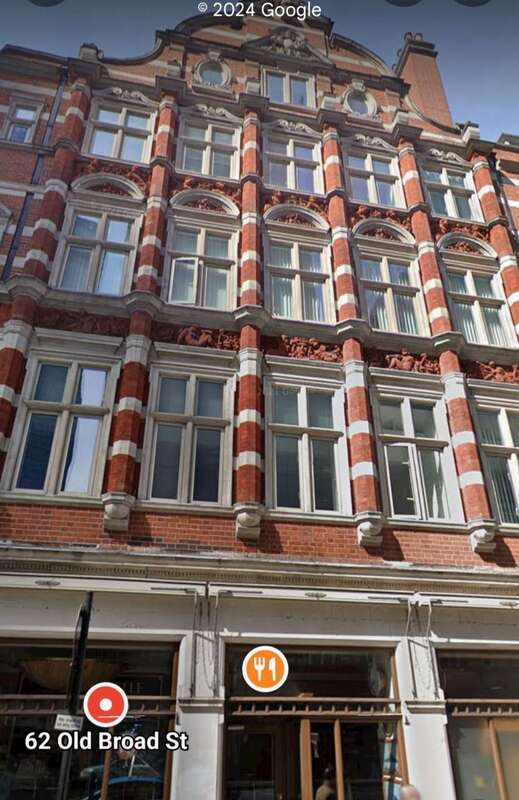

adw1977 Posted November 9, 2024 Posted November 9, 2024 23 minutes ago, Christine said: Place to go..unless it was bombed during ww2 Definitely looks pre WW2.
Christine Posted November 9, 2024 Posted November 9, 2024 LED lighting shop now The advert is 19th century...1890's Engineering magazine

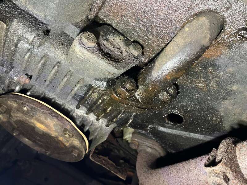

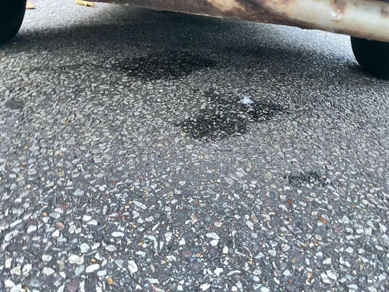

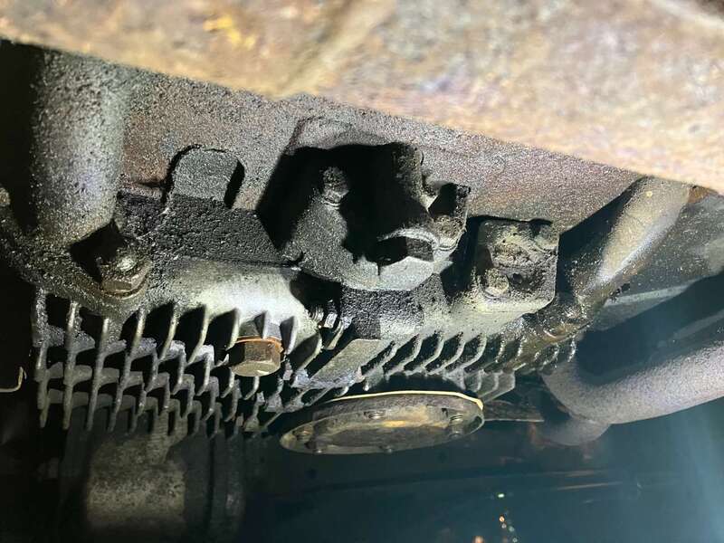

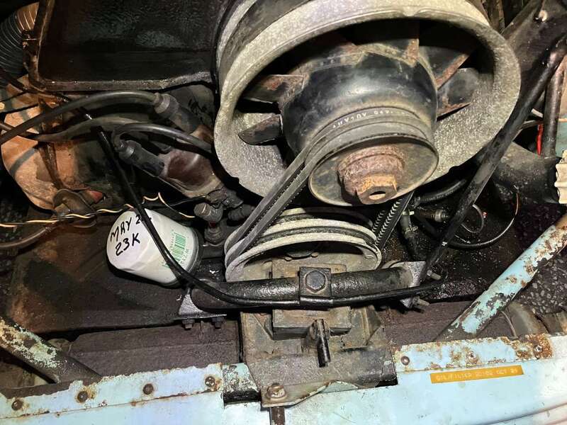

LightBulbFun Posted November 14, 2024 Author Posted November 14, 2024 Idle 7AM thoughts, like any British 1970's car I notice REV does drop a bit of oil, but what Im wondering, is what are peoples thoughts on it? if it is it excessive and if anyone has any idea where it might be coming from? I dont notice any active drips, but after a day or so parked in the same spot this is what she leaves on the road, the bigger patch is under the differential and I think is from the right side of the differential as I notice the differential is visibly wet around there so not too much mystery there (worn driveshaft or diff seal of some kind?) but the more perplexing one is the one closer to the camera (with the feather in it LOL) in that I know its coming from the engine, but I am just not sure where the oil leak is on the engine for it *appears* to be coming from the right hand side engine mount?! and unless the block is cracked or such at the mounting points, I cant see how an engine mount could leak oil? and its even more purplexing in that looking at the top side the right hand side of the engine cowling/tinwork is also similarly wet, but I cant seem to find anywhere it would of come from? the only thing in that area is the fuel pump, but it itself is completely dry so yeah just one of those things I am curious what peoples thoughts are on it? (I was initially only going to post about this once I had a chance to try and degrease/clean up that area and see if I can pin point where its leaking from/what gets wet first, but my sleep cycle is stubbornly refusing to budge! but once thats sorted I will try and clean it up to see if I can spot where it reappears from and report back) the possibility of a cracked block aside, my main concern is actually the differential leak, since its a lot more of a faff to check the levels on that then it is on the engine, so hopefully its one of those "Looks worse then it actually is" things I just figured given my relative inexperience with these matters that it would be best to get the hive mind to have look at it, I would like to think its nothing to worry about, but better play it safe then sorry as they say (I just really hope its not a cracked block that is my main concern, as she was loaded/unloaded a couple times via a strap round the engine rear mount point on the top side and im wondering now if thats put too much strain on the mounting points or such, but I also feel that i am perhaps reading too much into things) egg 1
JJ0063 Posted November 14, 2024 Posted November 14, 2024 I’d be complaining and claiming under warranty considering all the time it was away having work done. chadders, barefoot, Christine and 4 others 7
Christine Posted November 14, 2024 Posted November 14, 2024 Probably the dipstick seal. If thats a dipstick. . Or filler cap seal .. LightBulbFun 1
LightBulbFun Posted November 14, 2024 Author Posted November 14, 2024 23 minutes ago, Christine said: Probably the dipstick seal. If thats a dipstick. . Or filler cap seal .. I did check around the oil filler area and it looked dry, but the dipstick tube is not a bad shout its a solid cast tube into the block and the dipstick physically screws into place, but perhaps maybe at some point it got ran with out it fully screwed in or such? to check the oil level you unscrew the stick wipe it clean, plug it back in to the dip-stick tube but *do not* screw it in, then pull it back out. So I can see someone doing that procedure, then plugging the dip stick back in once the level was checked and forgetting to screw it all the way home, it would explain how it got all over the engine lower cowling/tinwork in that area
Christine Posted November 14, 2024 Posted November 14, 2024 You dont want to be dropping oil , when it rains it goes 'rainbow ' all over the road ..and the trail leads back to your place .. like the trail down my road leading back to my house when it rains....
Mr Pastry Posted November 14, 2024 Posted November 14, 2024 Is the crankcase breather system working properly? Important on flat twins, as they tend to pressurise the crankcase. Looks reasonably easy (and messy) to check. LightBulbFun, egg and mercedade 3
mk2_craig Posted November 14, 2024 Posted November 14, 2024 2 hours ago, LightBulbFun said: given my relative inexperience with these matters that it would be best to get the hive mind to have look at it No. It would be better to get a mechanic to look at it. Weird Car 1
LightBulbFun Posted November 14, 2024 Author Posted November 14, 2024 46 minutes ago, Mr Pastry said: Is the crankcase breather system working properly? Important on flat twins, as they tend to pressurise the crankcase. Looks reasonably easy (and messy) to check. there is a couple PCV valves with pipe that connects one of em to an inlet on the air-intake system https://autoshite.com/topic/29443-zels-motoring-adventuresvolvo-renault-rover-trabant-invacar-a-sinclair-c5-updated-1311/page/57/#comment-1851192 is there a method to checking if its work? I am also reminded in that they like to leak from that assembly anyhow https://autoshite.com/topic/29443-zels-motoring-adventuresvolvo-renault-rover-trabant-invacar-a-sinclair-c5-updated-1311/page/57/#comment-1854045 so ill stick that on the list to check
dollywobbler Posted November 14, 2024 Posted November 14, 2024 Could well be pushrod seal for that odd leak. Haflinger Technik stocks then. The seals where the driveshaft goes into the diff is a particularly naff design. They do seem to leak a little here, especially if parked on an angle. LightBulbFun and egg 2
Mr Pastry Posted November 14, 2024 Posted November 14, 2024 9 minutes ago, LightBulbFun said: is there a method to checking if its work? It's in the manual, page 23 IIRC. Quite likely to be full of clag, and if suck/blow test is negative it would be worth taking the whole lot off and cleaning, though I appreciate that is not easy by the roadside. The idea is that it maintains a partial vacuum in the crankcase when running, so the condition of the hoses and non return valves is critical. Mrs6C and LightBulbFun 1 1
LightBulbFun Posted November 14, 2024 Author Posted November 14, 2024 15 minutes ago, dollywobbler said: Could well be pushrod seal for that odd leak. Haflinger Technik stocks then. does Haflinger-Technik have a catalog or such of parts they sell? their website is not very verbose on that front, I have been putting together a list of steyr-puch engine service items and what have you to order from https://prokschi.at/ but it would be good to know what i can get more locally from Haflinger technik but that does remind me whats the general preference for rocker cover gaskets? I realised that I dont know if REV's valve clearances where checked/set while she was away, so thats something i'd like to schedule in and get done at some point, but I know ill need fresh gaskets for that, and I see on the https://prokschi.at/ they do a few different types, so I am wondering if theres a preference/best type, or is it a personal preference sorta thing?
Yoss Posted November 14, 2024 Posted November 14, 2024 I'd wouldn't say don't worry about it at all but at the same time I wouldn't be over concerned. It doesn't look that bad, I would just keep an eye on the levels. My Triumph front oil seal leaks but it is on its fourth one now so I've given up. I'm just resigned to the fact modern part are cheap shit. Fortunately there is a V shaped chanel of the front subframe directly underneath that catches the oil so I can mop it up from there before it hits the floor. It's almost as if they planned it that way knowing the front oil seal would leak. lesapandre, LightBulbFun and egg 3
