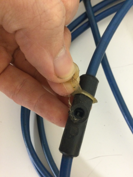

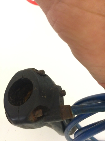

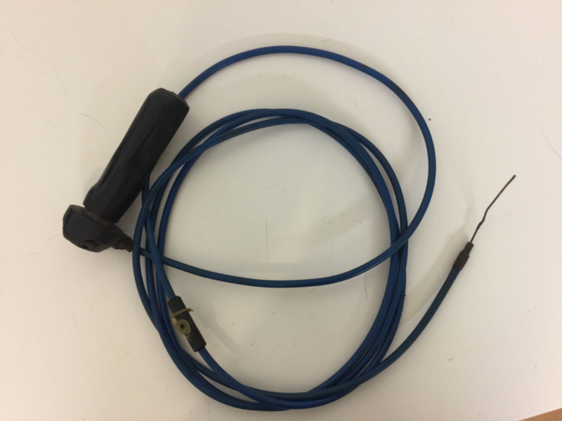

LightBulbFun Posted December 18, 2021 Author Posted December 18, 2021 the Throttle cable and twist grip assembly from Big al arrived just now it looks a bit crusty but inside the grease/oiler point looks ok, and when its un coiled into a vaguely straight line along the floor I am able to pretty easily retract the inner cable in with the twist grip so ill take that as a good sign! hopefully this fits and solves me problems! CaptainBoom, Dick Cheeseburger, AdgeCutler and 1 other 4
Mrs6C Posted December 18, 2021 Posted December 18, 2021 30 minutes ago, LightBulbFun said: the Throttle cable and twist grip assembly from Big al arrived just now Fantastic! May I suggest you contact him and let him know it has arrived safely and ask him at the same time, if he can describe and/or send you a sketch of where it should run on a handle-bar Model 70, so you can get it installed correctly, as your installation was a temporary fix and not necessarily in the right place? Also, perhaps @adam1db could advise further? He has a few Model 70s with the handlebars and may even have photos of the routing of the cable on the latest restoration, that he could share with you? LightBulbFun, Scruffy Bodger and richardmorris 3

DodgeRover Posted December 18, 2021 Posted December 18, 2021 Well done on making it down the road. I don't know if you spotted it but there was a strand sticking out on the end of the throttle cable you posted a close up of, that really really won't be helping matters and you should replace it as soon a possible. It is entirely possible to fit a new inner cable to the existing outer one if you want to keep the look. Making up cables only requires at the most basic a hacksaw and blow lamp/ decent soldering iron, liquid flux and solder, ensure you get plenty of heat into the fitting/ cable and make sure you tin the end of the cable you want to solder to. LightBulbFun, Scruffy Bodger and bobdisk 3
