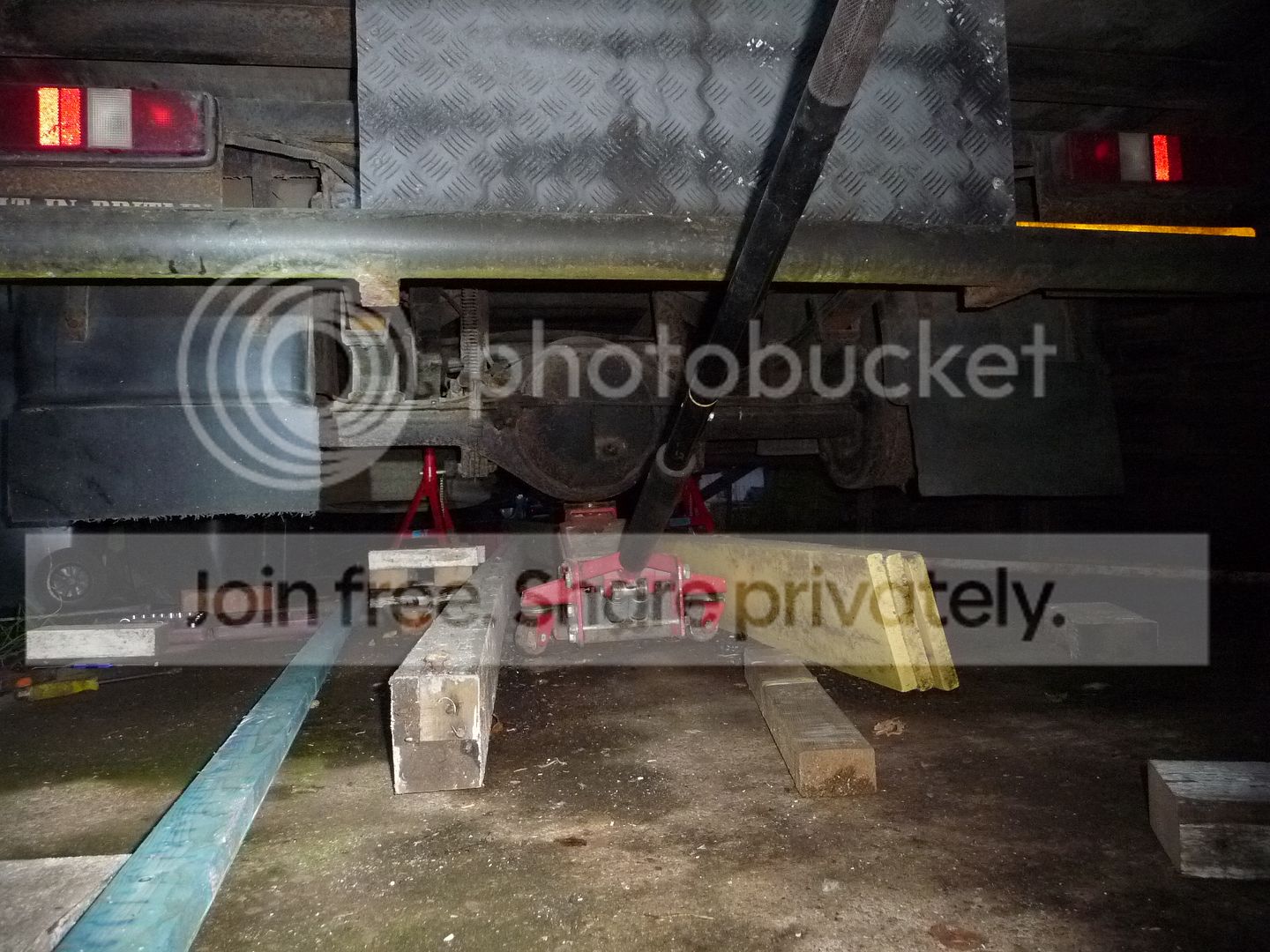

I need to get the rear brakes to bits on this so I can overhaul the wheel cylinders and no doubt replace seized-in bleed nipples etc. Also, the rear springs are well tired and are completely flat when the thing is sitting on its wheels. I reckon they have lost at least 3" of ride height. I am thinking about trying to get them re-tempered/re-arched.
Anyway for that I need to scrabble about under the truck. I've jacked it up (gives my trolley jack a mega workout, this truck is one heavy bastard!!!) and used my axle stands like so. Front wheels are wedged.

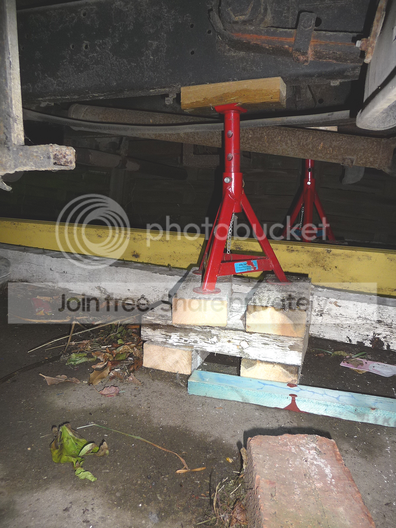

$64,000 question: Would any of you lot get under this?

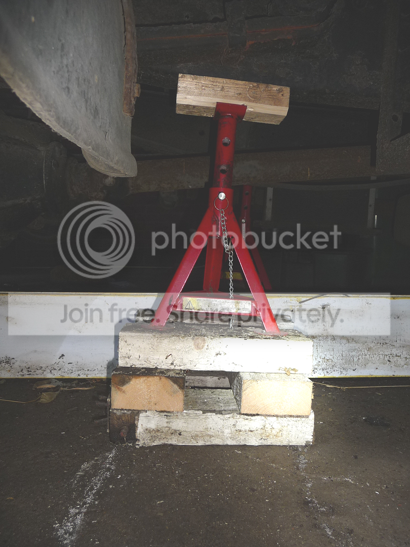

I've only got car axle stands, but theyre rated at 1500kg. The truck supposedly weighs about 3600kg in total so with half the truck weight spread over two stands I shouldnt be close to their limit. They havent got much height on them though, so I have sat them on a little stack of 2 x 4 timber chunks with a bit of 3 x 2 on top carrying the truck chassis.
Theres a few other bits of timber under here, theyre just there cos I have nowhere else to stash em!
Well anyway, I ummed and ahhed and tried to shove it off the stands, but it seemed fairly solid so I have been getting the brake drums off it tonight. But taking the leaf springs off is a different level of job, I dread to think how much the axle weighs. Would involve some serious grovelling about under there and I'm not sure I'm psyched up for that yet.
If you stick the stands closer to the back it will place them under less load than where they are now, however I would NOT go under that without heavier rated stands for the following borish tale:
 I had this palava recently with a 3000kg transit camper and a 1.5t jack as I thought initially 1 wheel at a time would be fine (~1/4 weight per wheel), however as soon as it started lifting a wheel the diagonally opposite spring served to heap extra load on the jack which stopped it lifting any further, in the case of your truck if the ground isnt level it could load one up disproportionately.
I'm wondering if rather like an engine crane, are axle stands rated at their max. weight in their shortest form? I know they're extended vertically but not horizontally, so it may not apply here. Those blocks look ok to me, so if you've given it the old shove/wobble test, I'm sure it'll be 'reet.
EDIT: the above former post might be better advice.
That said, other random bits of lumber about the place propping shiz up may offer up some sense of security, even if it's psychological.

Fuck that just buy or borrow some bigger axle stands it’s just not worth it the risk .
Those wooden blocks look like something you might see at the start of an episode of 90s casualty .
cuts to mister bollox stacking blocks of wood , He takes a slurp of his tea, tells his turtles he’s just nipping out to work on the truck then gets a horsebox in the groin.
Don't get under that!
Do it right or not at all.
No chance. I wouldn't send my worst enemy under that!
The Retro Rides solution would of course be to leave the rear springs as they are and fit 3" lowering blocks to the front.
I've got some big auld axle stands at work, you're welcome to borrow them
EDIT: just measured them, 2 foot tall at max extension. 3 ton rating, per stand.
You have done some absolutely great work on this so far, but even with decent axle stands I wouldn't entertain changing the springs working on your back in a cramped driveway.  The axle will be heavy and the springs will be heavy,  and the shackle pins will probably be seized.  A bridge too far IMO.
I'd stack a few spare wheel under each sill/axle just in case it drops
