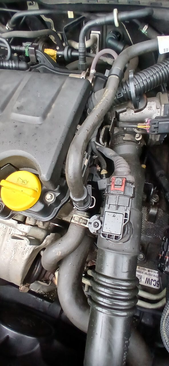

So the other Astra J. This one a 1.4T auto GTC is proving I'm a useless mechanic.  I noticed some coolant loss the other weak.
Eventually spotted it was coming from the plastic housing on the side of the engine.
Internet wisdom said to replace with alloy housing.
Which I did.
And ran up to temp to check it was okay.
Next day after 19 miles It threw up a stop now warning. Most of the coolant had disappeared. Coming from behind the aluminium housing.
I Let it cool before adding some extra coolant to finish my journey.
At lunch time I tightened it a little more, and took it for a drive.  Seemed to be holding.
On the way home I stopped twice to fill up. Its still pissing out once its up to full pressure.
Expert** wisdom told me I should have reassembled with blue hylomar in the first place.   After checking the face of the new housing.  I'm working from home today so will spend lunchtime doing just that.
**Expert wisdom?  I wandered into the Emgine Development team at Work and after they realised I didn't want to talk  about work especially Euro 7 or Cummins, gave me their undivided attention.
Pictures of the old plastic housing.
Which I did.
Did not work. Gave up and bought a plastic housing from GSF.  Fitted last night. Have done 30 miles and its holding pressure.
Ebay have refunded the aluminium housing.
So much for Internet wisdom.
