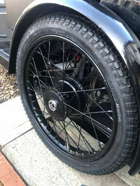

On 08/02/2023 at 21:20, brummiejon said:
I had a bit of a mishap on Flo’ at the weekend…. I knew that the 70 year old tyres weren’t going to go far… My word, the explosion scared all the seagulls in Whitstable…. By Tuesday, I’d sourced, had delivered and fitted two new tyres and inner tubes…. Totally transformed the ride….. The front tyre is next but it’s a rarer size….
by the wording of "front tyre is next" that implies the front tyre is still whatever was fitted to the Argson when it was laid up gawd knows how many years ago :) (easily 50+ years ago)
I’ve changed it already…. The rubber just brushed off the sidewall it was so dry
