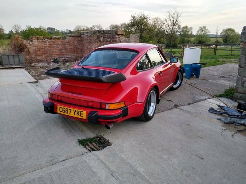

Went to help out my semi-employer last night, he had given his 911 a run during the day. It was a nice evening light so I papped a couple of pics.
A few jobs for me to do on it including fix windscreen washer pump and change front shocks.
Apparently it's a 'Supersport' so looks like a Turbo but isn't a Turbo.

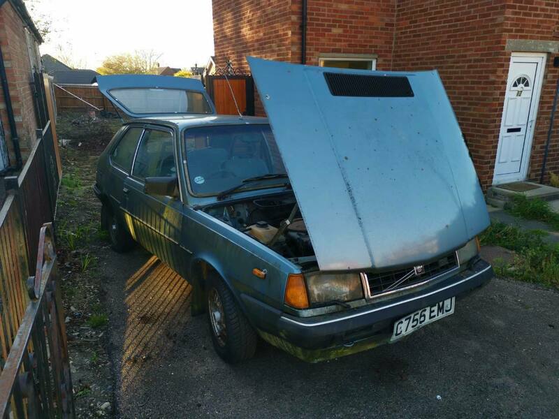

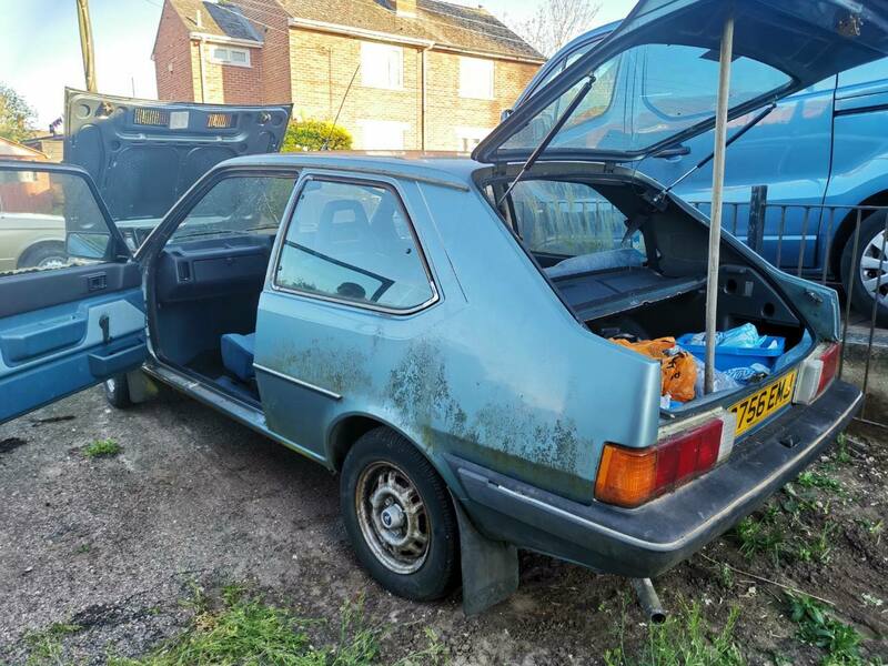

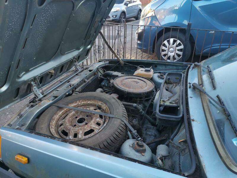

So recently I found that my wife's cousin works for a solicitors and deals with probate properties and often has old cars to get rid off, obviously I asked her to let me know if anything turns up that would interest me.
The next day I get a WhatsApp from her offering me a Volvo 340...
Armed with some rubbish photos and working out that it been parked outside a property in Potters Bar in since 2010 I decided it probably wasn't for me but Brodders of this forum stepped in and made a offer on it!
I passed the offer onto my relative at the solicitors who said the family will have to pay £300 to dispose of it so give them £50 and they'll be happy. The car arrived late last night (which was a pretty eventful delivery by all accounts) so a few of us went over this evening to take a look at it.
It turns out to have been a 1 owner locally sold car with only 53000 miles and under all the green is a really tidy car, sadly its missing its keys as the owner lost them in 2010 hence it being left on the drive but after some fresh fuel down the carb and hot wiring the ignition the car fired straight up and ran!
Unfortunately a rear brake is locked on so we couldn't move it but instead spent a while pressure washing it, unfortunately no photos but it's cleaned up really well.
IMG_20220420_204252.thumb.jpg.3c1dee8ba569ec37729f09572486b91d.jpgAll in all for £50 I'm gutted I didn't buy it now!

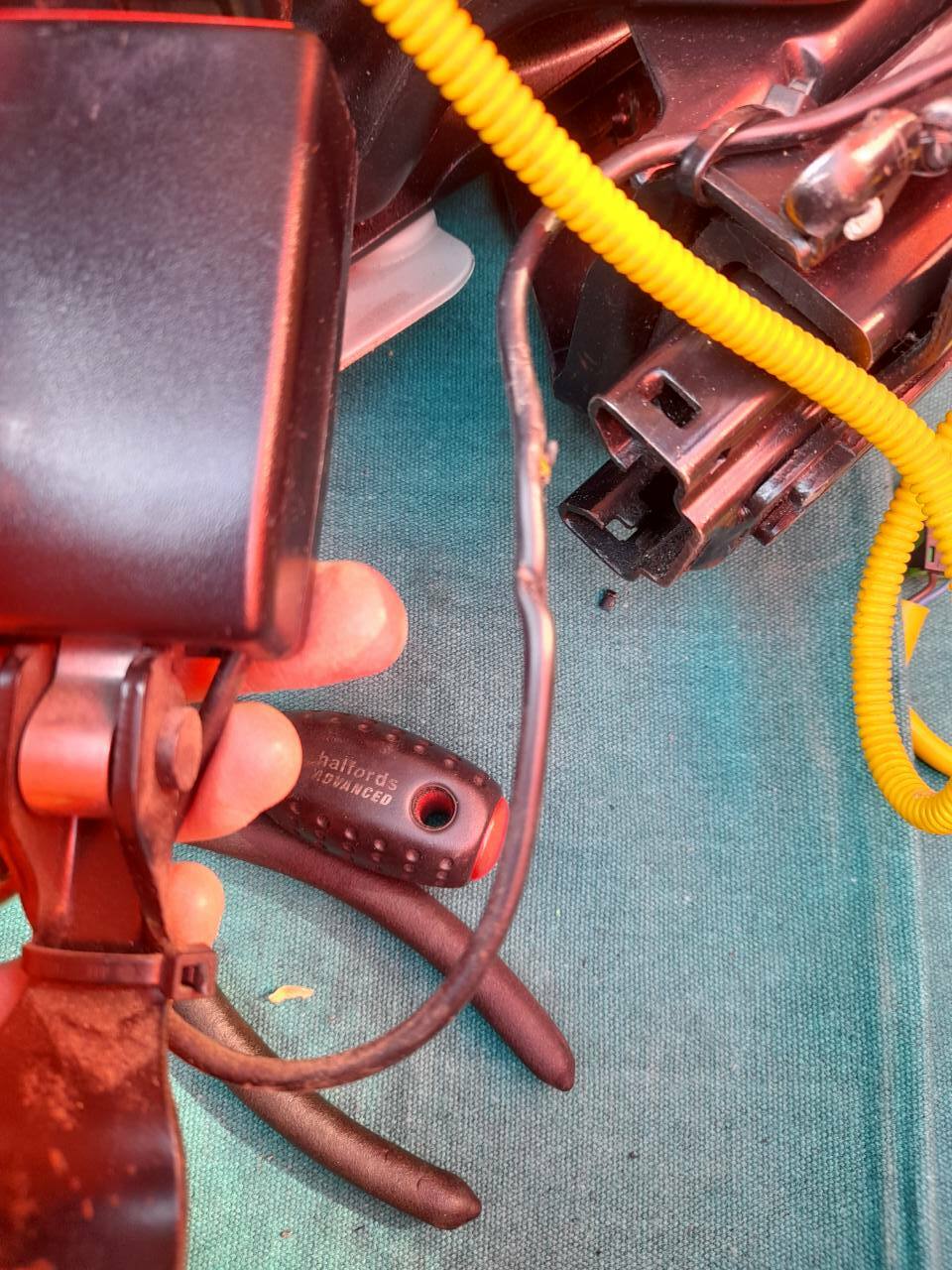

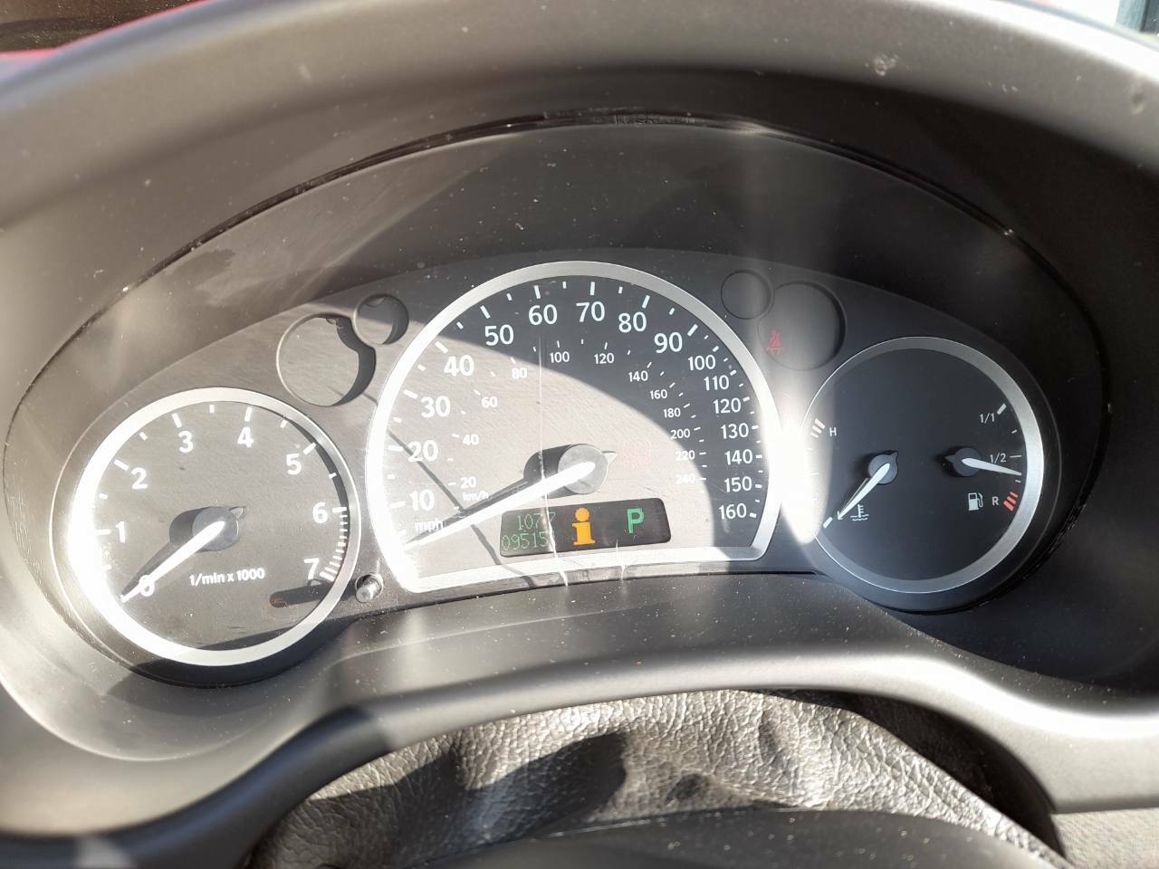

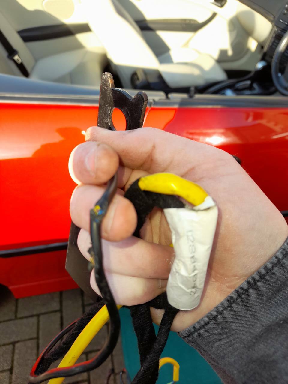

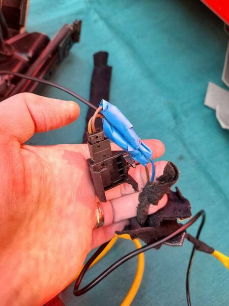

I tackled the Saab airbag light issue today.
The driver's seat proximity sensor had been ripped out from the loom by an upholsterer a few years ago, long before I bought the car. It was taped in and this worked for a while but the airbag light has been on since before my ownership.
I had tried to splice in a new plug but it was having none of it.
Seat out, rear panels off and the loom was out quickly.
The scrap car had some additional wiring as part of the seat which mine doesn't have but both looms were checked and were identical.
However, as you can see, my repair would never have worked as the loom was completely severed just below the seat belt buckle.
The sheath was all that was holding it together.20220421_165403.thumb.jpg.ebb91bd593309d1f95bc2f3a845aeb8a.jpg
New loom worked in and seat back together.
Ignition on and a deep breath was taken.....
The airbag light is under the fuel and temperature guages.
Success. Much delight as I can now submit for an MOT next week.
