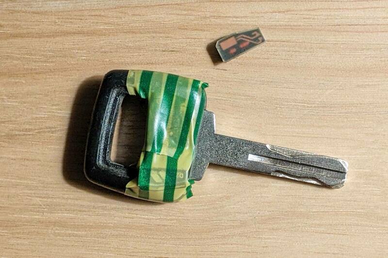

Went to the local keycutting place today to get a spare done for the old Volvo Of Many Shiters since I only got one with it. All I was expecting to get was a key that physically fitted the door lock rather than a full immobiliser chipped one. Bloke rummaged around in a box, consulted a couple of catalogues before producing a blank that he said should do the job and said, "I haven't done one of these for about 4 years, I  think I've got a couple of chips that I should be able to do but they don't fit in the key blank so it'll just need to be taped on, be £40 if it works or a tenner for just the key if it doesn't."
15 minutes later he presented me with this, which I took and tried in the car and it works perfectly. Even gave me another chip in case it gets lost.
Autoshite problems require Autoshite solutions,  so now I (& the next lucky owner of this magnificent heap)  have two working immobiliser keys.

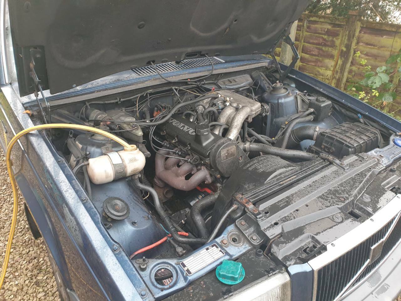

I nipped to Wilco on Tuesday to pick up an 11mm square drain plug key, and I went out to the Volvo earlier to see if I could get the in-tank fuel filter out.  It took some doing - I had to get the breaker bar on it and I honestly thought the socket in the drain plug was going to round out at one point - perhaps unsurprising given that it had probably not been touched for almost 50 years.  It came undone in the end though - the filter was rather manky but it also has a split up the seam of the mesh screen so it won't actually be filtering very much, although I'm not sure whether the split was there already or whether it happened when I was wiggling the filter out of the tank, it's a little bit fragile which is allowable at that age.  Brookhouse Volvo list a new filter for £12.95 plus the dreaded and delivery, so about 19 quid all in - a lot for a little mesh cylinder but not a huge amount in the grand scheme of things, so I splurged.
That does mean I'll have to wait until it arrives before I can put everything back together and refill the fuel tank, but if I do need to move the car in the meantime I can always run it off a jerry can under the bonnet.  I might try doing that anyway, to see if the engine runs any better - that would prove that it was definitely the in-tank filter and / or the line from the tank which was causing the fuel starvation issues.  If the new filter doesn't cure it I'll need to get an airline to blow through the fuel pipes, but that'll mean bringing the car onto the drive which will mean moving the Innocenti, so that will probably have to wait a while.
