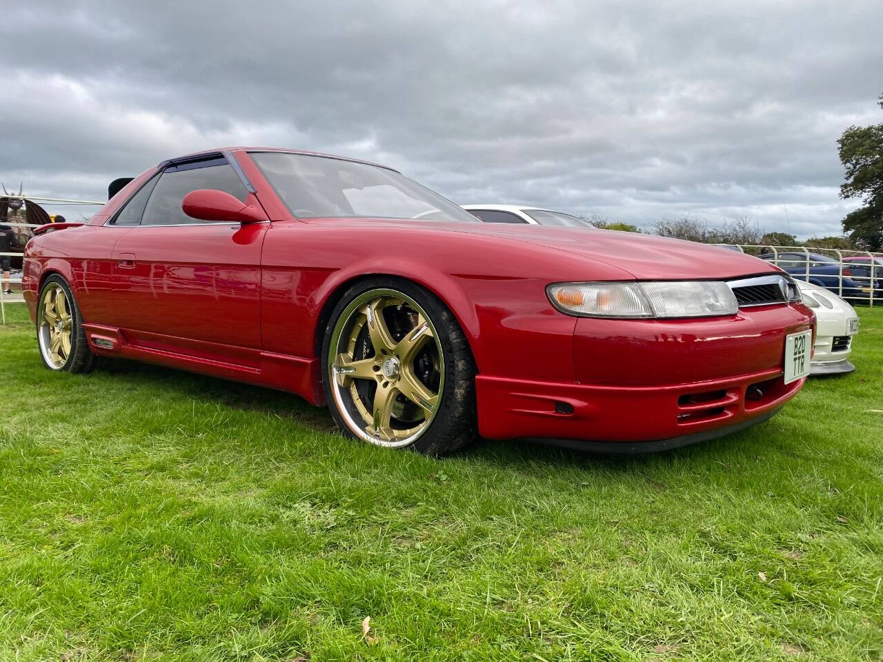

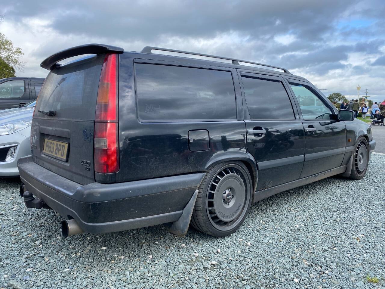

AA9ECA18-B3FD-4894-8CB1-2DAFC29FC8EA.jpegBD22DC17-20C6-4364-807F-D572578DABD9.jpegBEB0E2E1-2752-4B4F-9B52-306B3D35C9C8.jpeg36FEBD1E-2B16-435E-A873-DFBD4A4E59E7.jpeg
Oooh a Micra!

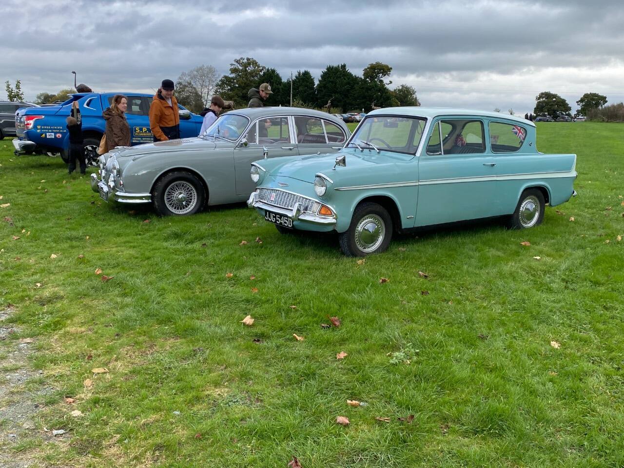

D6F88F09-DEB9-49A8-A780-D52CA748FD78.jpegEF8776E1-B3F8-41DE-B9C4-8A9C7B6EC7DC.jpeg926EC3B1-B5ED-416E-AE7C-3DFCE9B202C9.jpeg309F8AC4-93A5-4706-AC14-570C4DF152CB.jpeg8A98615E-DAF5-40F9-A601-453BCC773D93.jpeg4D63D841-5643-4407-BBB5-79A1C6601864.jpeg3394EF51-4CDE-4A41-B257-5B301F4E3003.jpeg0EFF6634-18C4-4DD4-A774-F4BC5DE57B8C.jpeg
My friend Mark owns this hilarious specimen!
This 100NX looked lovely (until you looked closer and saw the rust…)

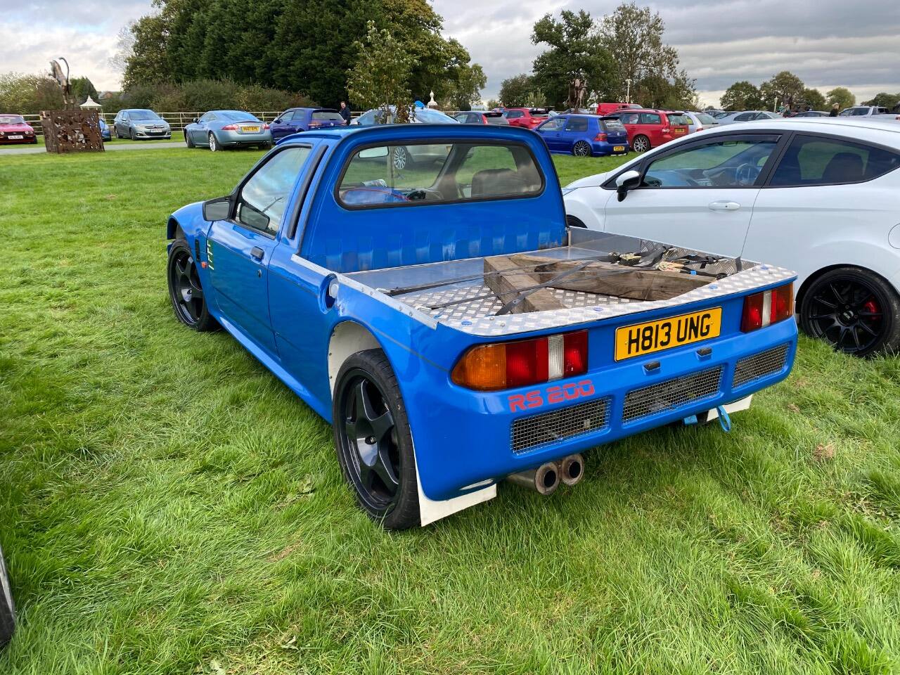

But undoubtedly the weirdest specimen….
34C11A22-E9EC-4D64-BE7E-B9E16AC77A76.jpegAA9BBEE8-DC75-4EAA-AED9-2ABF4A9AF84D.jpeg8AABFC30-3ACB-4B82-AC54-E351A6F6B6C2.jpeg
P100 based by the looks of things. Mental!

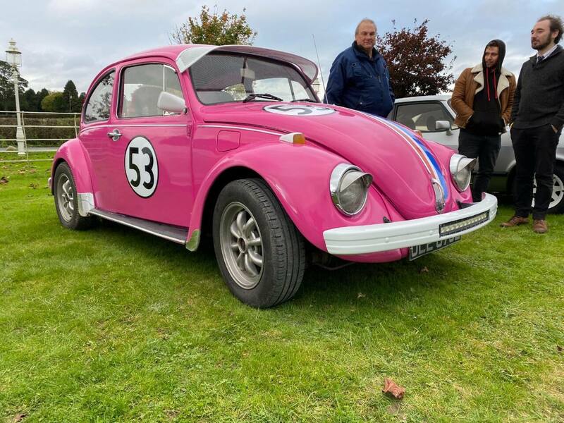

I don't usually like Beetles...but that pink one looks great I think - albeit the LED lightbar on the front bumper being a bit jarring.  The colour just suits it perfectly.
Yeah he was quite proud of his light bar.. I thought it was easily the worst thing about that car! He was at both events like me!

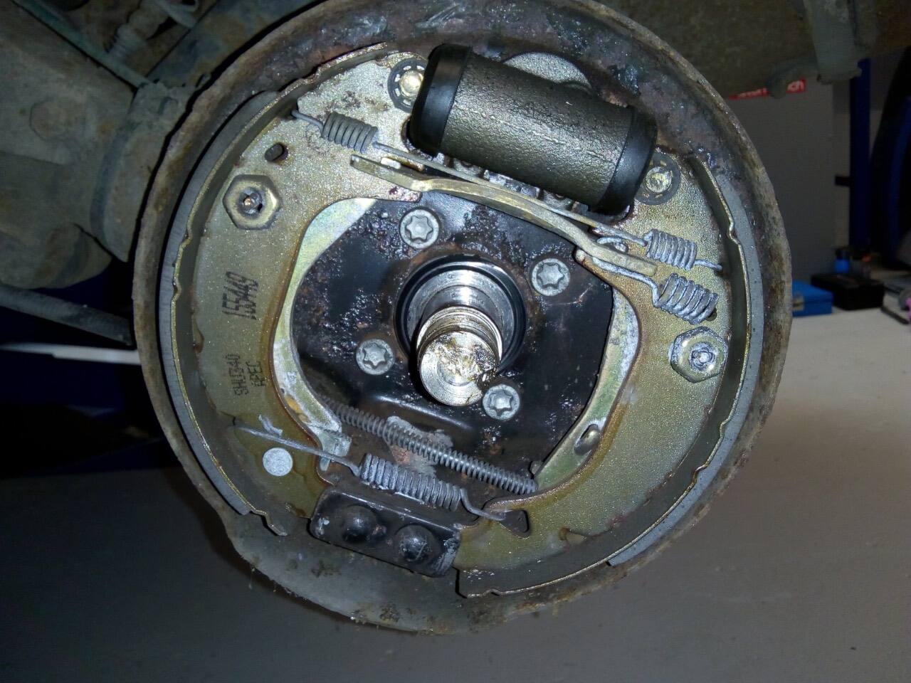

Next stop of the day - a friend’s garage with an Automotech scissor lift and a lovely Dewalt battery impact. I’d been here a fortnight ago replacing the rear brake shoes but found that the brakes were still at brown-trousers levels; massive brake travel before anything approaching lockup, at any speed. The theory with these is that you fit the rear shoes, back the (automatic) adjusters off as far as they’ll go, fit the drum and stomp on the pedal and listen for the adjuster ratcheting in and taking up the space in the drum. That didn’t work last time so I took the drums off, manually adjusted the ratchet so that the shoes were as close at possible to the drums, while still allowing me to refit said drums over the top. Old shoes shown in picture - suspiciously new wheel cylinders and shoes, which makes me think someone else has been in here trying to improve matters relatively recently. I’ve kept the ‘old’ shoes for spares.
Also replaced a totally destroyed handbrake cable - slightly suspicious that the complete lack of n/s handbrake effort didn’t show up on the last MoT, but that’s all sorted now. In amongst all this fiddling around, one piston on the o/s wheel cylinder decided to escape, necessitating taking the shoes off on that side too - the side I shouldn’t have needed to touch, adjusters aside! To top it all off, after that faff, I refitted that drum without putting the shoe retaining pins back. Cue 40 minutes of pain and hammering to get the drum off again. A long day, but brake pedal feel is much improved.
A full brake fluid exchange will occur as soon as I can work out how to get the sheared off o/s bleed nipple out of the calliper. Any great thoughts on this? I’m wondering about hammering a small torx bit into the hollow centre and using that to unscrew it, but a secondhand calliper may be the best bet. The car fought me the entire day but the brakes are far less scary now - so I can forgive it!

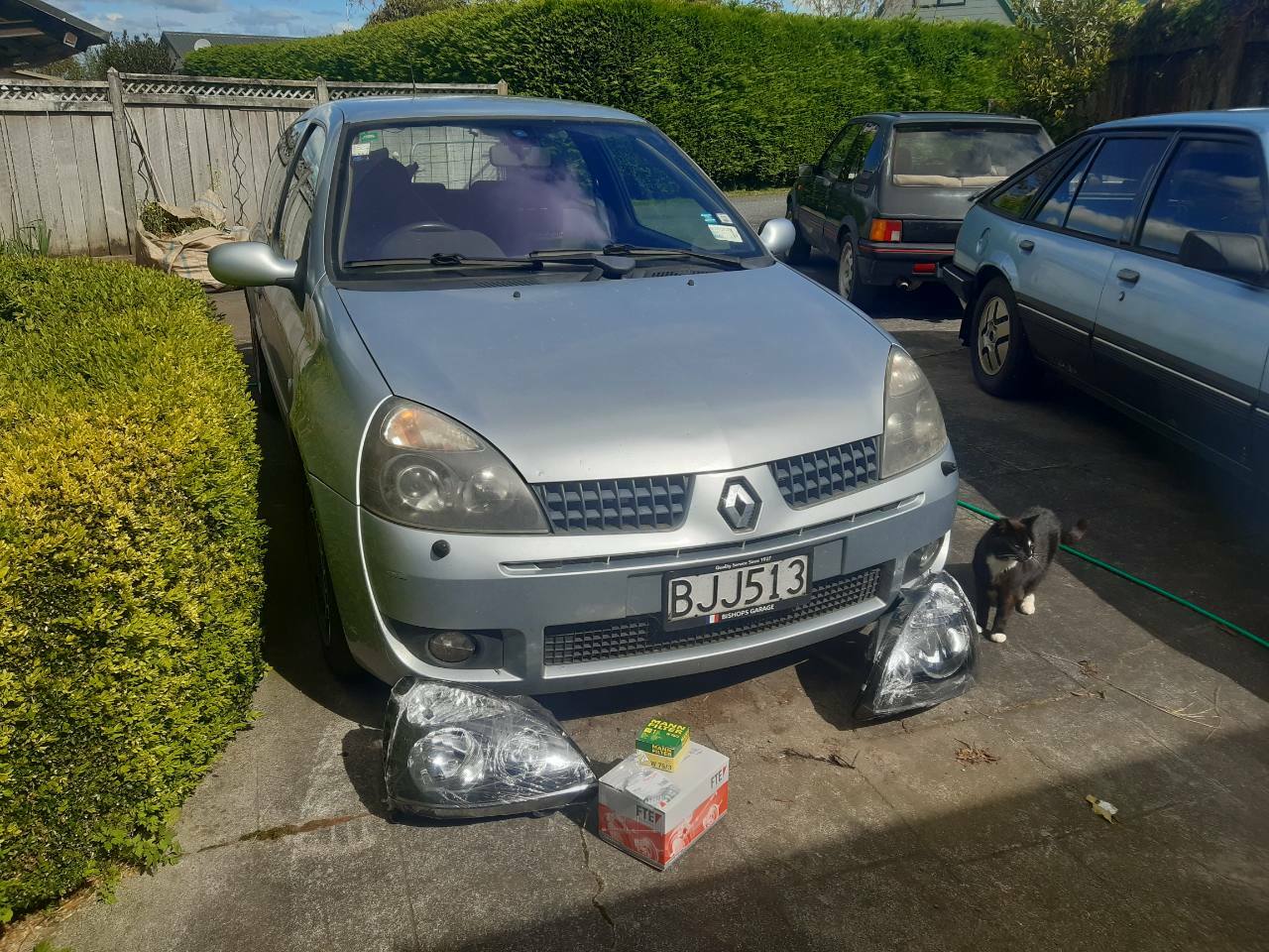

We've done the sequence in the right order but I've not tried the pumping brakes before releasing the bleed nipple, so I'll look to give that a go when Mrs_Jon is home from work tonight to pedal pump.
Here's a photo of the offending article - seems it's quite a late (phase 2?) 172:
