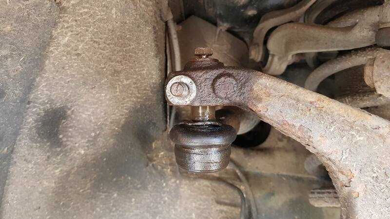

Not even the expert can get past this:
The rod will slide down and up now with a few hammer taps but just won't drop out, like there's some kind of hard stop preventing it.
Any ideas?
Any ideas?
Surely the nut at the top has to come out?
I think you will find that the shaft of the ball joint has a short flat section machined on one side.  You will have to remove the cotter pin from the LH end of the steering arm to clear it.
Yes but it won't drop far enough for that to matter, I'm using the nut to hit.
That would make sense.
I could not get that pin knocked out, and the replacement doesn't have the cut out in it.
It's booked in now anyway.
Yes, it's that bolt/ pin on the left which is stopping it coming out. It'll be slotting into the notch as @Mr Pastry says.
It doesn't look too grotty so probably just needs some heat and a BFH to knock it through.
