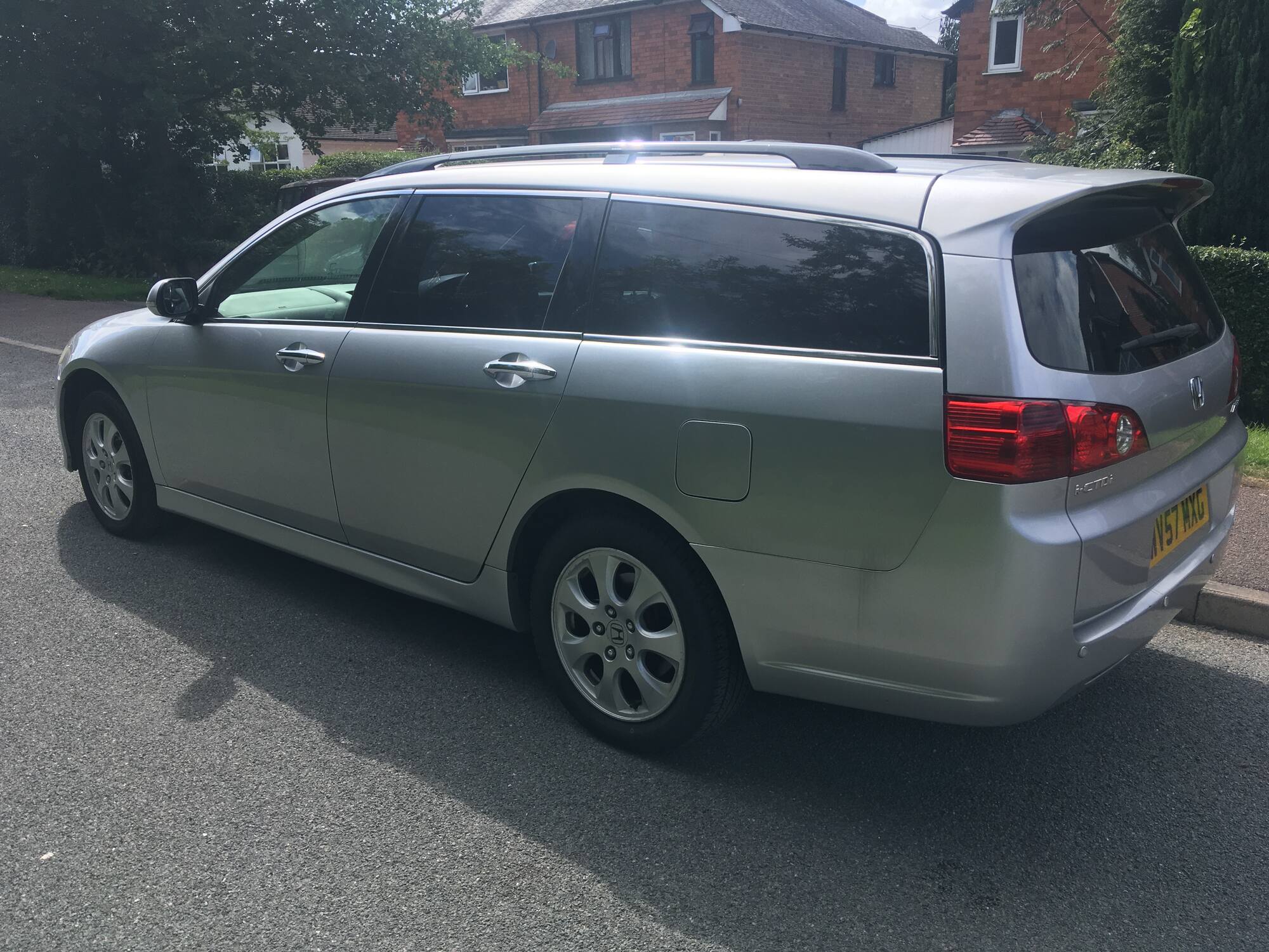

19 hours ago, rickvw72 said:
Bit of a fleet churn this week.
In:6D3A1ECA-673D-421F-9ED5-CA8781FE5E96.thumb.jpeg.6f69ea1c2d712fcf550abd93c64cd7bb.jpeg
Excellent trade in equivalent overall length of grey metal there.
I always did have a soft spot for the Hornda Longshuttle. I just don't possess anything long enough to justify getting one. Maybe if I take up pole-vaulting.
