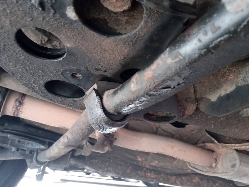

Yep, that's done its time I think...
Still irked that the mid section looks absolutely fine aside from the last 1 1/2" - on the plus side buying a full system was cheaper than just the back box, so could have been worse I guess.

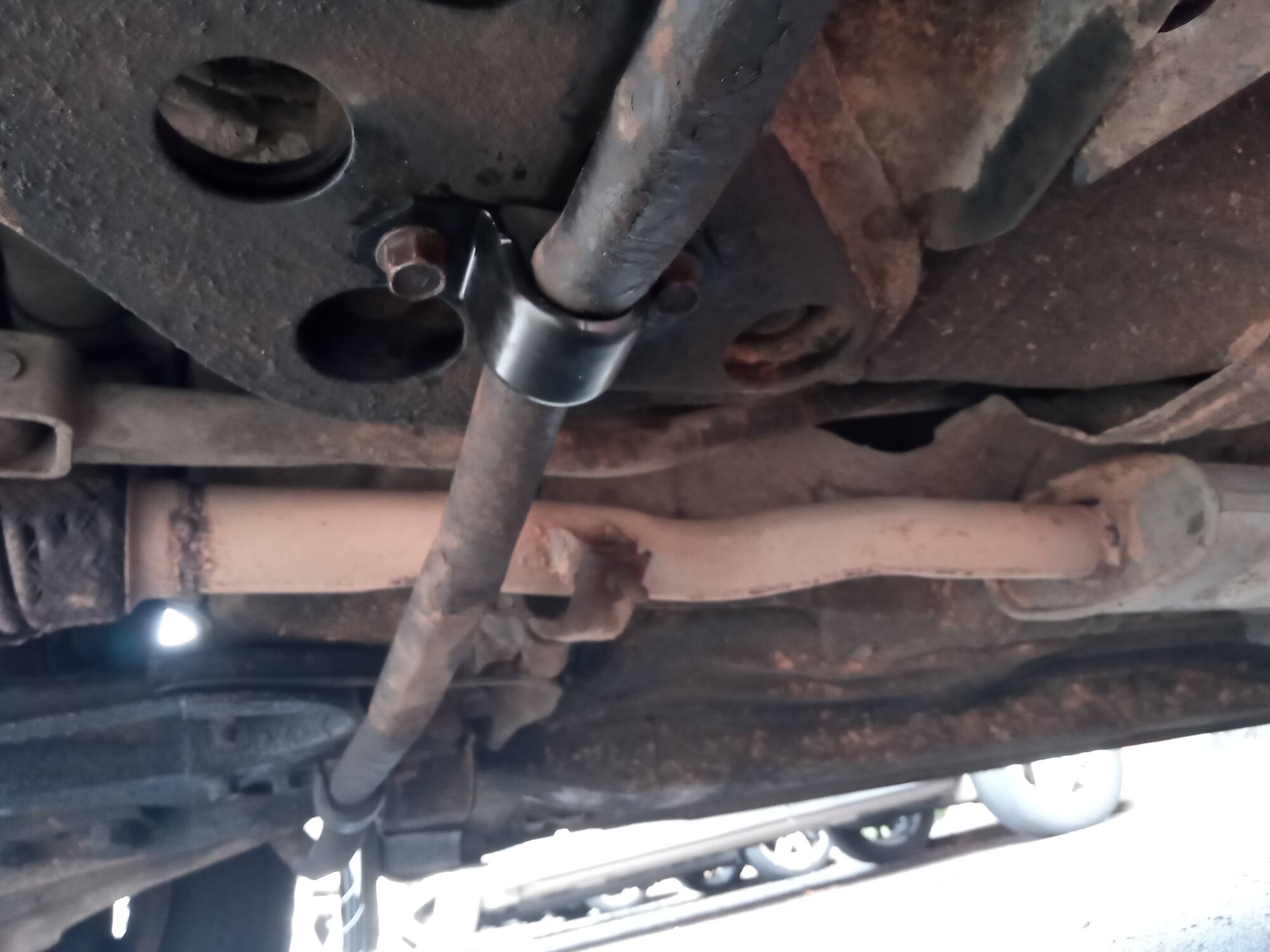

Right, time to get to work on the Bluebird. In the hope of feeling positive progress, I decided to start with the easy jobs. Anti roll bar mount cracked...
I mean... That's some degree of cracked...
NOS one was the best part of 20 quid, but there we go. Bushes in good nick so on it goes and that's it.
I always like the juxtaposition of a brand new part surrounded by the sea of 30 years' rust, road dirt etc.The brake lines need re doing and possibly the rear suspension. I'll probably stick it in the garage for that plus the MoT next week, and do the pads/discs (low, but not a fail yet) after.
2 minutes ago, Mally said:
20 quid ! I could have welded that for 20p.
For some reason, even with OMGoldskoolford price inflation, parts for old Nissans are silly prices...
It's simply a U-shaped bit of metal with two holes, not even tapped, to hold the anti roll bar in position!

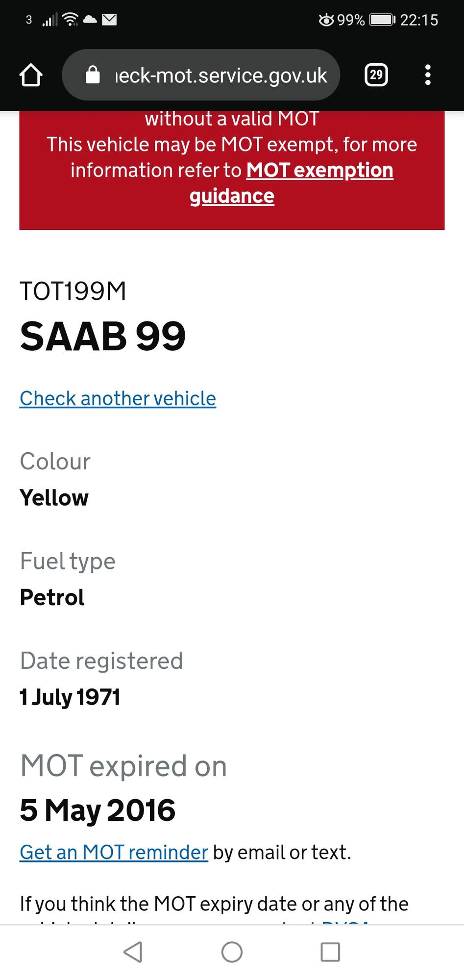

I'm guessing there are different DVLA databases. I was using the MOT history checker as I was curious to see that anyway...

And it definitely says date registered 1 July 1971 (I went back and checked as I thought I might have mis read it after the above replies). That would put it on a J. Then again they also say it's yellow and it certainly isn't. Maybe DVLA don't consider beige a colour.

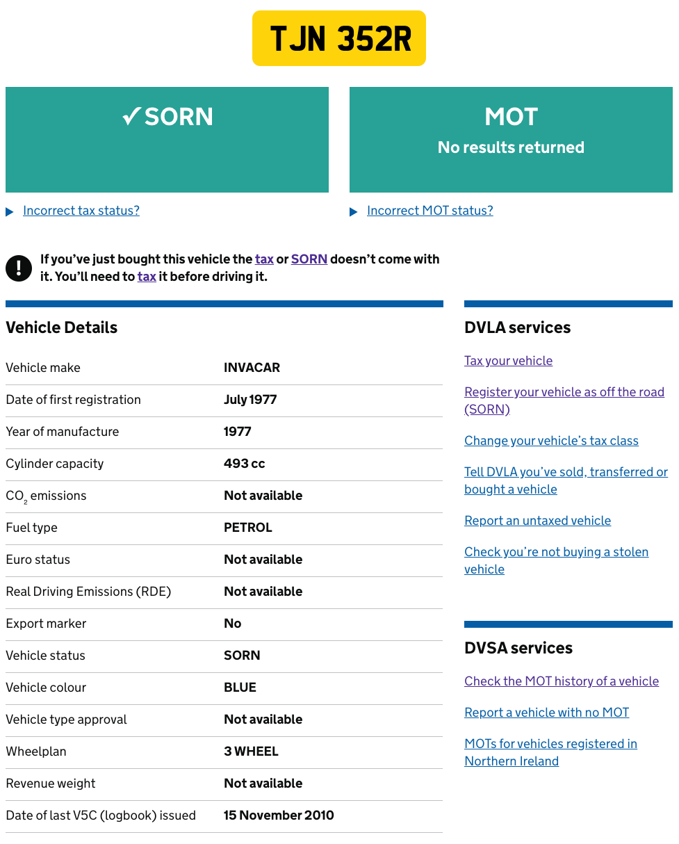

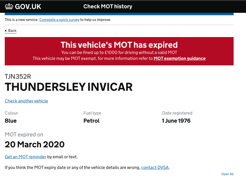

Ah thats because for that vehicle, the vehicle data in the MOT checker is from the DVSA not the DVLA
(if it has no MOT history then its from the DVLA normally)
I think at one point in time maybe they still can, but MOT checkers could enter their own info and it would display such MOT checker website
a good example is TJN352R, details are correct on the DVLA page
screencapture-vehicleenquiry-service-gov-uk-VehicleFound-2020-07-06-22_53_16.thumb.png.2c42eaf5d68f23234b64371083581556.png
but are all messed up on the MOT page LOL (interesting thing to note tho is it was already messed up even before its last MOT but it does not show any MOT history before the 2019 one...)
1216878328_Screenshot2020-07-06at22_54_05.thumb.png.b16a03db185c97d03bf9056e1c004f47.png
I would ignore the data from the MOT checker in this case

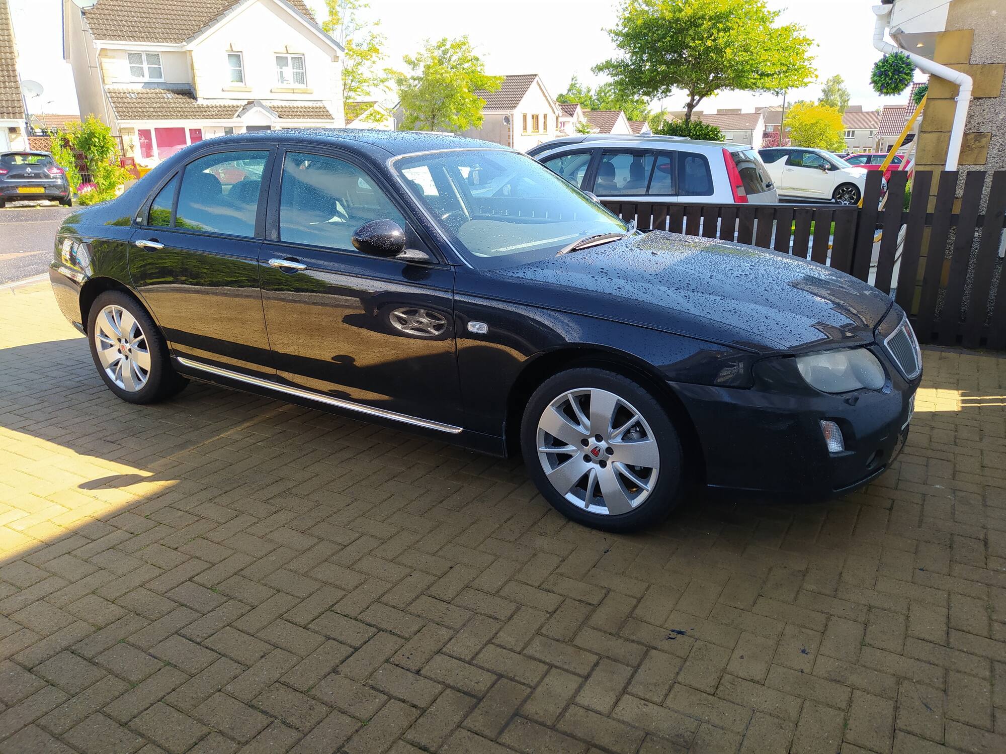

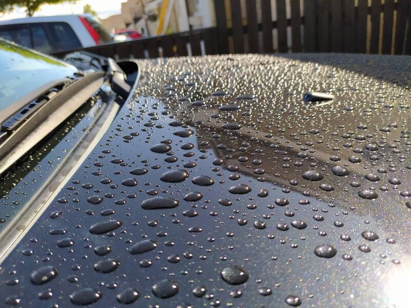

Waxed the 75 again yesterday and got some nice beading this morning during the showers.

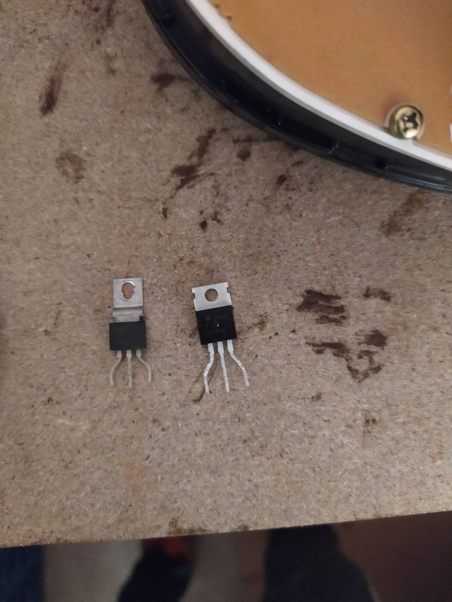

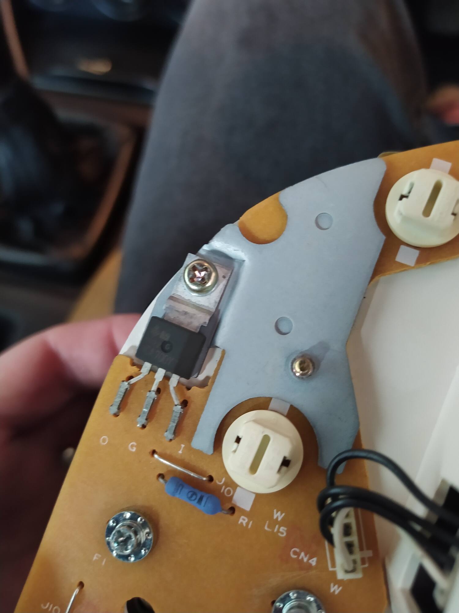

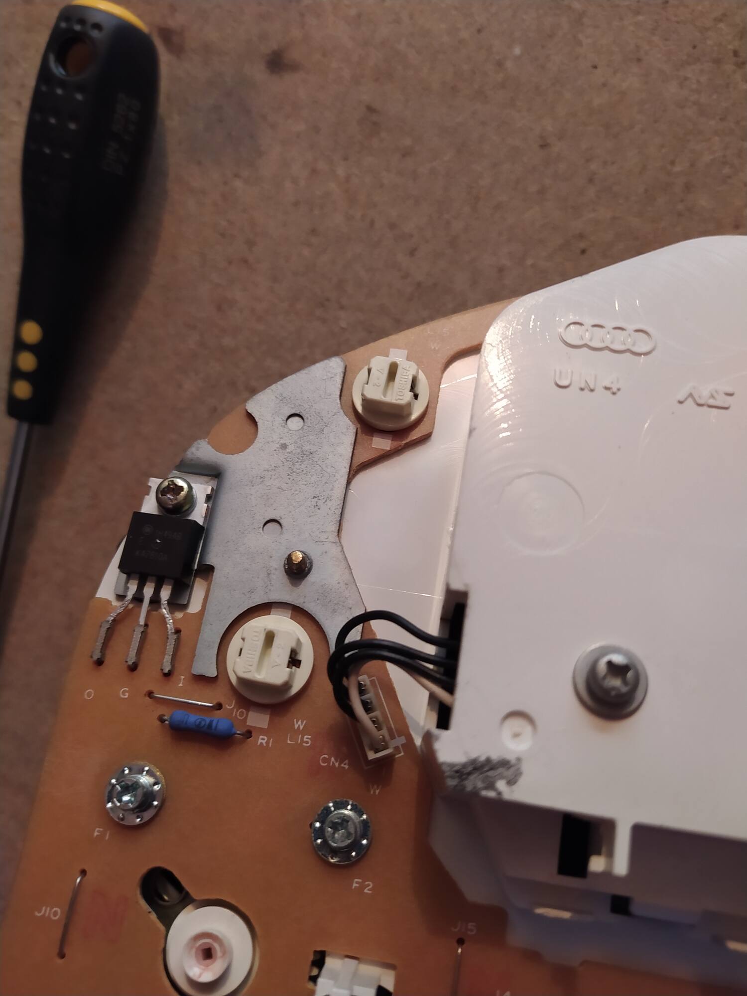

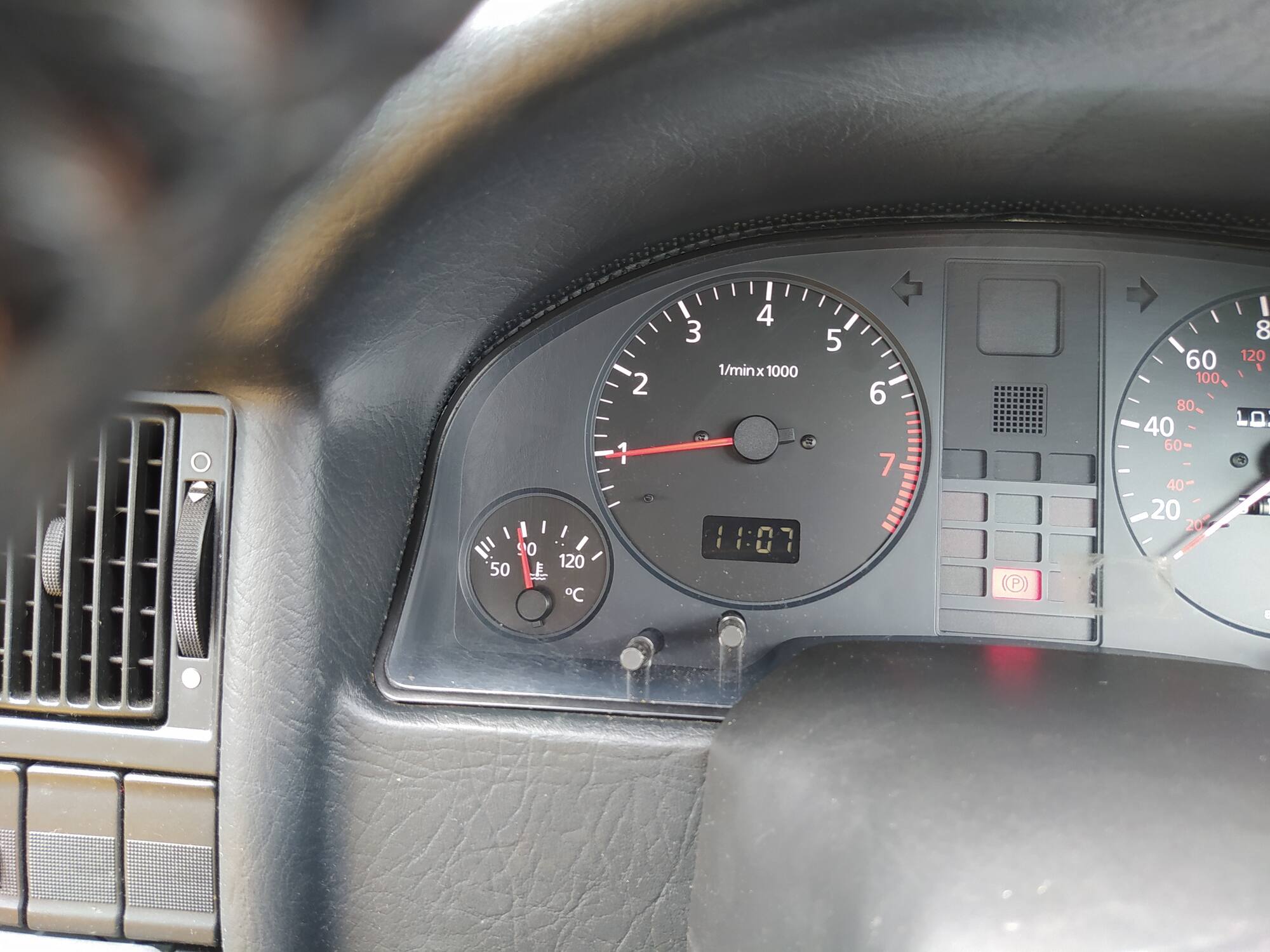

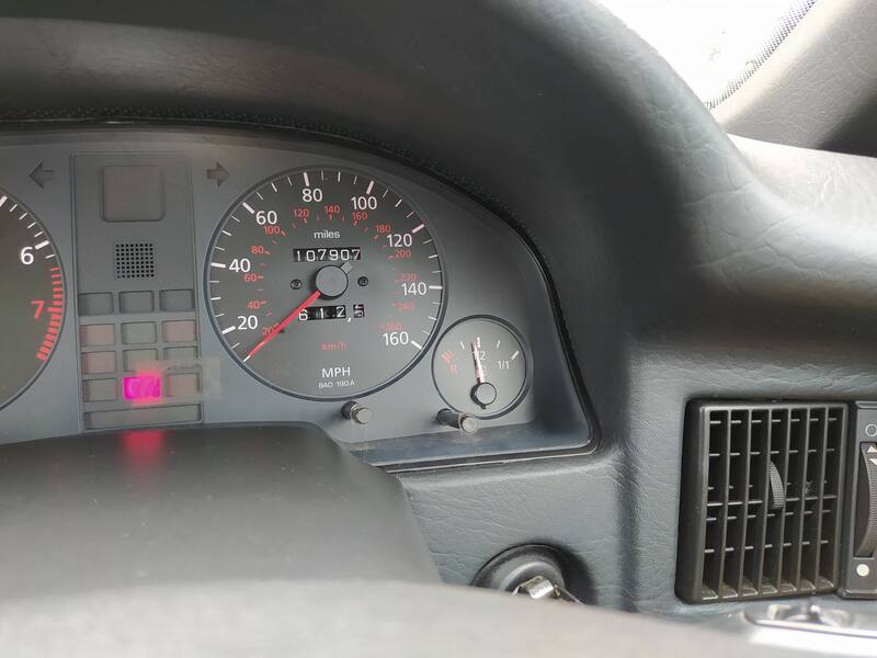

The Audi's fuel and temp gauges have always been correspondingly erratic and it's only taken me over a year after buying the new voltage regulator to get around to fixing it.
Instrument cluster out.
Here is the voltage regulator which controls the temp and fuel gauges and has gone a bit senile with age.
The one on the left of the picture is the standard one and the one on the right is rated at a much higher level of mA. Input and output are reversed but this was apparently the one I needed. I sound like I know what am talking about.
Some delicate bending of the pins was required but otherwise an easy fit in.
Back together and went for a drive. Now I have a working temperature guage and a hopefully realistic fuel guage!
If the input and output pins are reversed, why did you not fit it upside down? Won't be working properly otherwise and likely just letting the battery voltage straight through.
I guess the I/G/O markings on the PCB refer to Input/Ground/Output.
