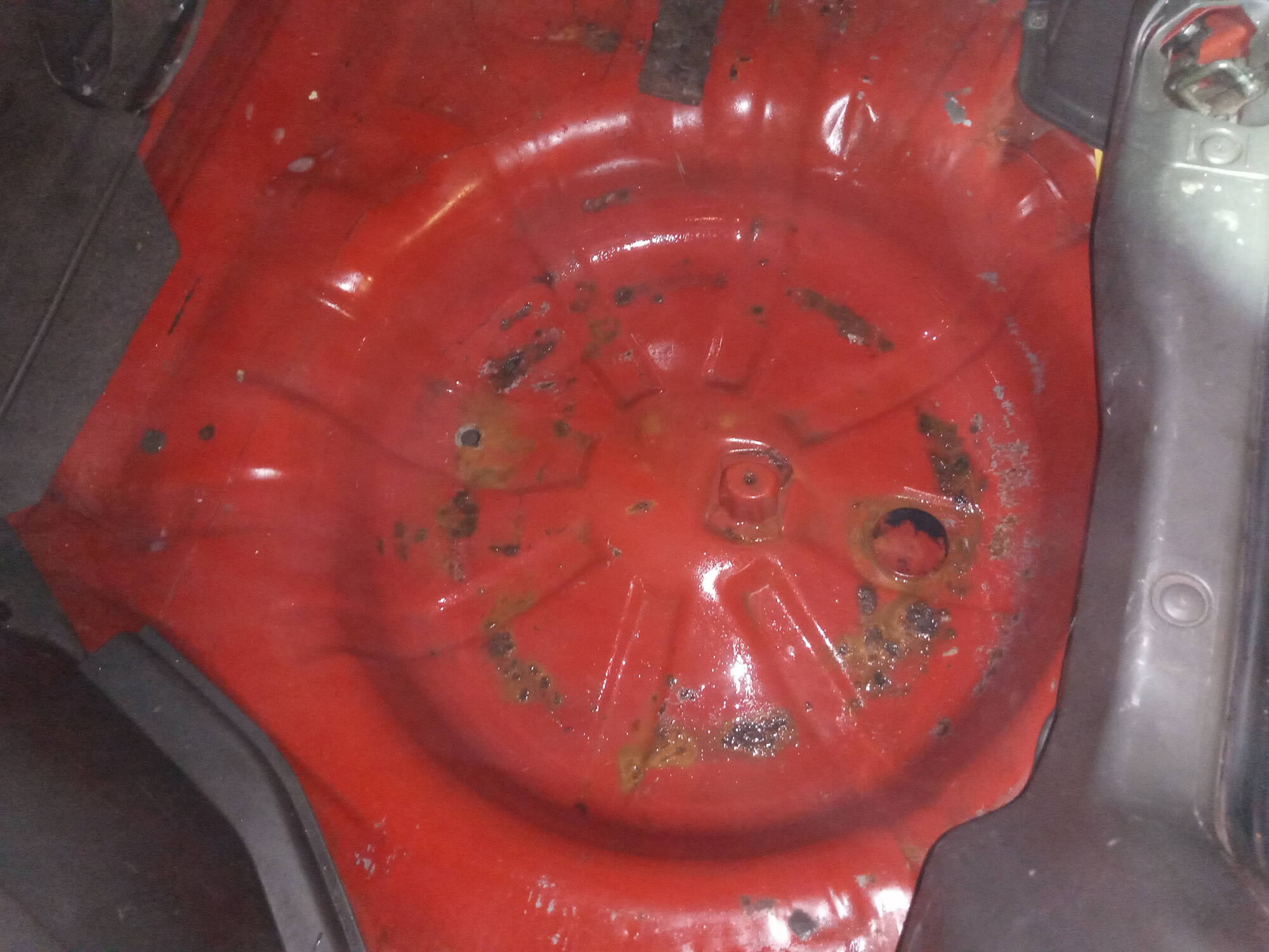

Decided to give the Bluebird some attention, discovered a damp spare wheel, traced to... Oh. Missing floor bung and an extra hole. And a spare wheel covered in rust.
Cleaned up for now, wheel wirebrushed and kurusted, need to sort the boot floor out properly at some point. Sprayed the well with WD40 temporarily.

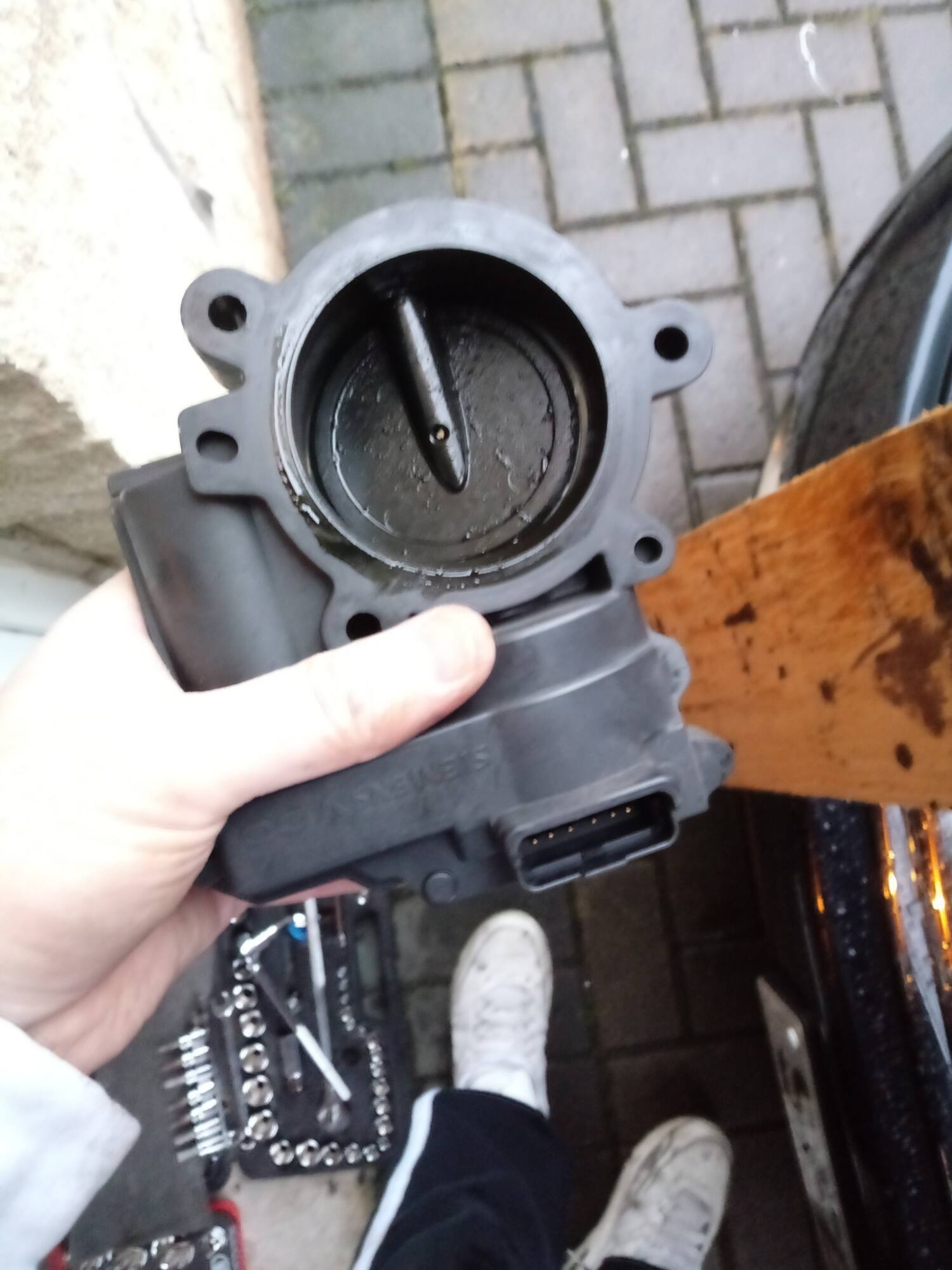

More messing about with the Mini today. It kept wanting to stall when the revs were allowed to return to idle Although it would always recover before it cut out manoevering was a pain in the arse because the issue made it too easy to stall without riding the clutch a lot.
Unhelpfully, it doesn't have a separate Idle Control Valve, everything is integral to the throttle body so all I could do was clean it up.

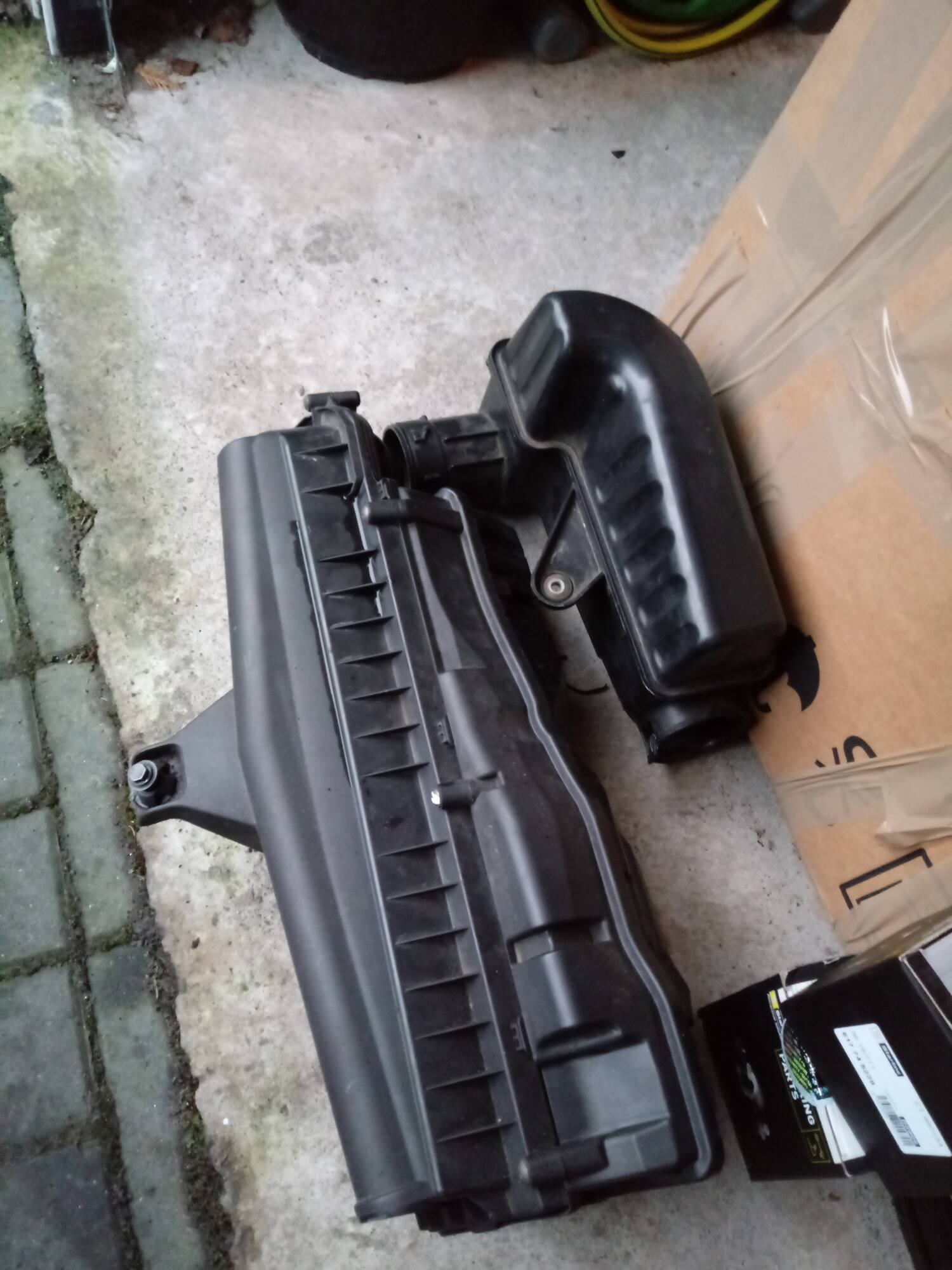

Quite a bit of trunking had to be removed. The smaller box is some sort of resonator.

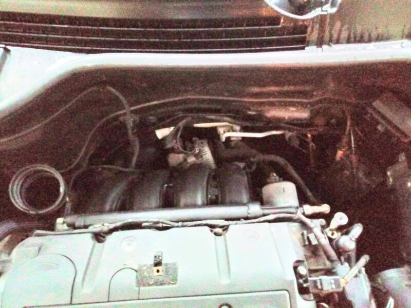

Theres a surprisingly large about of room round the back of the engine with all of that removed. Throttle body sits under the bog pipe on the left.
The butterfly area was fairly clean however I gave it a few passes of brake cleaner anyway.
I accidentally stripped the thread of the tiny bolt holding on that useless resonator box (it's before the main air cleaner) so it's now cable tied in. Might replace it with plain pupe if I can be bothered.
The fall to idle seems much smoother now.
Cars haven't had Idle Control Valves for years. Pretty much everything that is a fly-by-wire throttle body doesn't have one.
Does the car have a clutch switch?  I know some cars have it not just for cruise but also to tell the ECU that there is a substantial load decrease coming because the clutch pedal is down. Then not to overreact from loosing that load.

Indeed, only my Corsa left on the fleet which has one as it's cable throttle.
No idea on the clutch switch but good shout, I'll check that, cheers.
