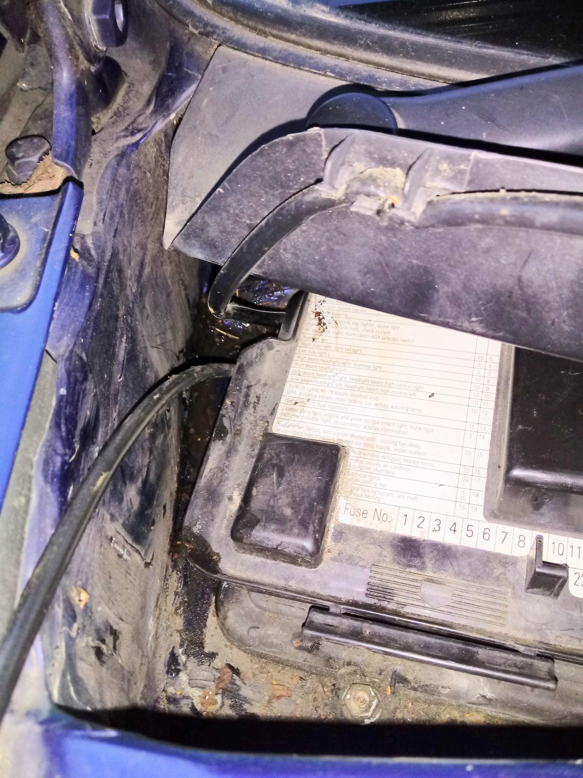

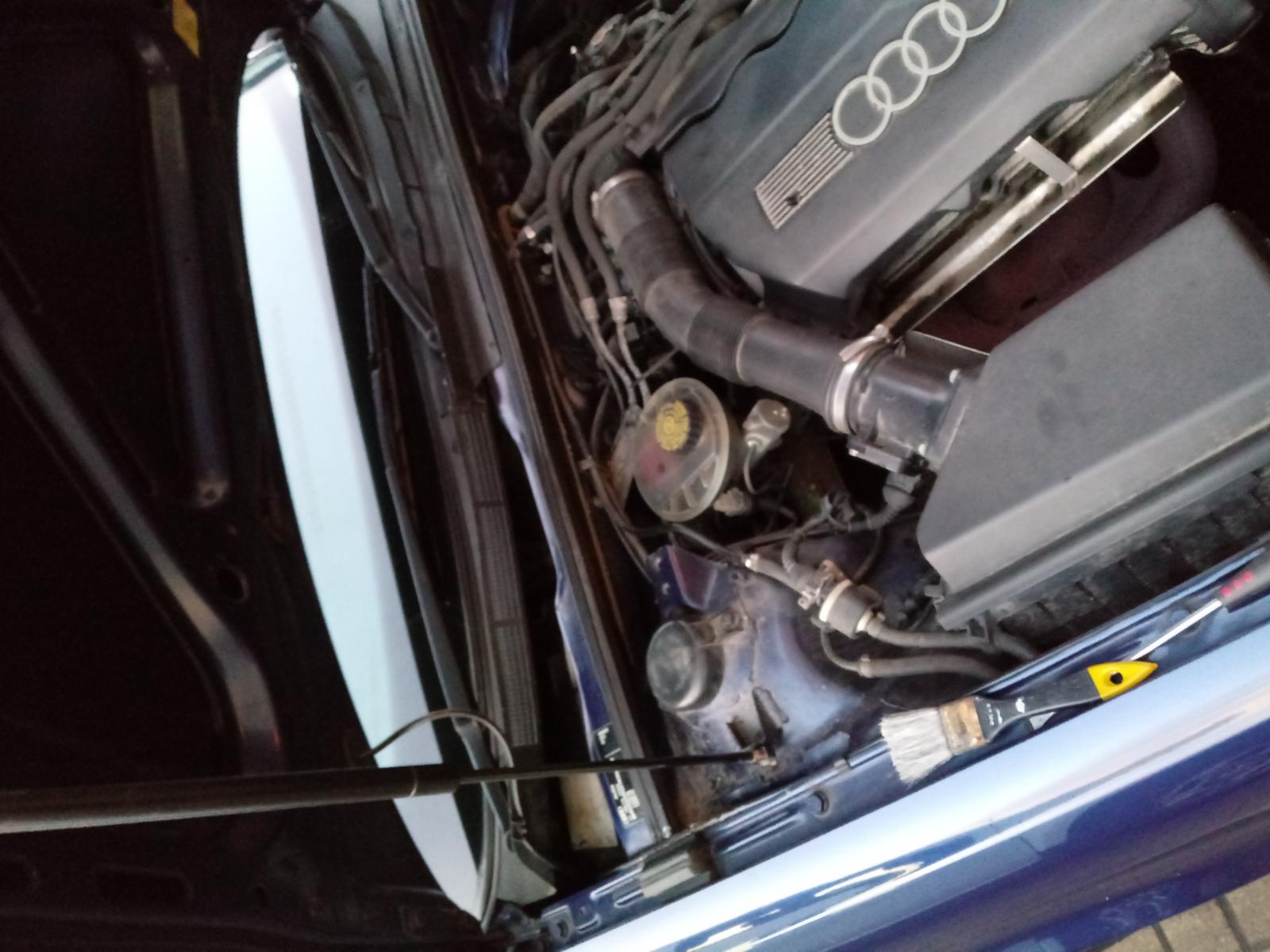

After looking at the Audi's scuttle with dome at Scotoshite last night, it appeared that a possible cause of the wet driver's footwell is that the plastic scuttle drain panel is missing, and that the underlying bulkhead drains are clogged with leaves and shite.
The bonnet release cable passes through the bulkhead right here via a grommet. There are also 2 drains near here, one immediately to the left of the grommet on the side panel and a bigger one in front. The former was completely blocked and I think that water was pooling here and seeping through the bonnet release.
The fusebox lid was also loose and I'm amazed that it hadnt got wet. I reattached it properly.
I now need a scuttle panel as it has a duct that channels rainwater directly towards the drains underneath. That is not going to be easy.
Check out the shite that came out, this is just some of it. I did both sides.
Will just keepiy t clear of shit be good enough without getting the uncommon part?

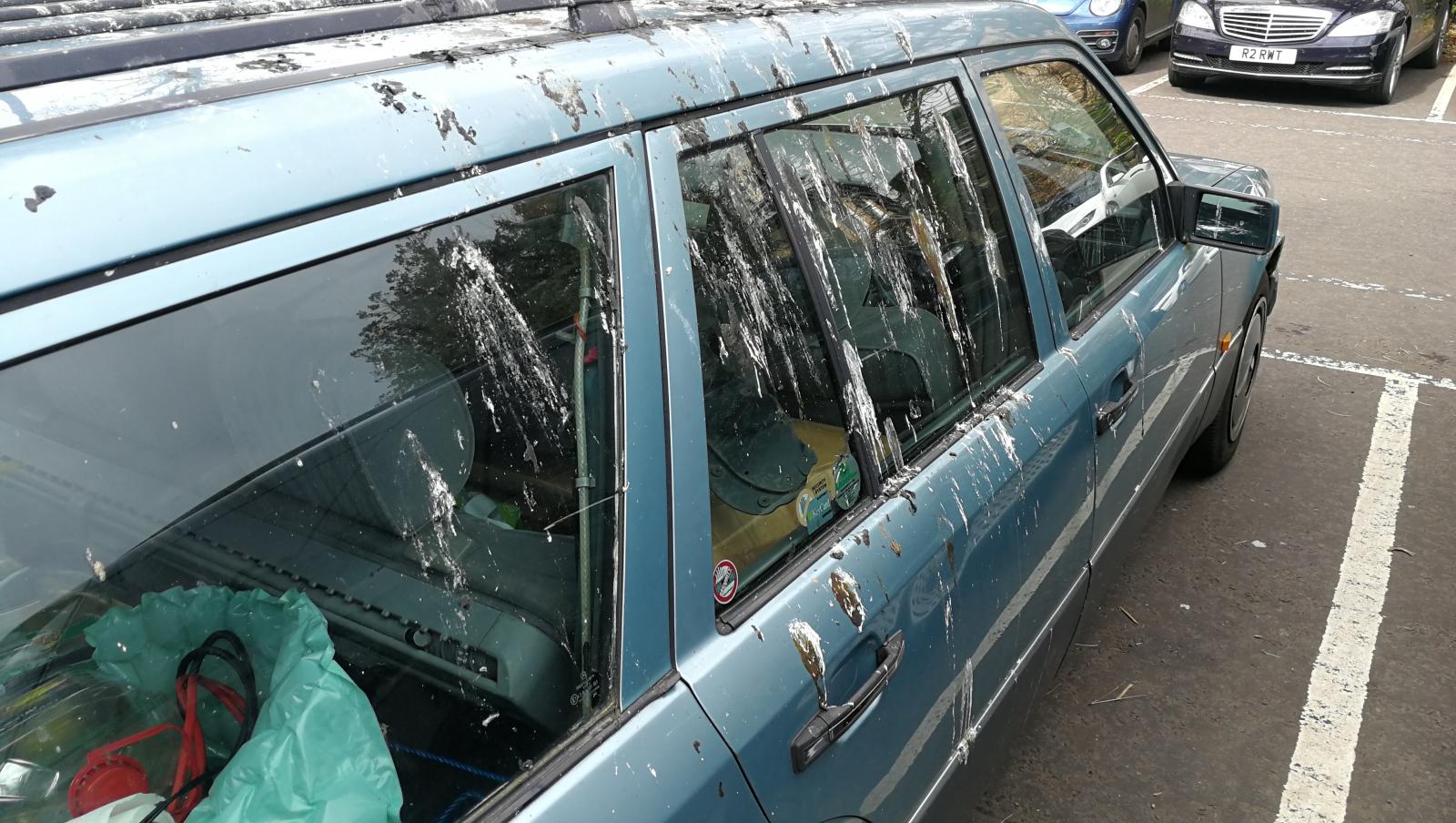

Reckon it's time for a wash?
Caught a couple of lads taking pics from their van..
What are you parking that under, a pterodactyl nest?
Yes I know the theory is that pterodactyls were ground nesting, I'm using them for comic effect, get off my case dinosaur scientists!
Turns out that the scuttle panel is intentionally missing, leaving the fusebox poorly protected. Great* design Audi.

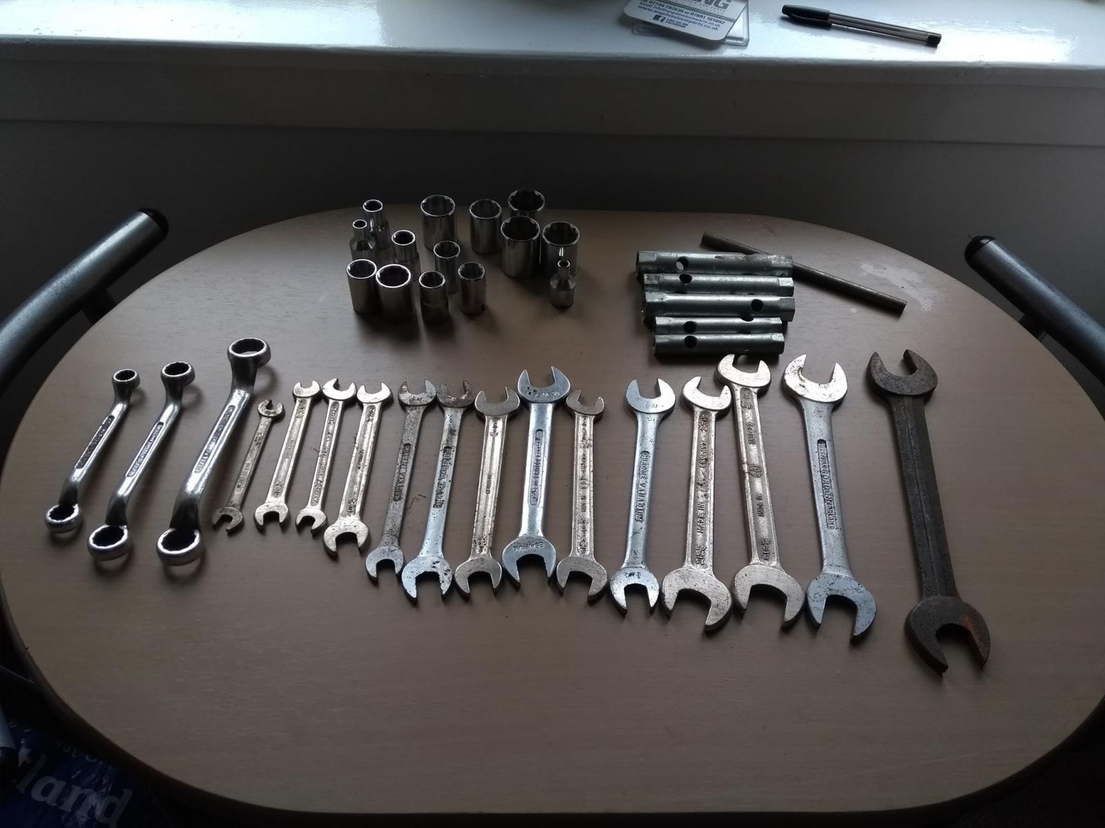

Big thanks to the fine Mr Touring for dropping off some tools for me, for which I must thank big_al_granvia for graciously donating to me. As I am a serial user of Ye Olde Motors using Ye Olde Measurements they will be indispensable. Sadly I couldn't collect them in person at the Scotoshite meet On Wednesday as I was stuck at work, so the esteemed Mr Touring arranged to meet for luncheon and a chat in Bearsden today where the aged vehicular dismantling aids could be transferred.

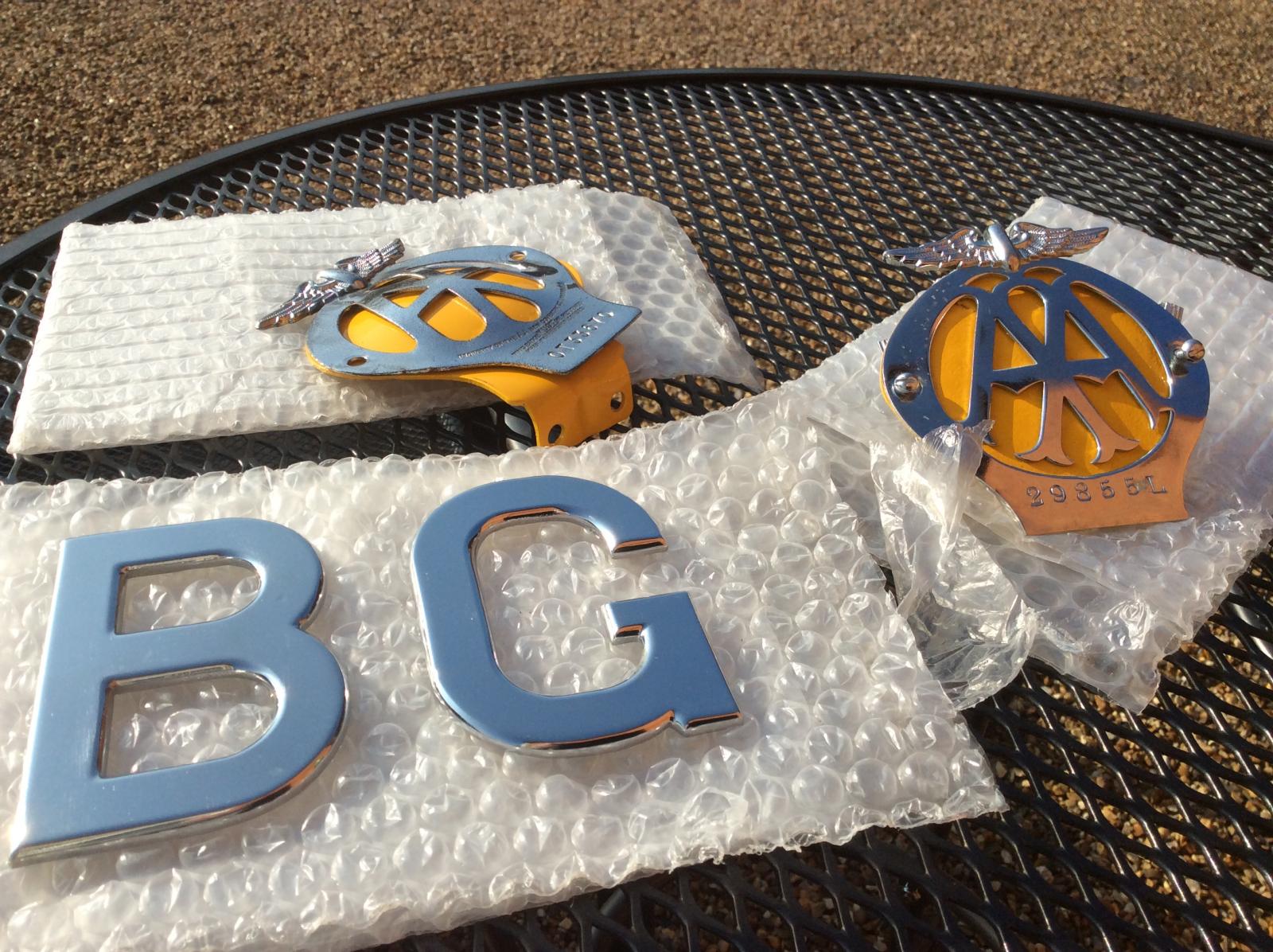

Dare you to attach the badges to the car as BG instead of GB.
