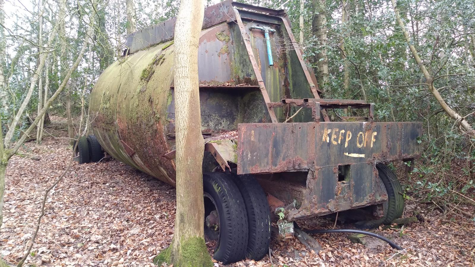

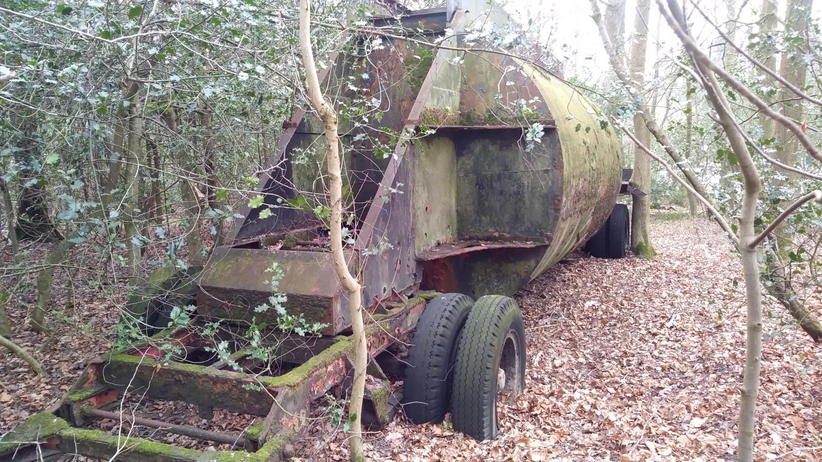

I’m convinced it was a green Cortina now I’ve been looking after the above pic was posted.

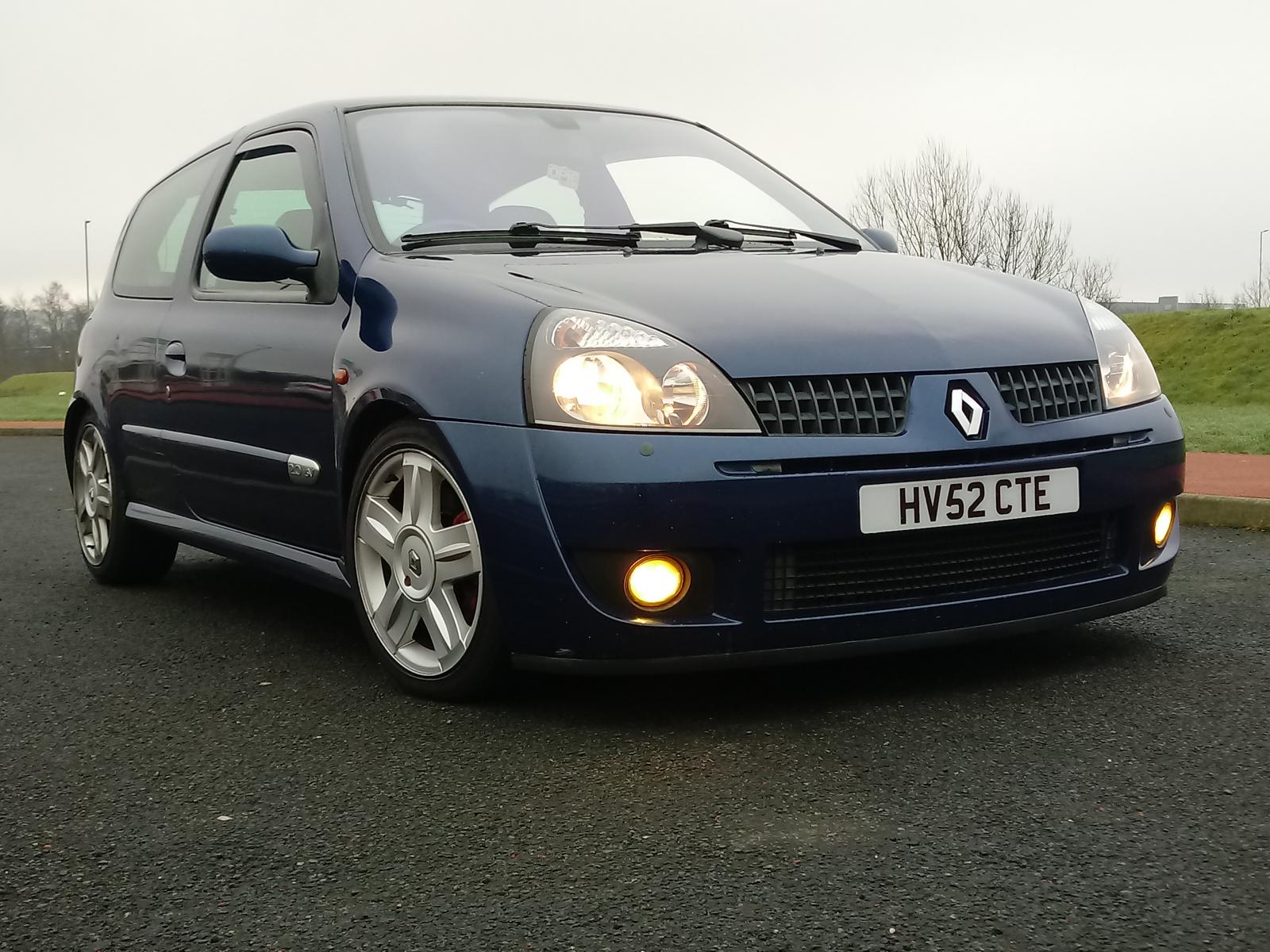

Took this out for a blast, kicked its arse but when I went back to it a few hours later it was misfiring like fuck and flashing the EML.
Going out to it tonight to plug it in, consensus is injectors.

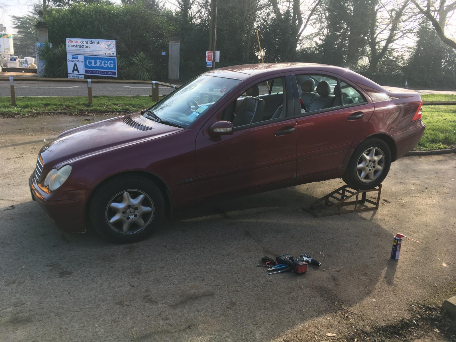

So I was working yesterday, which has the benefit of there being a fair bit of downtime.  Sunny day, so out with the ramps and determination to find that annoying wee rattle I hear now and again.
Found a fair few missing bolts on undertrays, and worn-through heat shield washers etc.  Piecemeal stuff, so sorted them out and got it all tightened up.  Noticed that it had had recent new brake lines, but they'd left the old ones in there too.  Stupidly didn't think anything of this.  Nothing too hairy looking underneath otherwise.
All done, took it for a drive.  Rattle still there.  Dawns on me that it's the old brake lines jangling about.  Duh.  So back to base and repeat previous process but with added brakeline removal/cable tie action.
Except I didn't get that far.
Blokie from work comes over to see what's happening - just as I have the boot open to get tools back out.  I get distracted talking.  He suggests tea.  I shut the boot.  ONLY KEY FOR CAR IS IN BOOT.  Which is now locked.  Along with rest of car.
I should add that I had a hotel booked for last night - in Bradford, for the family.
Fuck.
Straight to youtube for help.
Hear car alarm - blokie has tried the doors and gotten the back door open.  I'd forgotten about the dodgy actuator on it.  Not a result though - no access to boot from back seat.
Took number plate off and plastic trim behind, unscrewed boot handle and tried to reach in to force the cable by hand.  No dice.
Back to youtube.  PANIC LEVELS RISING.
Found excellent fix.  Negative off battery, wait 60 secs or so, re-connect, press lock\unlock button on centre console.  Boot springs open.  Fucking win.
Key reclaimed, Panic levels lowered.
Boot lock now only works when you pull it repeatedly for a while.  I think I stretched the cable on it trying to gain access.
Bollocks.
Gonna have to strip it down and investigate.  Which is not gonna be straightforward I reckon, and could make it worse/non-functional.
