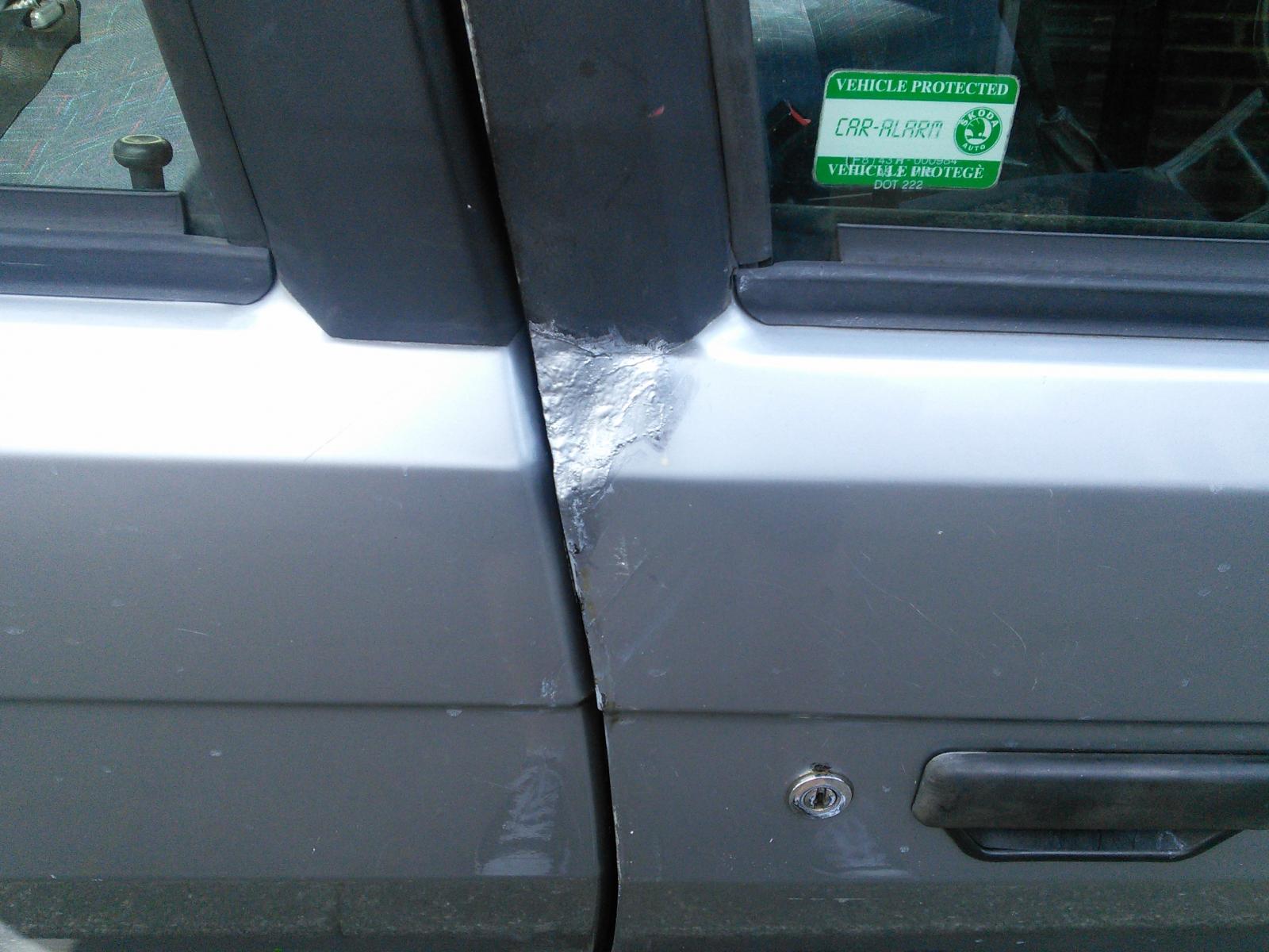

into this, with an expert* repair

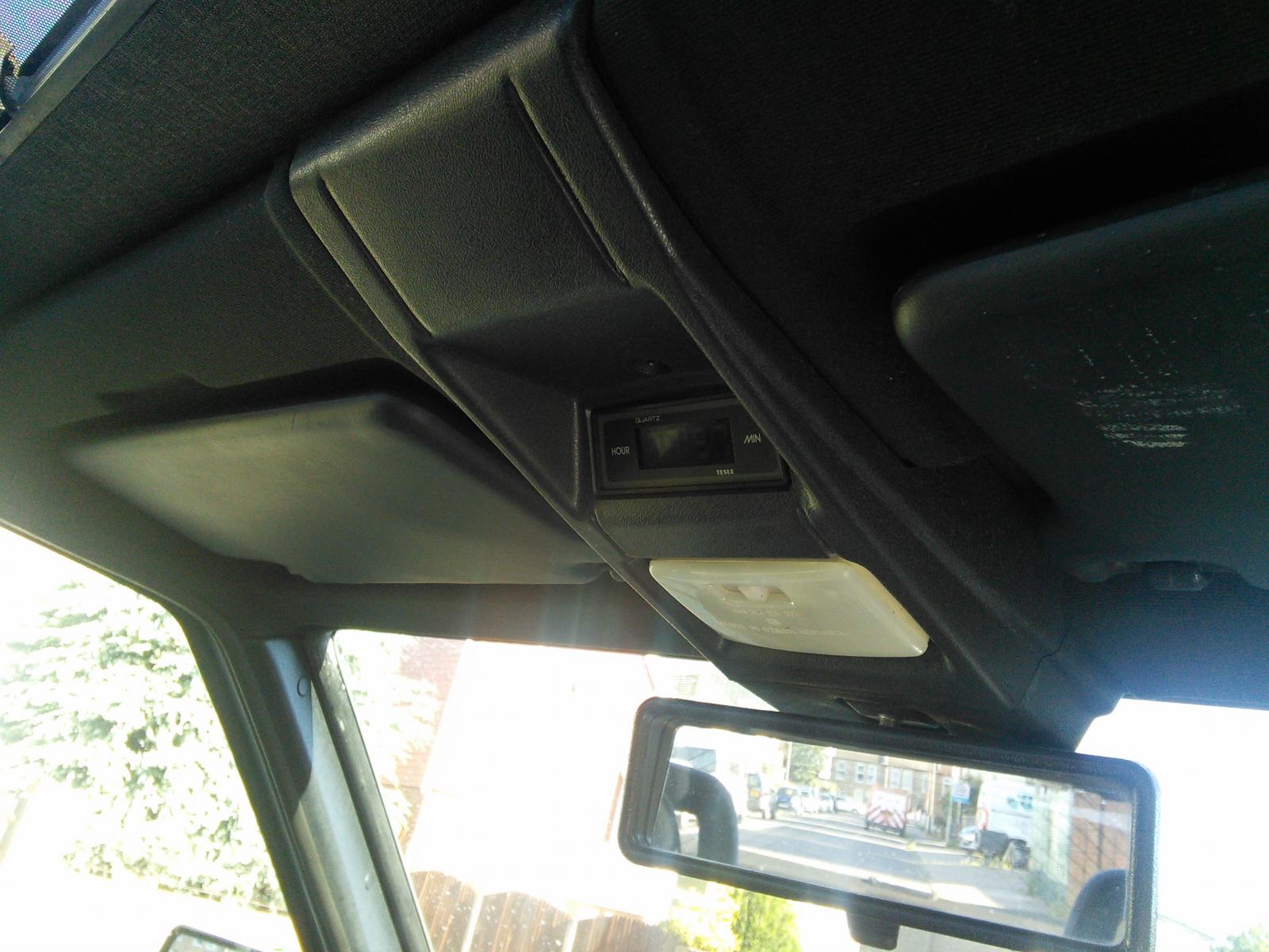

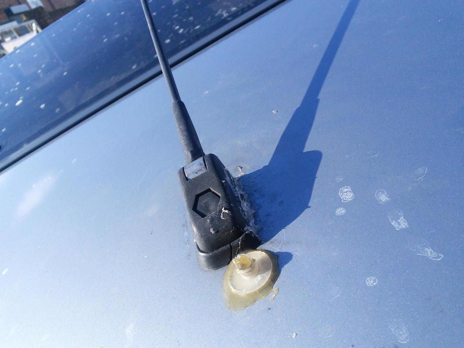

I wanted to remove the leaking aerial, because it leaks directly on to the light below (base broken), and it has been sealed one too many times.

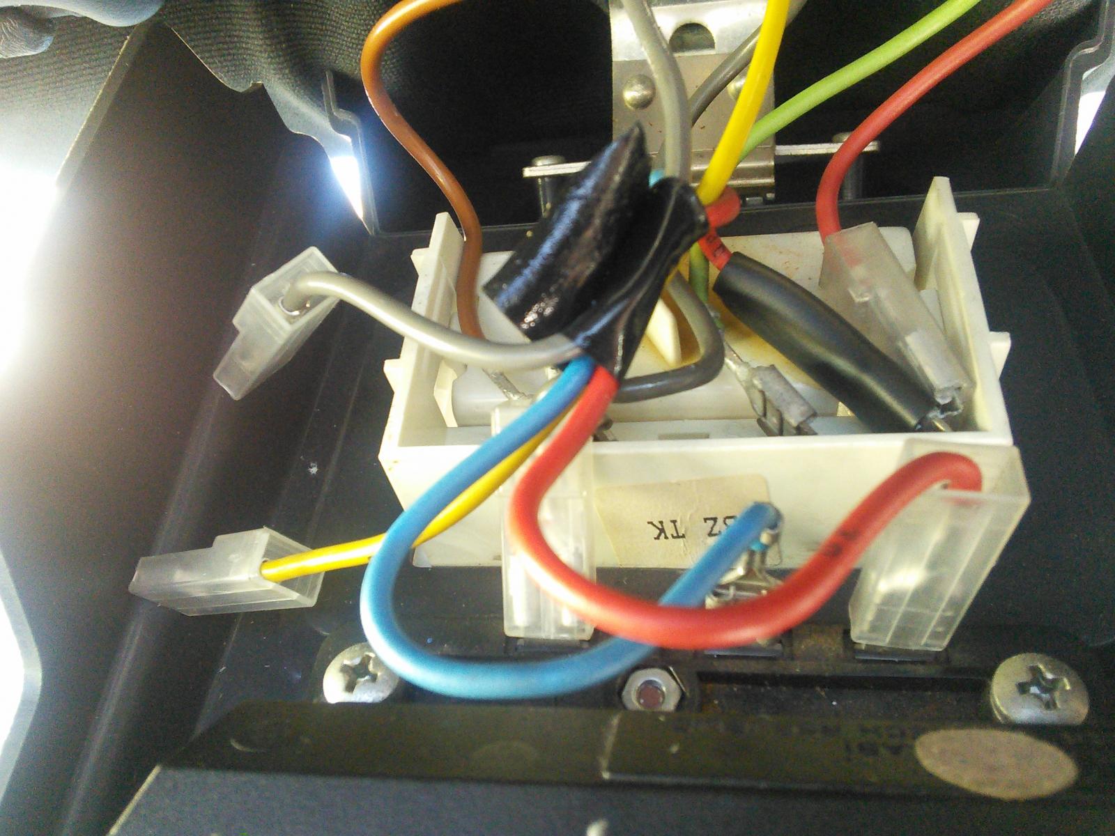

I dropped the light down and found two random loose wires (but light and clock are wired in correctly!) because Skoda?
I couldn't get any purchase on the 10mm aerial nut inside, which means I'll have to remove the whole sun visor luxury* spec bit, which will be a job for another day!

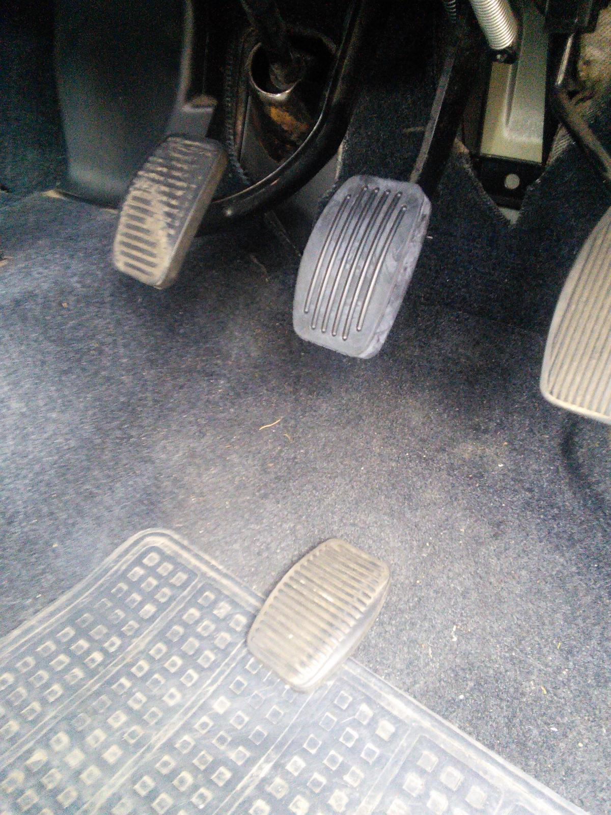

So I got my job satisfaction from changing the brake pedal cover, lol.

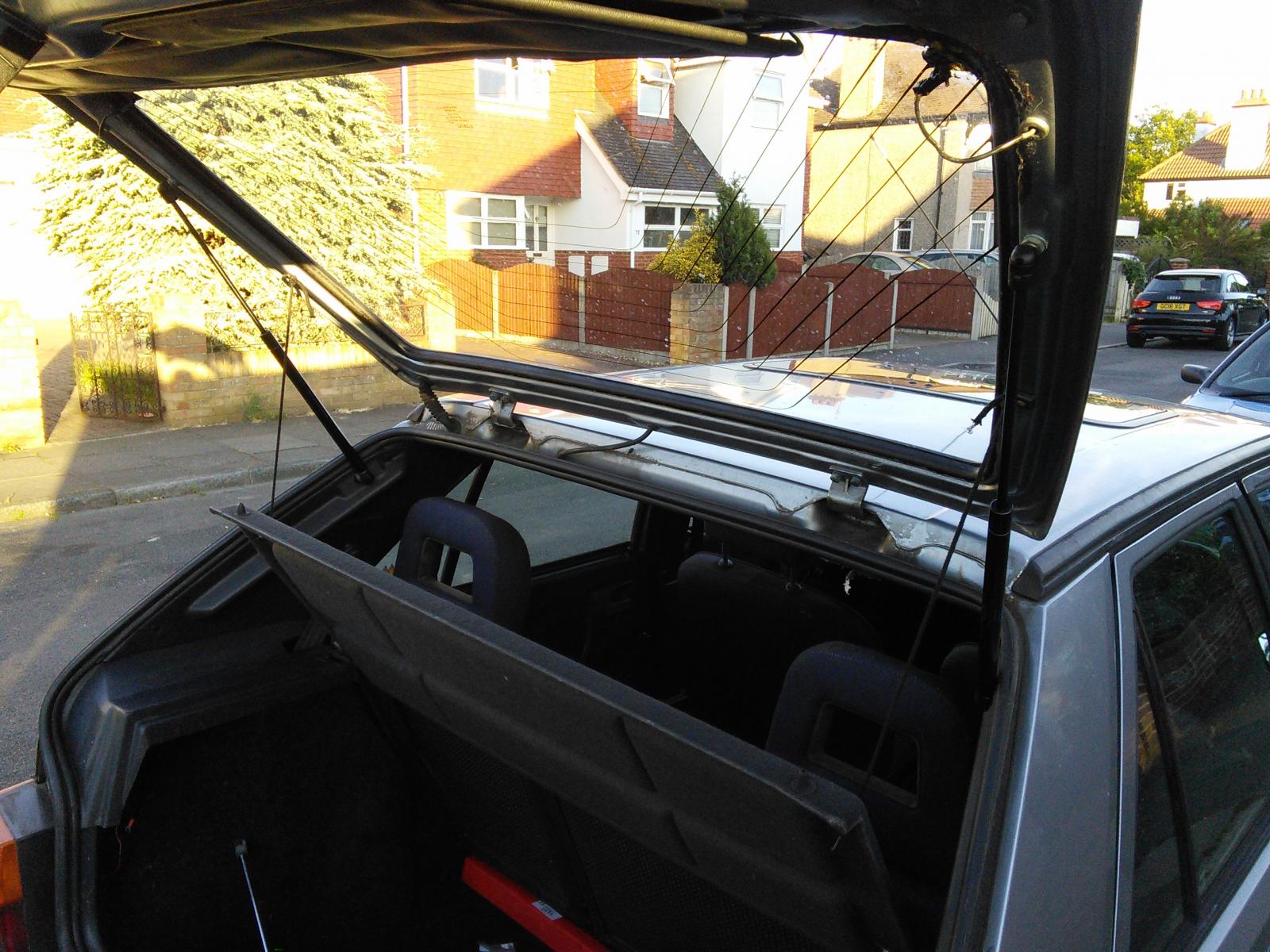

Ok, one more job, swapped the Felly tailgate lifts that either theshadow or Walter White added for new Chinese ones. Reduction in decapitation chance by around 35%
